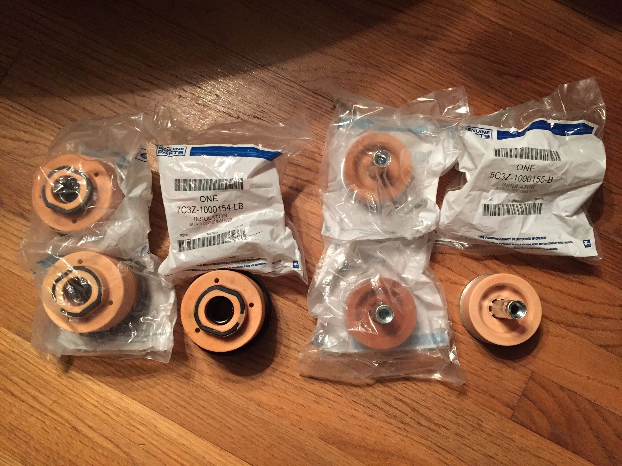

Here are the oem sets, comes with all new hardware as well. They are expensive no doubt but for an item like this it was worth it to me.
Here are the oem part #'s for future searchers. There is an upper and lower for each.
The two behind the rear seat, and the two below the area by your feet in front are:
TOP: 7C3Z-1000154-LB
BOTTOM: 5C3Z-1000155-B
The two in the center of the cab are:
TOP: 2C3Z-1000154-KA
BOTTOM: 2C3Z-1000155-GA

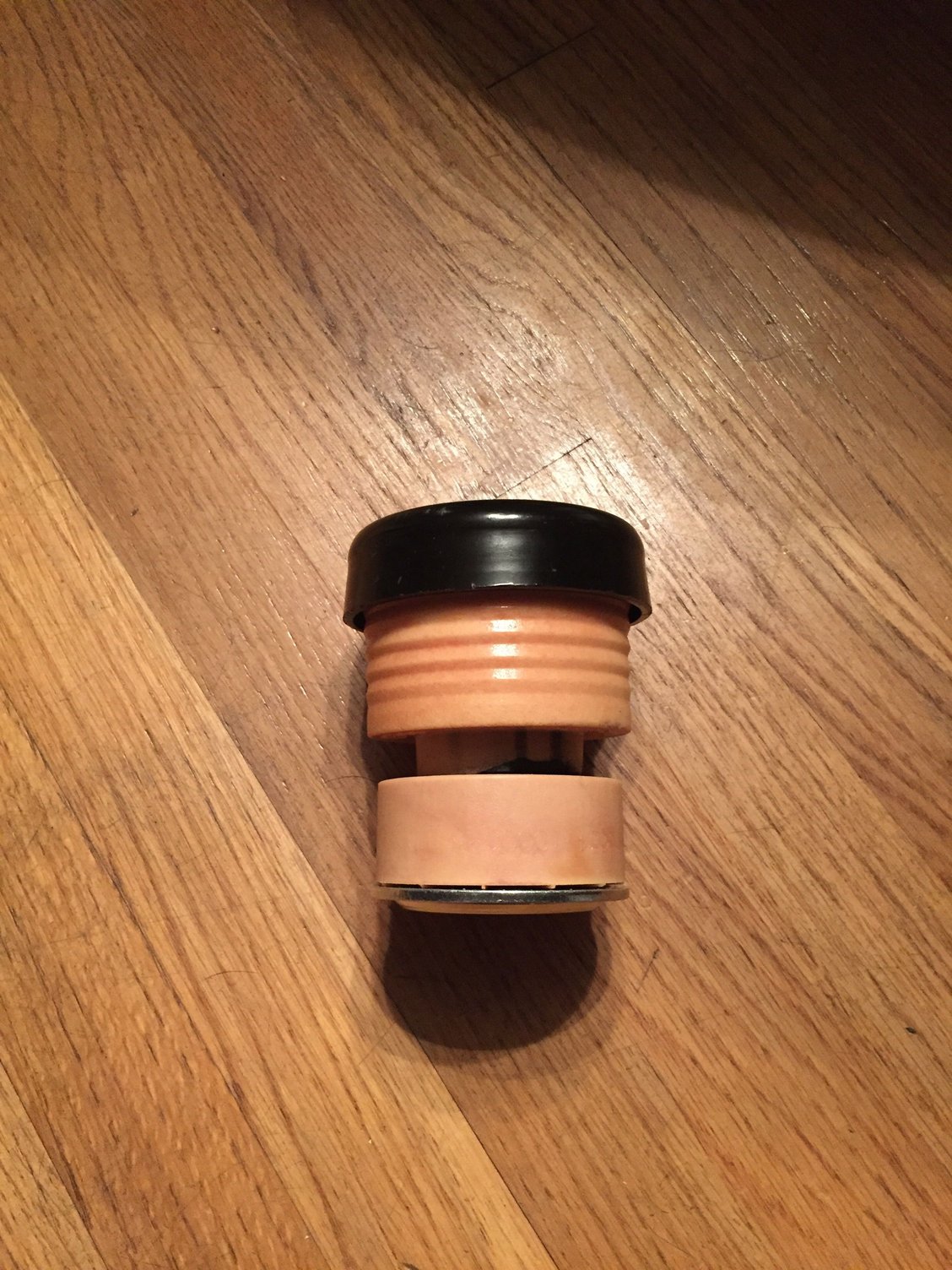

How it sits when on your truck
