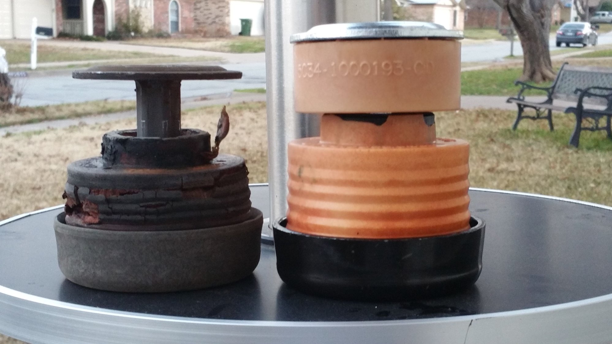

Replaced my 2 at the rear of the cab today, they seem to be the only bad ones. I may do the others later on just to smooth it out.
Old vs New
Old Feb 2, 2016 | 06:57 AM
fordboy2's Avatar
fordboy2
Joined: Dec 2005
Posts: 2,296
Likes: 11
From: freeland, mi
Just a bit of a difference! Lol
Old vs New
Wow those look just like mine, I can't believe how tall the oem ones actually are! Was it a hard job? I still haven't done mine yet. Just got running boards, a s&b intake, and I'm having the drivers seat recovered. Body mounts will be next. I may be shooting you a pm to ask how you went about doing it if that's ok.

Originally Posted by Dr.Huxtable
Awesome thanks for the help!!
Wow those look just like mine, I can't believe how tall the oem ones actually are! Was it a hard job? I still haven't done mine yet. Just got running boards, a s&b intake, and I'm having the drivers seat recovered. Body mounts will be next. I may be shooting you a pm to ask how you went about doing it if that's ok. ^
It wasn't hard, just getting the body up far enough to get the new one's in without a proper lift was the hard part. I didn't loosen all the mounts but used a 4X4 and a car jack, I was just barely able to get the spacing I needed to get the new one in.
