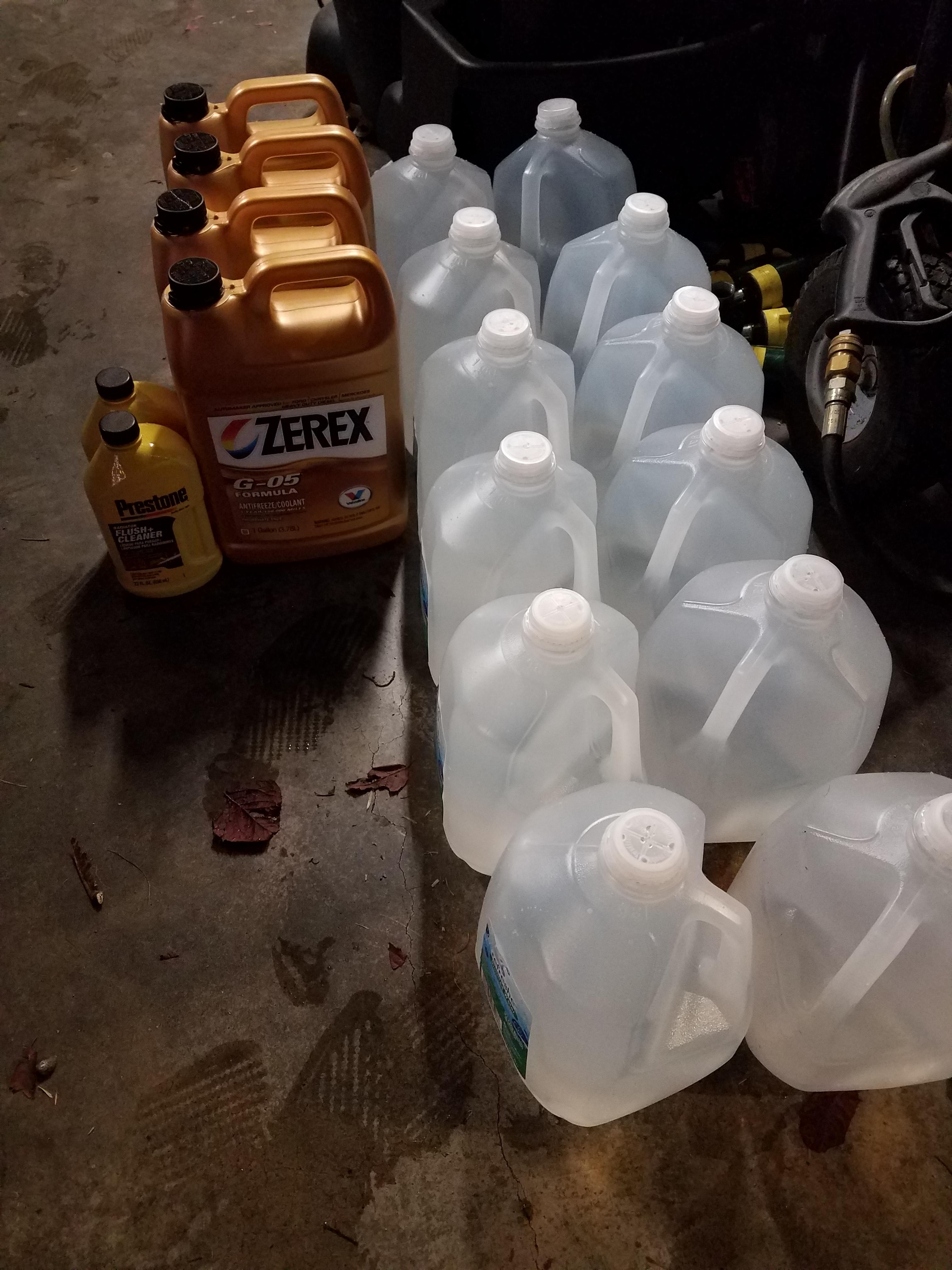

Well after all that Ford Gold drama (sarcasm) I ended up going with Zerex G-05 simply because I had time on the way home from work to stop by a few places for errands and neither O-Reilly's nor Auto Zone had Ford Gold, so Zerex seemed like the next fun thing to try out.
Grabbed 12 gallons of distilled water at Albertson's. Bentley, I planned on going to WinCo but I made three stops in the same parking lot of Albertsons and the water was $1 a gallon.
I also grabbed two bottles of Prestone Flush & Cleaner to run through the first two cycles of the three I plan on doing. pgg0, I still remember your Walmart suggestion and I will see if that ends up being a place we can swing by. If not, I'll have something different to report. Hooray for more data! LOL
I'm going to grab a few empty multi-gallon containers of whatever sort I happen to come across while running a few more errands with the wife tonight.
I hope to knock the flush out tomorrow afternoon. We shall see if time permits, but I didn't realize I had the day off until this morning, so I don't have anything else planned since I was planning on being at work LOL.

Attachment 288358

Looks like you have some cocktails to mix up there.
How does the truck take it drink Shaken And Not Stirred like James Bond?
The bit issue with the Ford Gold is the silicates that drop out if the coolant
is heater too much beyond normal. With the 6.0L the effect sort of snowballs.
The oil cooler has find passages for the coolant and from there it feeds into the
EGR cooler. As the oil cooler plugs up the flow through starts to drop and the
coolant in the EGR cooler takes too much heat and starts dropping out the
silicates that in turn go back through the system only to plug the oil cooler even
more with each pass. That is one of the issues of the 6.0L failures. There is also
one other place that the stuff can build up and that is the top of the radiator.
A few have found out that if the radiator is not taken out and really cleaned they
are putting a new set of coolers in it very soon again.
