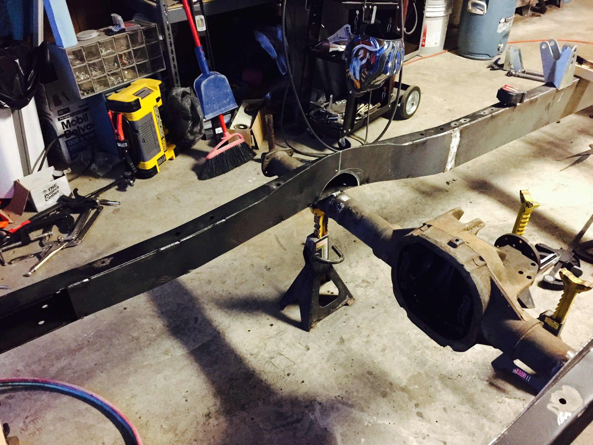

Some weekend work I was able to get to. I got the insides of the rear section of frame boxed in and the axle notches outlined. I still have to make the rest of the frame fit that shape but wanted to weld the axle to the existing frame for the 4 link mock up.
I got the lower 4 link bars tacked in. The triangulated bars were another story. Since I have the offset center explorer axle, the mounts with the kit don't really work all that well. So instead of going from the pig outward to the frame I am going to go from the axle inward to a center bar. I have to go purchase that this week so I can create new front mounts and get all that tacked in. Other than that I feel good about the progress in the handful of hours I actually worked on it.
