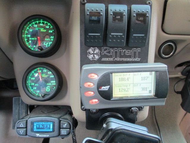

Originally Posted by Nicmike
And mine is in! Only took me 3 days...
Can't see the cable for the Hydra anymore.
Any problems reading the gauges? Is the angle to "flat"? Would the view benefit from the angle rings to give them a slight upward angle in your opinion? I just got my part from white bear and I am in the process of ordering everything. Thanks for your help.
I can read all the gauges well enough, BUT I would put the angled bevels in there if I had to do it over again. I get a lot of comments on it when people ride with me, and when my kids friends ride along they think it is just awesome to have all those gauges in the dash. Cool factor is high, and I get the info I need when the truck is going down the road

Thanks, I was leaning that way. Kinda hard to tell from the pics. Soon I will have the cool factor as well! I sold my edge tuner that I was using for temps and stuff...and now I feel naked when I'm driving around.

I added another gauge to mine in lieu of all the alternator problems I have had the past 3 years.
VOLTAGE!!!
No more gadgets hanging out of my cigarette lighter...

From: Loveland,CO
Haha, that's the same gauge I have...in the same spot to!!
