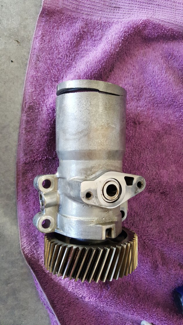

Wow! Theres some serious carnage going on inside that pump. Never seen that before.

I'm going to start at the ipr tomorrow. It was clean when I put it in, I even cleaned it out by using a bolt like Ron does on the videos to push the valve open and nothing came out. The original screen was not broken just "cupped" a little if that makes sense. When the ipr valve comes out I'll do the 12v test and see if it is functioning.. if it is, we are going right back to the hpop... arrrgh.. this will he the third time taking the turbo off in 2 days.. getting good at it.. hahaha.. Mark did you see the picture of the hpop? I'm trying to figure out how in the heck the back split like that.. From what I've read on forums it the icp pressure is around 200 psi more than likely it's a bad ipr.. the ipr valve, icp sensor and injectors are all original, 201,000 miles. I didn't do the stand pipes or dummy plugs, I'll do them when the injectors get replaced.. I just don't see them causing this issue right now. I have never had a hot no start issue.
