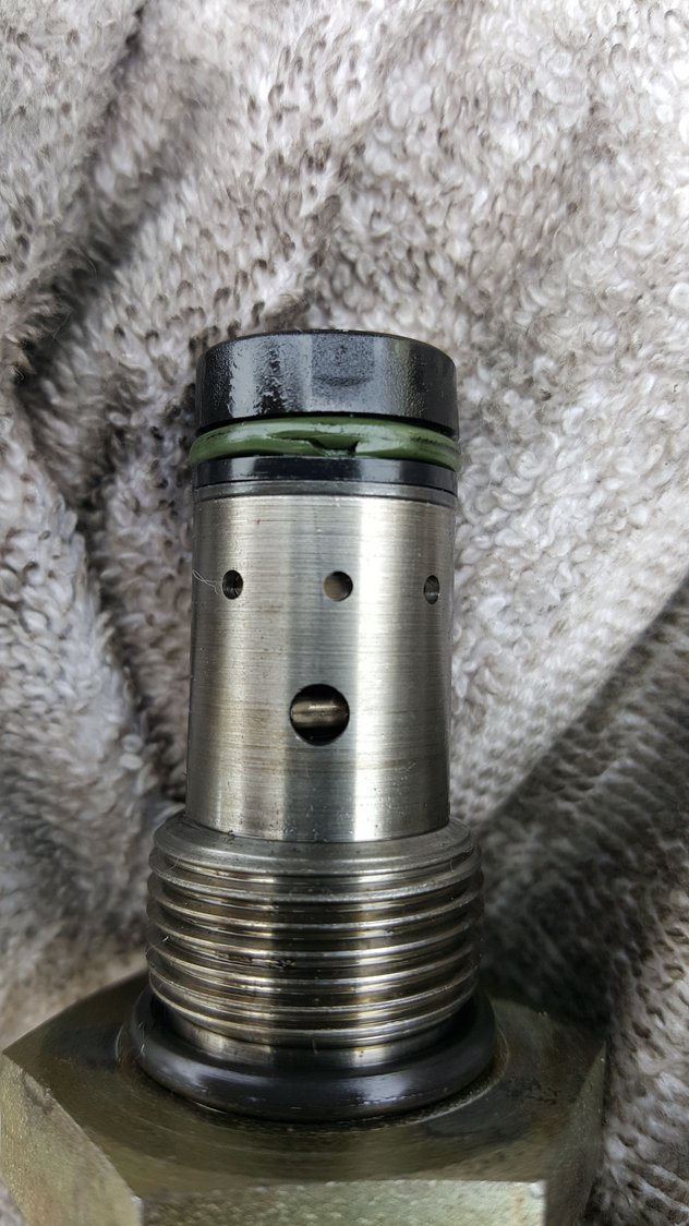

Ok, before I dig any further into this motor do you think this o-ring on the IPR Valve could cause the loss of HPOP Pressure? Also if I need to remove the HPOP is there a way to do it without removing the egr cooler? Another thing, the screen was perfect no tears or debris.

It might. When (and how) do you think it might have been damaged?
IPR seal kit (o-rings) 3C3Z-9H529-A

The IPR valve didn't take hardly any pressure to loosen it.. i wonder if it wasn't tight enough.. the screen wasn't attached to the end very well, when it was pulled out it fell off.. when I put it back on it snapped in place. Does the intake manifold and egr cover have to be removed to pull the oil pump out?

Thank you Mark for all your help. I ordered the IPR o-ring kit with the better screen. I'm going to replace the o-ring and put it back together. If the o-ring isn't the culprit I'll dig back into it... now I know how to get that far into the motor it won't take long.. lol. I cleaned the turbo this afternoon, it was cleaned over 100,000 miles ago by the dealer. When I got it apart the vanes all moved freely!!! The unison ring came right off. There was a light coating of soot on everything... basically I cleaned it with a rag. The impeller had no play in it, the truck has 201,000 miles on it. Since I won't be able to fix it until next weekend I am sending the FICM to Ed for the Atlas 40 tune.

Update. So... I replaced the broken o-ring on the IPR Valve, put it all back together and still the same results. Well actually I think the PSI went up to 249 for a few seconds. lol Tomorrow the HPOP is coming out.

Would this cause low HPOP pressure and a no start? haha!! Well at least the problem has been found. Thanks guys for all the help and Thank you Ed for the pointer about the FICM Relay.
