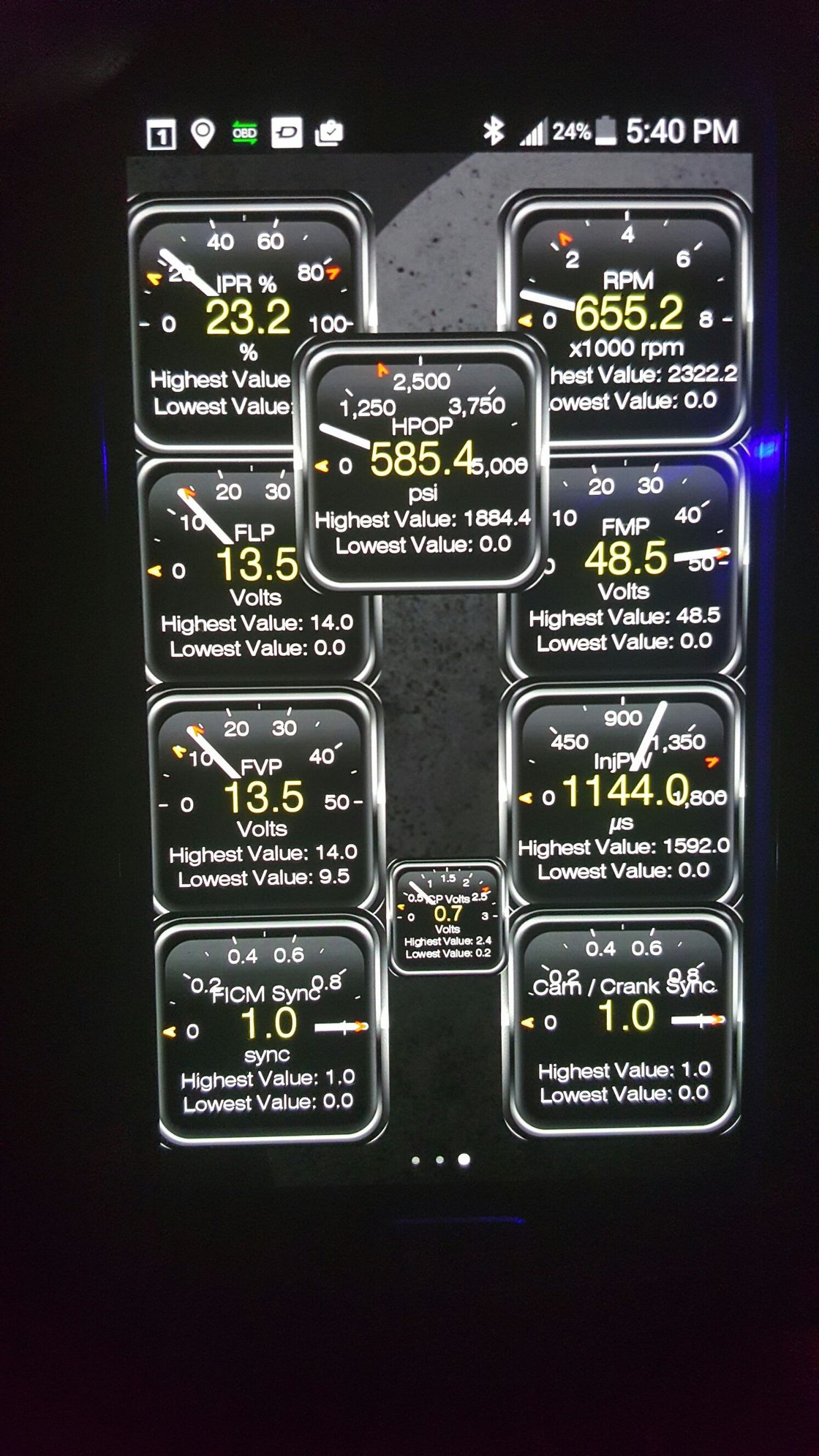

I pulled the hpop cover and applied air to the top of the pump for 20 seconds.. didn't hear anything then when I stopped the air and eased up on the air nosel oil shot out of the top.. so I'm thinking that is a good thing. The air had no where to go.. I inspected the o-rings and they look good. Going to put it back together and see what happens. Maybe the ipr valve was bad but the air check was a piece of mind.

Old Nov 3, 2015 | 08:09 PM

How do those numbers look!!!!

It was the IPR Valve! Glad we checked the hpop though, if that back piece had broke off inside.. well I don't want to think what would have happened..lol. The only problem I still have is that darn nipple I broke on the radiator, the fix didn't work and its leaking. I may have bumped it a few more times while working on it this past week. I wrapped the threads on the new nipple with Teflon tape and screwed it back in. It doesn't go in tight but its pretty snug and I JB Welded the heck out of it. I'll check it in the morning meanwhile I am pricing a new radiator. Any brands besides Dorman to stay away from? Mark thank you so much for all your help and guidance and thank you to everyone else who helped too.
