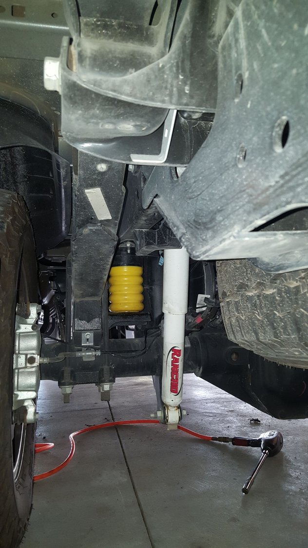

Rather than air bags i installed SumoSprings. Sits level, rides great, and no air to mess with. Pushing 3000 lb with pin, hitch, and cargo.

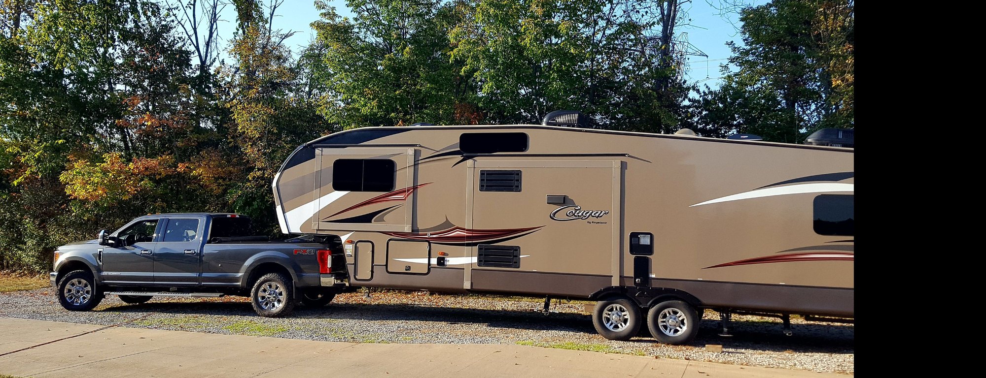

Rather than air bags i installed SumoSprings. Sits level, rides great, and no air to mess with. Pushing 3000 lb with pin, hitch, and cargo. Also have a Reese 5th airborne pin box. Rides better than my 2011 dually did. Next upgrade will be Bilstein shocks.
