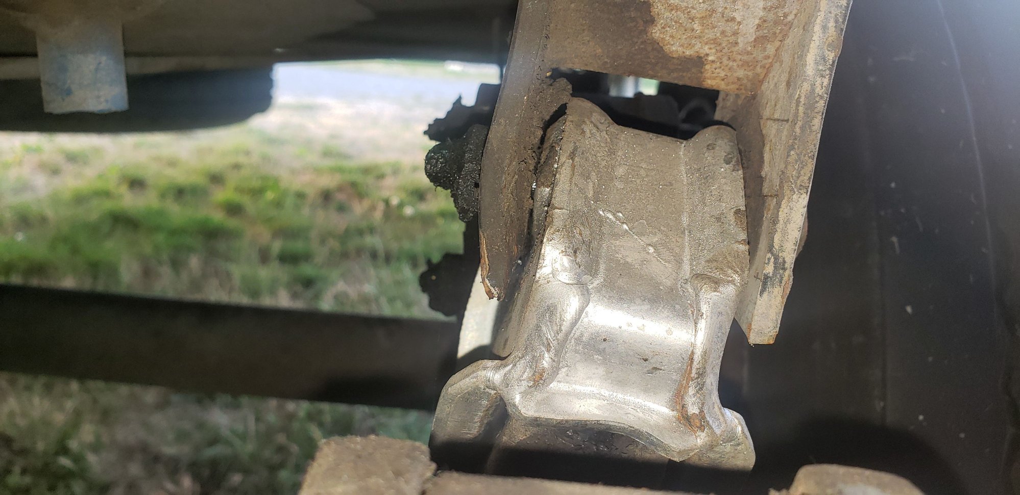

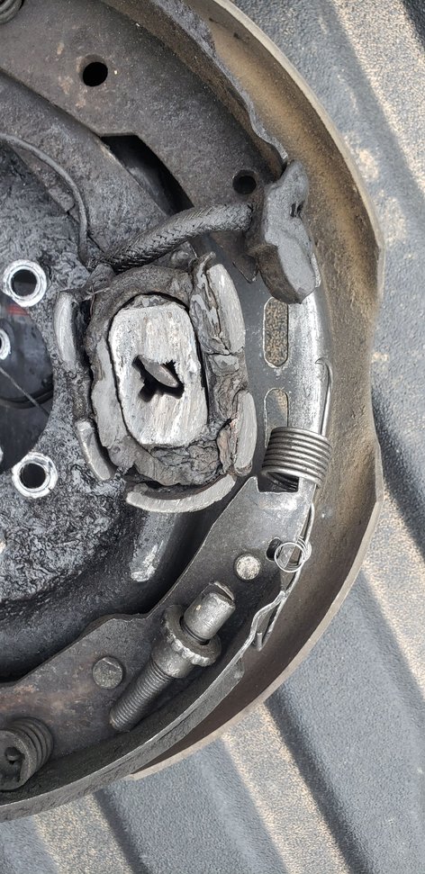

I used to have to drive to the end of my road and turn around in the cul de sac to back into my driveway and this is what happens when you make 90+ degree turns multiple times. The lateral stress on the hubs caused 2 hub seals to leak, destroyed all 4 of my brake assemblies and bent the hanger for my suspension equalizer. Having an F450 and turning that tight causes more harm than good. If you have a driveway that tight you are going to be causing a ton of stress on your frame, tires, axles and suspension every time.

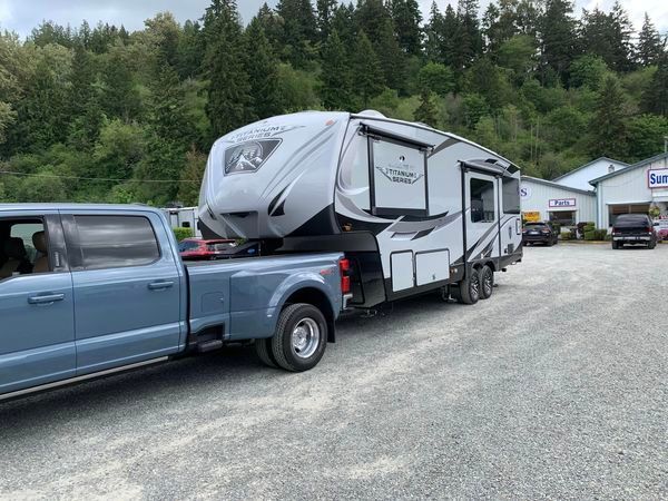

Picked this up last F
riday.

I have thought about it and after seeing the damage above that tight turns can cause, it's worth thinking some more . I'd have no problem as long as someone doesn't come up behind me as I'm trying to get backed onto our street.
