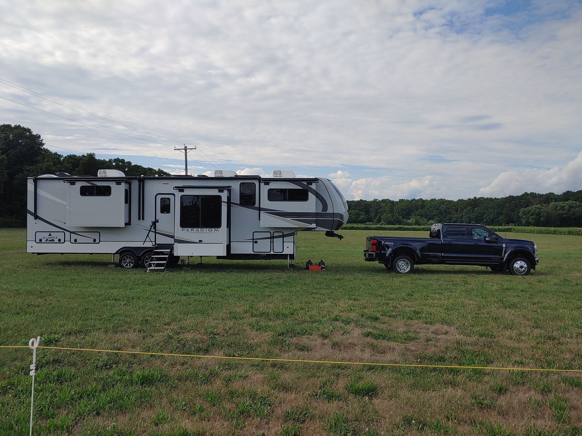

Our rig. Love it and the truck handles it quite well. Afr25 yrs in truck campers this thing feels like a palace. IVe not figured out the pivot point when backing it in yet,so that is still a bit of a struggle.

Originally Posted by rufushusky
That is an awesome looking set up, as a short bus (ummm I mean bed) jockey, the amount of space you have with that long bed looks really nice... you could install a hot tub in there!
Dont give my wife any ideas. Im prbably going to put tool box in.

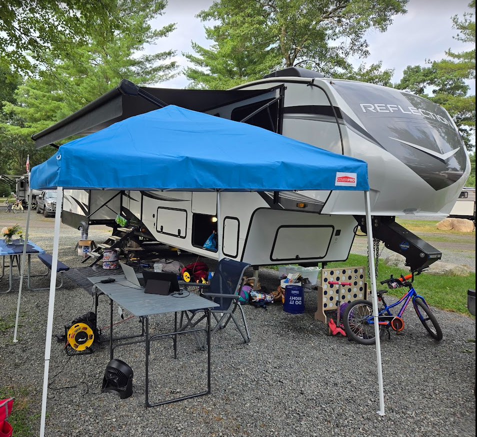

I had mine in our driveway for the first time and had the power adapted down to the 20 amp line off the back of the house and my surge protector tripped. I got a voltage out of range error causing the trip, I was just running the power to top off the battery (yes only one, ugh) for the fridge. So similar issue, the surge protector saw something it didn't like and popped. I was surprised how much the battery got drawn down, it was 90*F+ but still more than I expected.
Slight side note... my office for the day.
