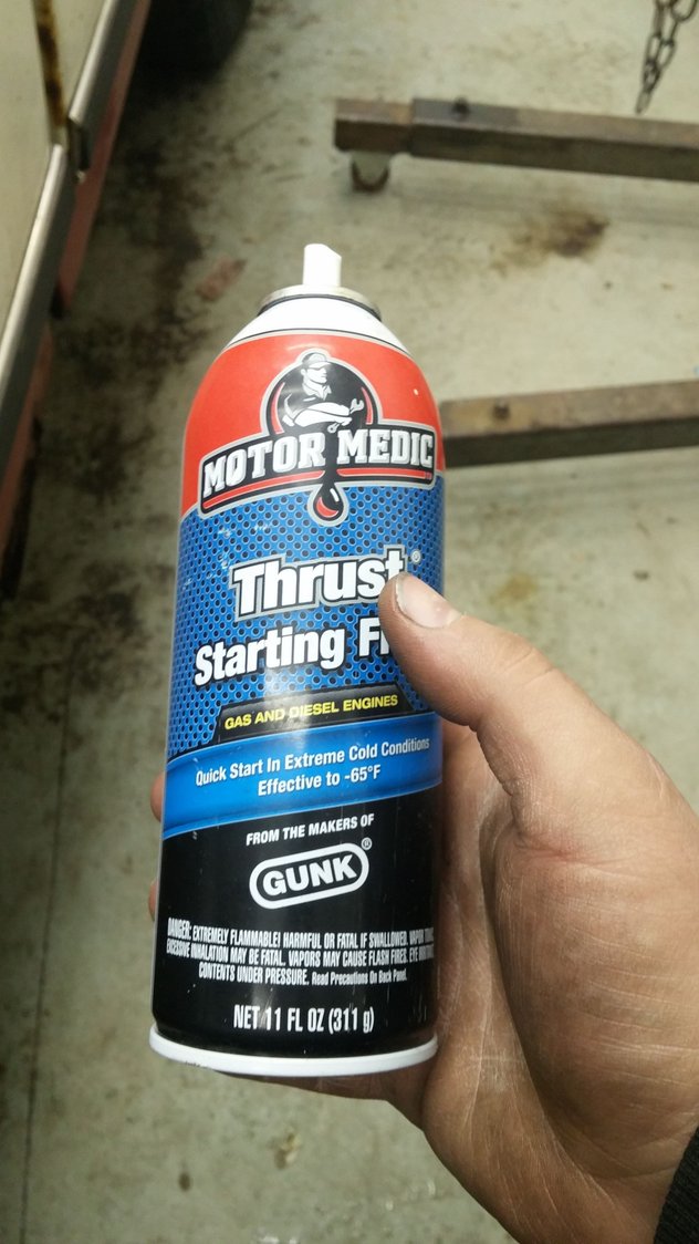

Think I found out why he wanted it gone, pry doesn't start very well with out GPS

Yep, there's a ton of GP info in the faq. Get that system working so you can stop using that Liquid Engine Destroyer.

Ether is fine.....until the gp controller decides to work once....
i always made sure power was disconnected to the gp relay before squirting.

That's the way to do it if you have to, but it's best just to avoid it altogether. The horrible noise these IDI's make when firing off of ether is the detonation before the piston reaches TDC and that's not healthy for any engine.

Oh yeah I know better on the either, that is getting,f fixed pronto. Light comes on for 10 seconds or so then it starts clicking on and off. Is this normal operation?
