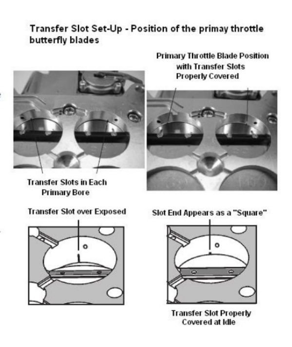

The valves are almost closed all the way as it is now. I tried turning down to 2 turns out but engine wants to run rough. I could compensate by bringing the idle speed up on the screw but that will then open the valves enough to start bringing in fuel from the primary circuit.
Not sure if a 2bbl will be able to run on 1/2 turn but I can give it a try I believe right now I got it set at 3 1/2 turns on passenger side and 3 turns on driver side.
As far as the manual goes, that is out the window as this is a early to mid '70s Motorcraft 2100 2bbl carb. The manual would only cover the Holley 4000 which will help me greatly when I get around to rebuilding it so I can put it back on the car.

Well every engine is going to be different, and also carburetors, production tolerances, etc. BUT, there is a stock setup starting point for that engine. Typically that will be plenty rich, and the needles are turned in for "lean drop". 3 turns out would have most idle mixture screws falling out? That just doesn't sound right. Hm.

I know it sounds excessive but I have unscrewed it 6 turns and they didn't fall out when I was messing with it before I took the carb apart to clean it again.
I do still want to try and get the rpm more rock steady and remove the vibration in the car itself which is more when its in gear. So I will keep that in mind and play with the settings some. Might try turning the idle mixture screws in and idling the speed up to see what that does.

well I took and set my idle speed screw to half turn from fully closed I then used vacuum gauge and my tach/dwell meter to set the carb. Down side, I cant get the idle speed below 750 if I close the throttle plates all the way. Half turn out is 800 rpm. I do how ever have a very steady idle now and almost 19" of vacuum at idle that is steady.
I believe the only way I could get the idle speed to go down is to adjust the timing which I really don't want to do as the car starts too good and runs too good to go screwing with it.
In gear I am running right at 625 rpm in gear and no generator light.
I also turned one idle mixture screw in all the way, engine ran very rough and quickly stalled out. So the carb is set ideal based off what I have heard to date.
