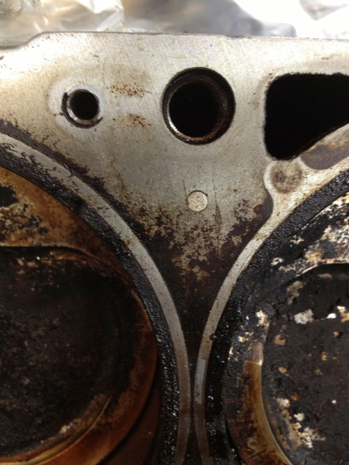

Originally Posted by SteveBricks
Good to see you around Marc
Oil in the coolant? Hope it's just a head gasket.
Yup, check this.
See the fire ring extending into the water jacket.

OK, just WHOSE head gasket is that?
At least it isn't a crack somewhere!
Looks like it will be an easy fix.
Pop
I didn't know it was fire-ringed. You don't fool around, do you?
Pop
Yup all good.
It's a Felpro. POS
