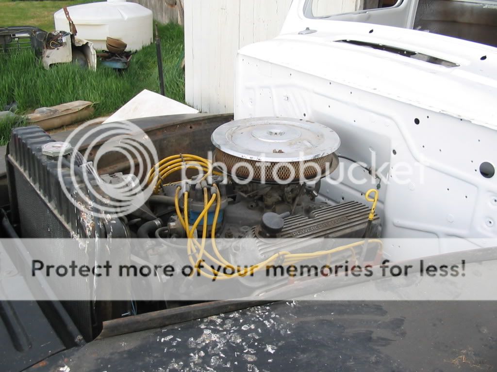

Do the 53-56 have a shorter distance between the firewall and axle centerline than the 48-52 trucks? My 302 clears the firewall just fine using the stock mounts. They did go from a 114" wheelbase to 110".
Yes I believe so. When I was mocking mine up on a 78 F250 4x4 chassis I had to cut out the center of the firewall to get the cab far enough forward to clear the bellhousing and the back of the engine.
