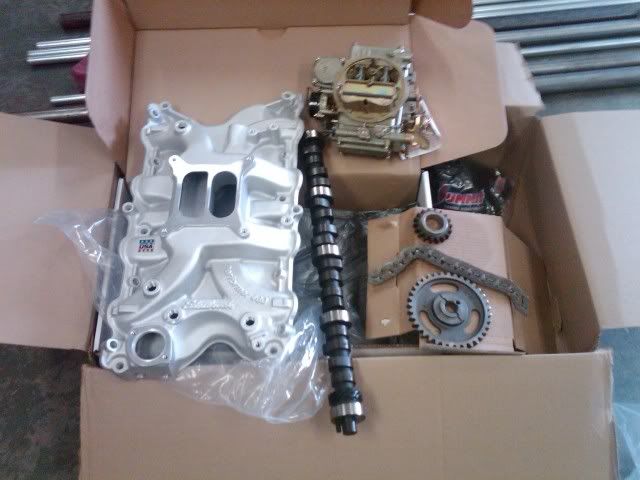

I also got a box with this stuff in it.
I like shiny things.

Did you get the timing chain with 4* retard built in???
I can only see one keyway in that crank sprocket.

Very likely he did, most suppliers list "one size fits all" timing sets for the pre 88 460s. If you ask about the 68-71 set, they tell you it's the same. I would just get a late roller chain set rather than even mess with a Morse set ever again. BTW, they are straight up.
Summit Racing SUM-G6537 - Summit Racing® Standard Timing Sets - Overview - SummitRacing.com
It's the same one I posted. One key way. No advance or retard. I called tech support at summit when I ordered to verify.
I asked about the cloyes one and the roller will get me 2hp. So the dude said just get the regular one.

ArdWrknTrk's Avatar
ArdWrknTrk
pedant
Joined: Jan 2008
Posts: 23,576
Likes: 40
From: EXTREME southwest CT
BS!
They have no idea.
Either get a pre '70, or as Bill said, the single roller for the EFI trucks if you're not willing to spend the extra $5 to get rid of the emissions crap timing.
That's one way to go. and an economical one too.
I'm not looking at gaining 2hp in frictional loss from a roller, I'm looking at not having to replace the crap hivo in 60k.
4* of cam retard is probably worth 50 foot pounds and a whole hell of a lot of throttle response.
BS!
They have no idea.
I'm willing to spend the $5. That's not the issue.
If you check the application on this one I posted it is 68-71.
