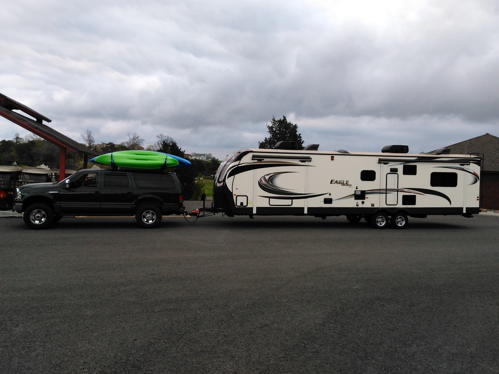

I don't have the HA installed on the new camper as of yet but with or old camper I felt like the bars were pulled too far past horizontal. The trailer rode flat but the bars did not. That's what I'm trying to get away from but the new camper sits a bit higher at the hitch when level than the old so I may be in good shape just want to have some options if need be.
The HA is a little different than most WD setups and one of those differences is that the ends of the bars do typically bend up past level, its completely normal and acceptable for an HA. It's more important to keep the hitch heads as level as possible to allow for proper articulation between the upper and lower units.
Look at how far up my bar ends are here, that's how they always are when loaded, have been tensioned like that for over 30K towing miles.
Attachment 280687
I have found you need to set the stinger angle to compensate for the tongue weight and have the head at the same angle. When you draw the jacks up the head lifts and puts the WD on the front axle. My bars are pretty parallel after I crank it up 26 turns each.
I guess things are a little different between the HA and PP then, the HA doesn't have the ability to adjust the stinger angle, it's a fixed solid steel unit. Those are 1400lb spring bars fully cranked with 1840lbs of TT tongue weight in my picture.
I didn't realize that the PP adjustable stinger has the ability to tilt the head like a typical WD setup, pretty cool!
Great to know! I really appreciate the information. Our bars were not quite that extreme with a 9.5k trailer behind it. The new TT is longer and heavier so I feel much better about it!
