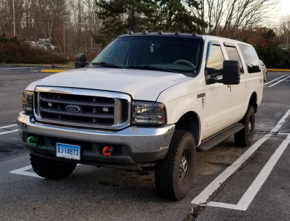

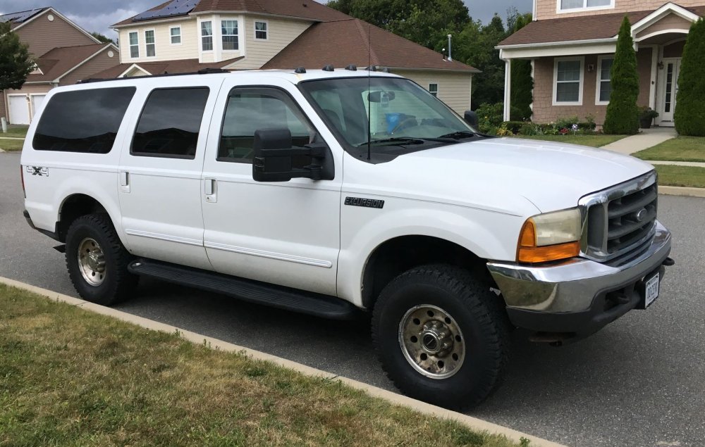

When the OP first started his build thread, he included a list of his plans for the Excursion as well as the stock picture above. As you can see in the list below, he has edited that initial post as time has gone on, pointing out what he has accomplished over the last six months.
“I’m back after a short hiatus. Gonna be a little bit more reserved with this one…I think
Drivetrain:
  1. Change fluids
    2. Muffler delete/straight pipe
    3. Leave alone otherwise
Suspension:
  1. V codes Front – Done
  2. Modded B codes rear – Done
    3. 285/75R16 Treadwright Warden AT – Done
    4. New shocks – Done
    5. Flip sway bar end links/mount – Done
    6. Replace Steering stabilizer
    7. Replace ball joints (Driver – Done)
Interior:
  1. 4×2 Rear Hatch Struts
    2. Touchscreen radio with BT/ELM/WIFI
    3. 08+ center console…or at least 2002+ console cupholders
    4. Maglite mounted by drivers seat – Done
    5. 2002+ dash cupholders
Exterior:
  1. 2008 Style Tow Mirrors- Done
    2. 2006 Style Headlights with DIY Harley Mod
    3. 4X4 Sticker – Done
    4. Shiny tailpipe
    5. Backup Camera
    6. 2005+ front conversion. potentially 2008+
    7. Tinted Cab lights – Done
    8. Marker Lights on running boards
    9. F-250 grab handle on drivers pillar – Done
    10. Black Door Handles
    11. Custom Built Safari style roof rack
    12. Black out rims (corroded), but leave caps chrome
Repairs:
  1. Replace front axle u-joints – Done
    2. Rebuild Auto hubs (currently frozen) – Done
    3. small 1/2″ spot of rust on both rear doors in window seam
    4. Unstick all the power door locks – Done
    5. Figure out why the shifter is so stiff and doesn’t quite lineup – Done
More will occur to me. But for now that’s a decent list. My goal is to have major components done before the snow flies.”

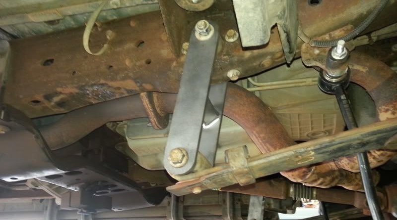

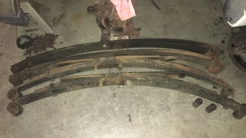

The OP wanted to give his Excursion a more aggressive stance, so he bought leaf springs from a diesel F-350, first installing the fronts and driving the truck for a while without changing the back end. As a result, the back end didn’t sit as high as the OP wanted, but as time went on, he added the beefier rear springs as well.
Tylus Expedition Driver Side

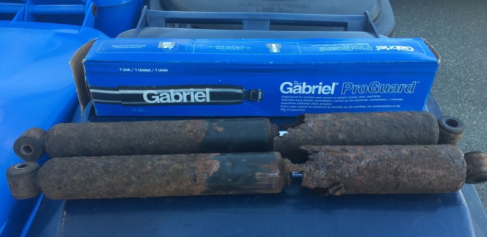

Once he installed the front and rear F-350 springs, a set of one-inch-lift spring shackles and a new set of Gabriel shocks, he had achieved the desired ride height of 26.5″ front/27.75″ rear. Along the way, he also replaced the sway bar end links, the ball joints and the front wheel bearings – all of which were in rough shape.
Tylus Excursion Lifted

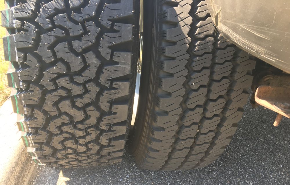

Of course, in addition to giving this Excursion a taller ride height, Tylus also added some bigger, more aggressive tires to help fill the wheelwells and to make the big SUV more capable on rough roads. Also, while it isn’t a suspension mod, the OP added new factory-spec brakes in place of the parts that came on the truck when he bought it.

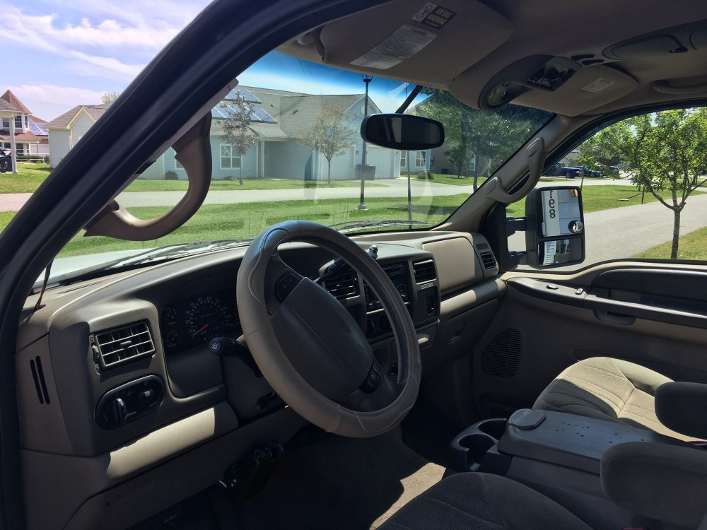

The changes made to the inside of this 2000 Ford Excursion has been minor, but the OP fixed the rear defroster and the power door locks, along with adding a flashlight mount next to the driver’s seat, universal cup holders in the center console and a driver’s side grab handle from a Super Duty.
Tylus Excursion Cabin
He also added new leather to the center console armrest.

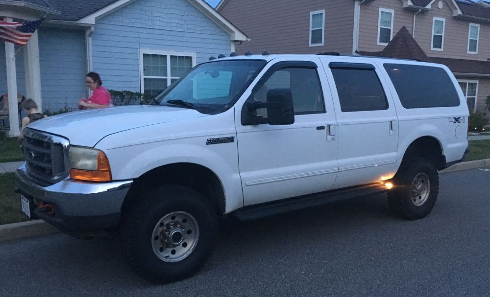

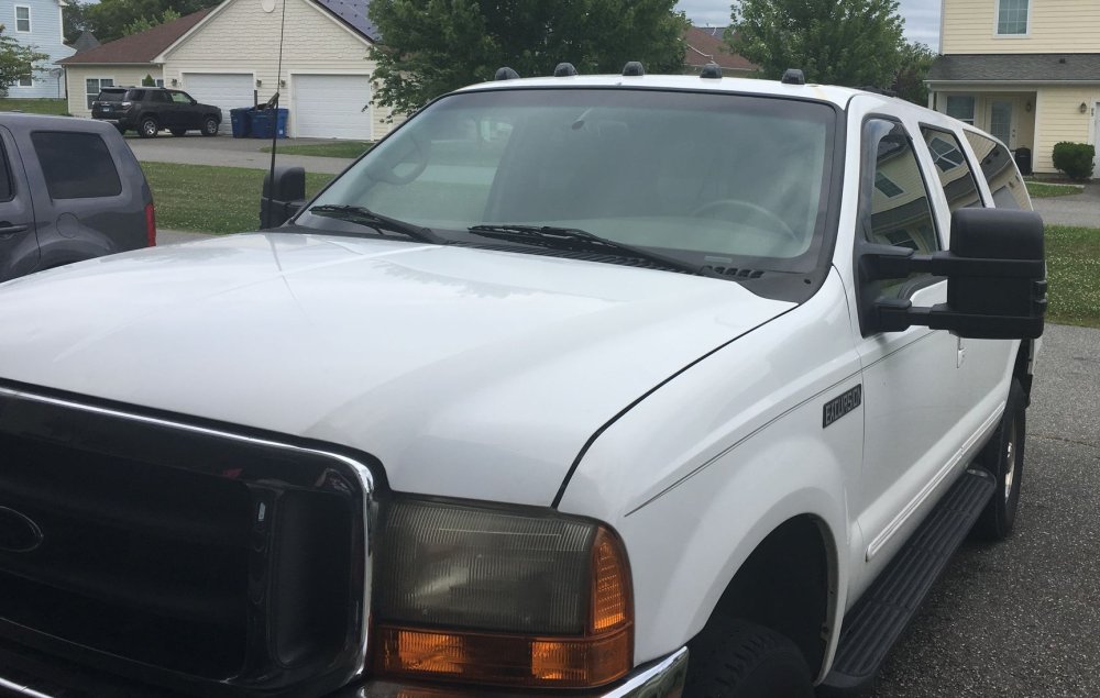

On the outside, this 2000 Ford Excursion looks more muscular than when stock thanks to the big tires and the lifted suspension, but he also made some simple modifications to give this big SUV a unique look.
Excursion Light Mod
Up front, he has added a set of clearance lights across the top of the windshield and he added Harley-Davidson-edition headlight lenses with LED bulbs.
Tylus Excursion Today
Out back, the OP added the dual taillight mod while also installing an LED light bar between the bumper and the rear doors.

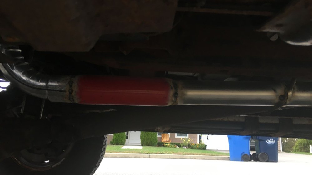

Finally, when the stock exhaust rusted apart, Tylus added new piping with a glasspack muffler, adding more sound from the V10 engine.
Excursion Exhaust
