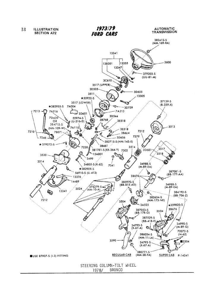

374279 tilt joint
Looking at the exploded view provided, the 374279 looks like the universal joint, how does that convert to a Ford part number? Being a number is shown within the bracket of the shaft I’m guessing that means it’s an available sub component.

Posts: 50,247
Likes: 5,815
#3524 looks like the u joint assembly #...so check this out for maybe some actual part #'s. https://www.ford-trucks.com/forums/1...lumn-slop.html
