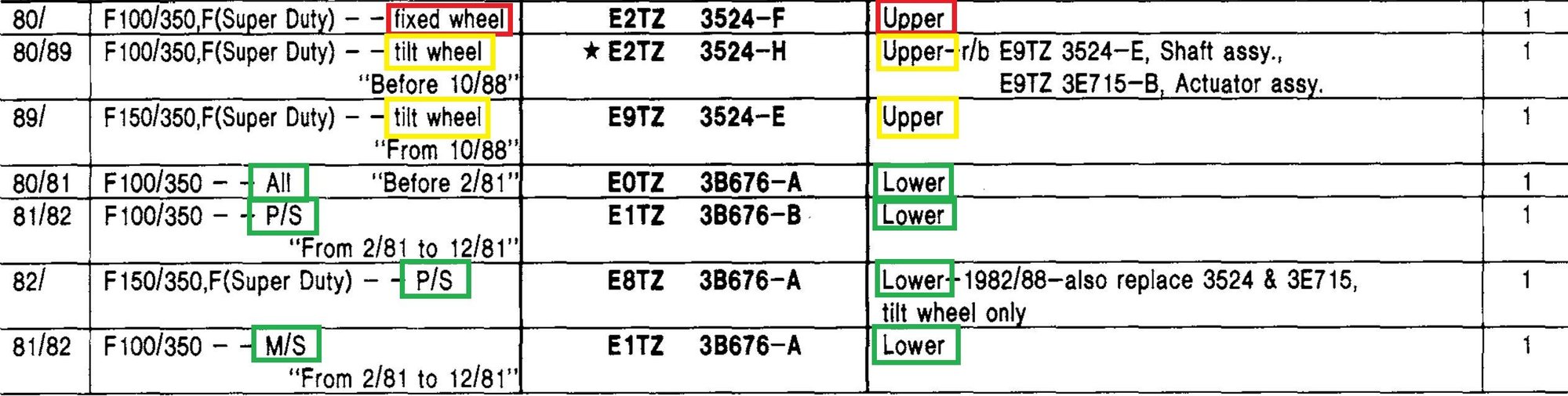

The non-tilt column doesn't have that u-joint, as shown in the illustrations here: Steering Columns - Gary's Garagemahal, and it is a direct swap.
However, the parts are available to fix your column, although I don't know the cost. On the second illustration in the link above you'll see that the shaft, u-joint, and some other bits are labeled "3524". Looking that up in the parts catalog I see that the original part number of E2TZ 3524-H was replaced by part # E9TZ 3524-E. Rear Counter shows only one of the originals in stock at a dealer. But 15 of the new ones are shown at Rear Counter. I would click on the Request Pricing link on several of the places shown and find out what the parts and shipping would cost. And, my personal preference would be to go with the new part as it will have been upgraded. But, the original part might be cheaper.

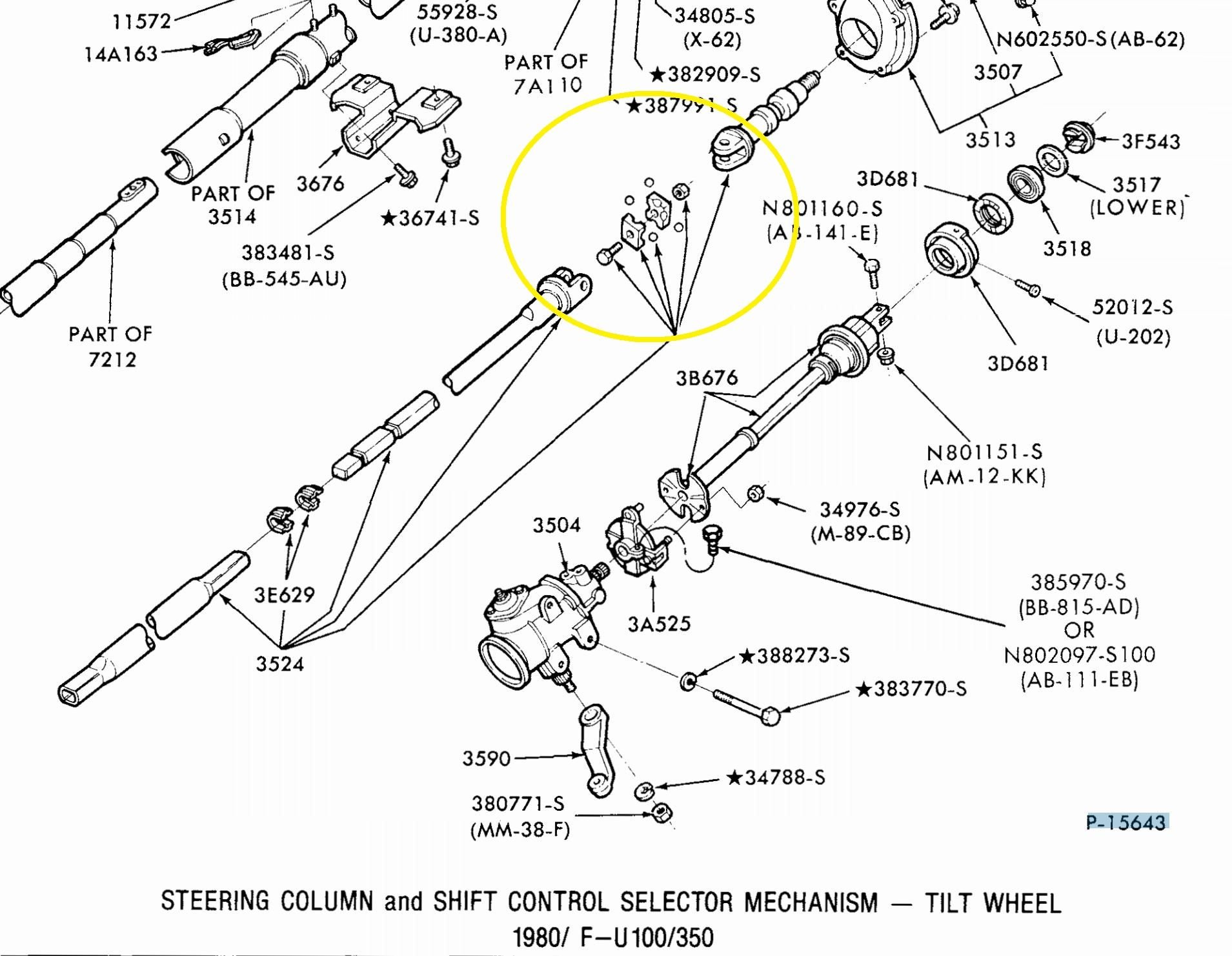

Bill - You are the master and I'm seeking to learn from you. And, while I realize the illustrations can be wrong, this one from a tilt wheel shows what looks to be a u-joint on the upper shaft - circled in yellow. Further, the non-tilt shaft doesn't have that u-joint.
And, this snippet from the text section says that there were different upper shafts for fixed vs tilt columns, but that the lower shafts didn't differ for fixed or tilt columns:
So, how can the lower shaft have the u-joint when the illustration shows it to be in the upper shaft, and the same lower shaft is used for both tilt and fixed wheels?

The U-joint Bill is talking about - 3B676 - is the one on the lower shaft near the rag joint (which the OP says he removed somehow; I don't recommend that but it's his truck so it's his call).
If we are talking the U-joint located inside the cab (the OP says "Found 'u joint ' at top is very loose" so I would guess this is what he's referring to) where a tilt wheel tilts, that is the 3524 stuff.

Chris - Thanks. That makes sense. So, if ElectricFork is talking about the u-joint at the top of the column, which is specific to the tilt units, then my statement is correct. (I'm copying it here to ensure we know which one.)
