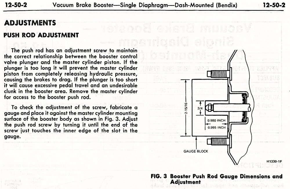

You post new MC and BOOSTER? Were these rebuilt and by whom?
Is the pin between the MC and BOOSTER adjusted correctly?
Check linkage(s) for binding,

I can try to adjust the rod in the master cylinder more if that helps
I guess the smaller I make the rod the higher the pedal will go right ?

If you mess with that adjustment and mess up, you'll either be pumping the pedal, or the brakes will maybe never release.
I bought a simple gauge to measure mine.

... since my pedal breaks fine just doesn’t return all the way I might just go for a spring adapted to bring it all the way up every time
That would be just masking the defect, even if it worked. Say if the return problem is in the MC itself, the piston will still be extended.
I think there was a similar problem posted not long ago and it was found to be a defective booster. You have to be careful of where you buys parts now.
