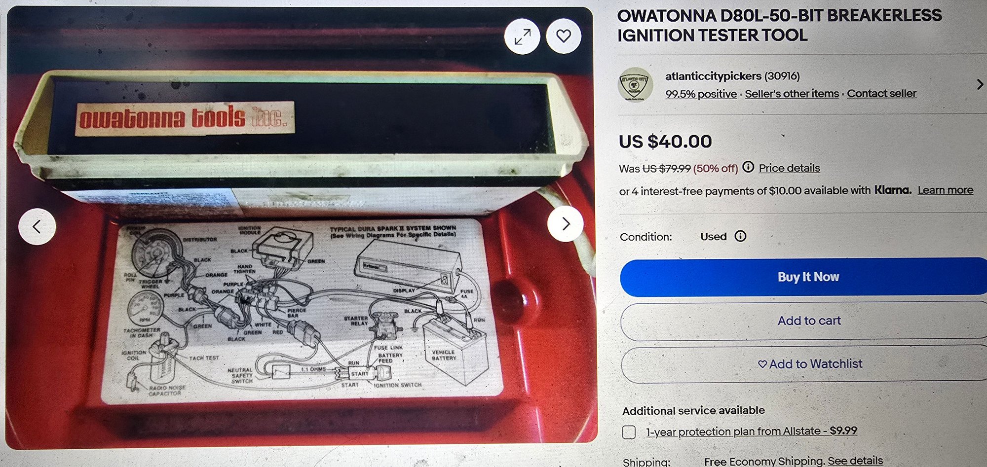

Here is the Ford tester for the breakerless system
A basic test for the Stator (Motorcraft DU5) is to see if the negative side of the coil blinks as you crank the motor over trying to start it
Ford calls the pickup coil in the distributor a stator
* These testers are the key
