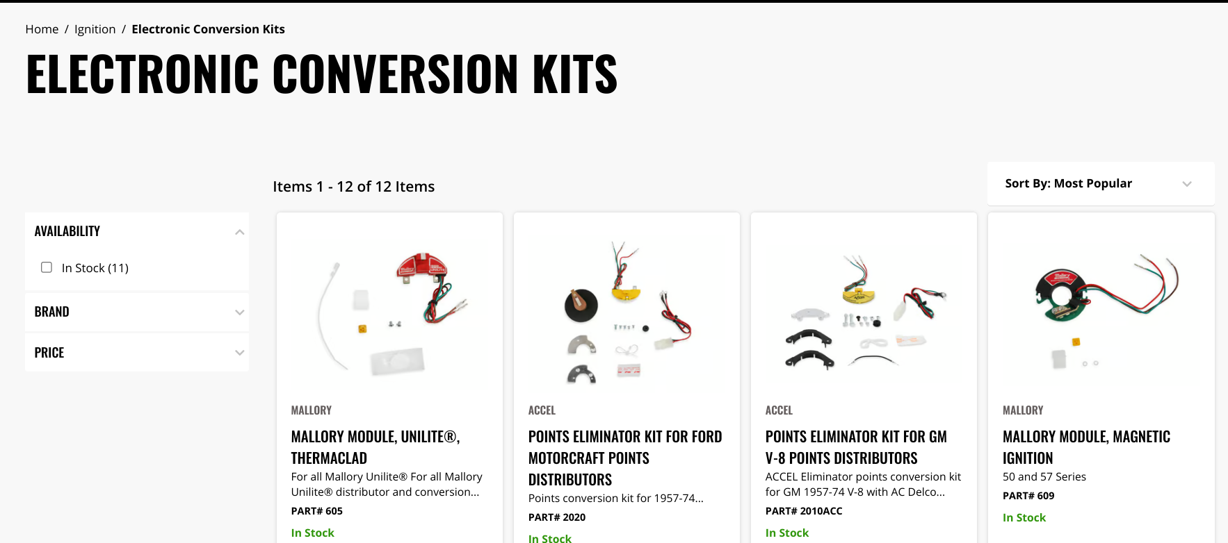

Do you have the Mallory Unilite Distributor or a MSD Billet?
If MSD Billet:
https://www.holley.com/products/igni...ts/parts/84661
If Mallory Unilite:
https://www.holley.com/products/igni...nversion_kits/

I have a Mallory unilite which one of this is it? Of the four you showed?
