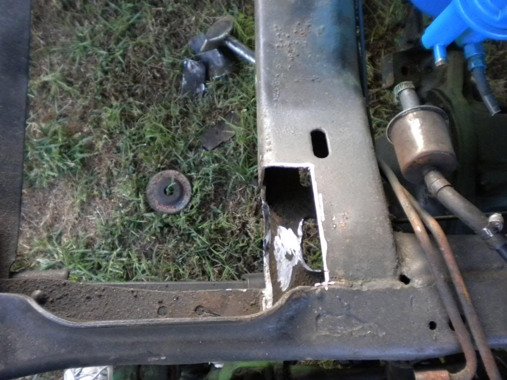

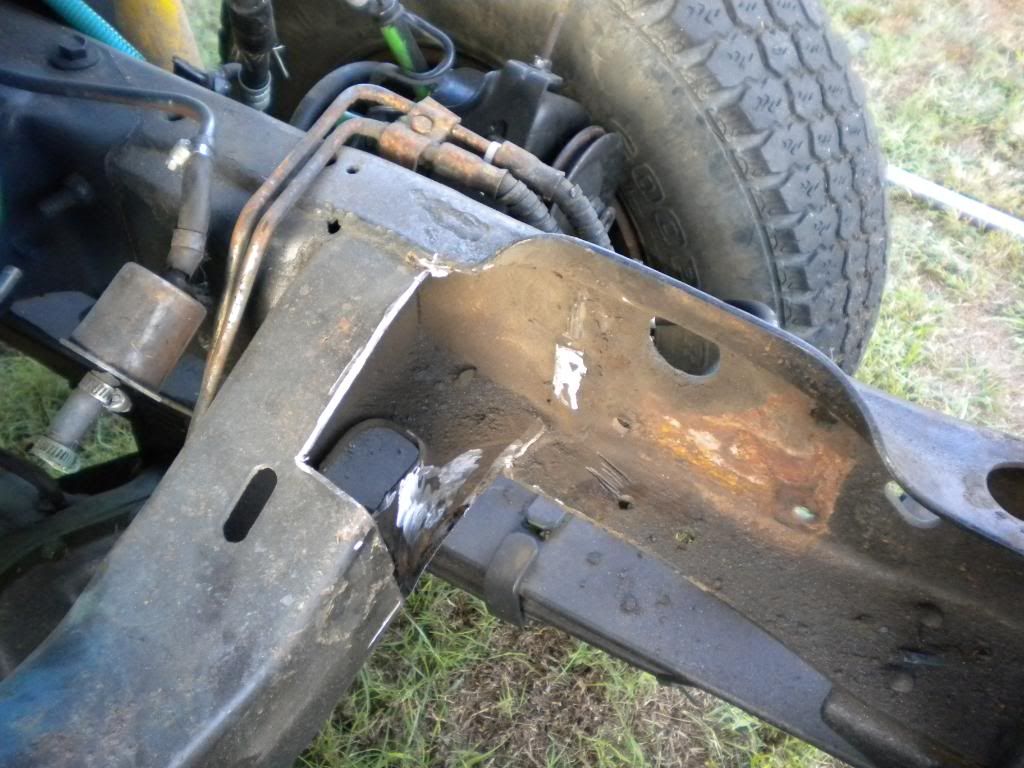

here are some pics of my steering conversion so far plus pics of my spring conversion.
http://i579.photobucket.com/albums/s...58/2009009.jpg
http://i579.photobucket.com/albums/s...58/2009010.jpg
http://i579.photobucket.com/albums/s...8/truck001.jpg

I decided not to put the reese hitch in front but I wlill put some D rings on it. I used 78 front spring hangers and I didn't like the way they fit on the frame so I incorperated them into a piece of 2x4x1/4 rectangler box,which will drop my center piont 2 1/2 inches so I will make new rear shackles with the same drop.This is and the sd springs is more lift than I wanted but I guess as the saying goes go big or go home. I have four days off work so I will post pics of progress I hope to get susp and steering done and then I'll start painting the frame I hope bucks 77 doesn't mind but I'm going to use his silver and black paint scheme on my frame I like the way that looked.

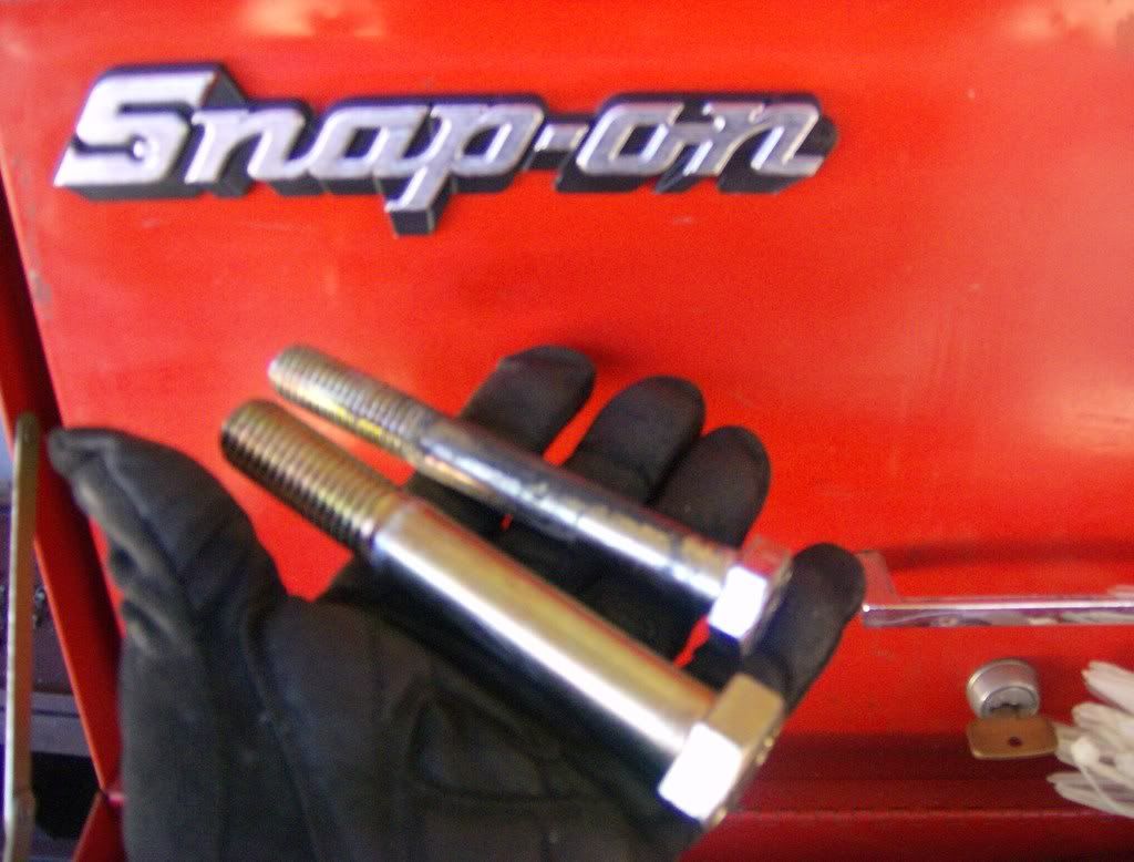

Thats looking real nice. I do think that the lift wil be greater than expected, thought it will ride real nice. Do keep in mind that the fasteners for the SD springs are metric,so you will have to modify the hamger slightly, or modify the bushing.
I went ahead and installed a 3/4" bolt as opposed to running the 18mm unit, and had to make the bushing in the spring larger to accomodate, but I was pleased with the results.

75350 what did you use to drill the bushing?I started mine today and I would have been a old man by the time it was done
Time and patience. Actually what I did the first time was use a drill press and a vise to clamp the inner sleeve before the sleeve was cut down. Original sleeves are wider than the spring eye and they can be clamped into a vise. This requires some assistance, as these springs are heavy and difficult to lug around.
In other cases, I have had to use a die grinder and slowly grind away at the inner sleeve.
Many stores carry cylindrical stones that measure 3/4" diameters. These worked the best, though it is still a painstaking process.
