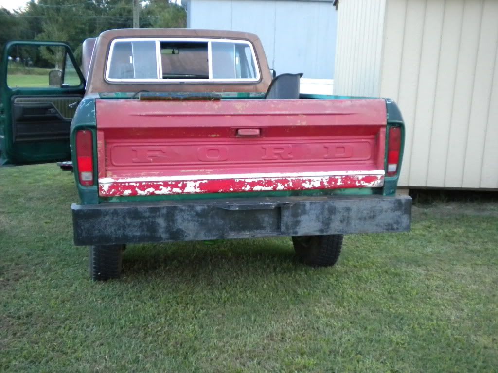

started to tear down the truck today my son and I got the dog house disassembled.going to work on it again tomorrow going to try and get the cab off of frame.
I'm going to blast frame and paint. I'm going to go with the 78-79 250 steering box so i'm going to mod the frame also.
