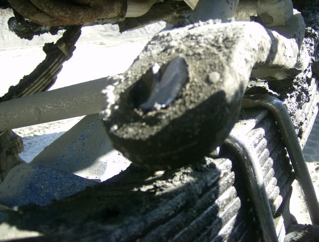

Your experience with the 3 bolt box (1/2 ton 4wd) is probably a bad one partly due to the same reasons why the 2wd box is less desirable. That sector shaft is long and can develop leaks. Add some slightly larger tires, ot put it through the paces off road, and this flex in the sector will eventually develop a leak. Just a big box and long sector that is not a very good design.
Notice that new fords use a box with a short sector just like the 78/9 F250 used? Good reason why we dont see the old long style boxes being used any more.
Retrofit is cool, but for the same effort, other boxes are stronger thus more desirable.
Example of that sector shaft problem:

75f350...ouch, that shaft break had to hurt and it does not look like it happened at a good moment.
Old Sep 14, 2009 | 05:44 PM
75F350's Avatar
75F350
Joined: Jul 2006
Posts: 6,948
Likes: 44
loosing the steering is much like loosing your brakes, (arguably worse), in that neither one ever gets lost at a "good" time.

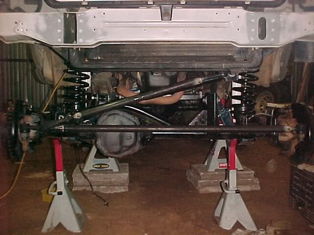

Ok, Inverted "T" and crossover are very similar by design, but the only difference would be where the drag link attaches to the pass side.
The real crossover design will attach to the top of the pass side knuckle by method of a steering arm similar to the one on the driver side, only it is now located on the pass side.
Inverted "T" will still have a long drag link that runs parallel to the tie rod, but the drag link actually attaches to the tie rod itself. Both reasonable methods of steering designs but depending on the budget or the axle that it will be going on, one might have an advantage over the other.
Dana 44 axles are not as cost effective as the dana 60, so often inverted "T" is a popular swap.
Crossover for the dana 60 is used due in part because it is a bolt on deal.
Dana 60 using Chebby tir rod ends and abolt on steering arm:
An example of inverted "T" style:
Components and to use inverted "T". This is for the tie rod:
Drag link options:
Or in this case, if you have a Dana 44, you can use stock components from the 1/2 ton F150 or 78/9 Bronco. They used smaller tie rod ends but would probaly be fine in this application.
all of the components are available through local parts store so there are no special ends to buy. This is nice if you ever have to make a field repair.
About the only custom piece would be the tie rod and drag link depending upon which steering box you use.
With your limited amount of lift clearance will be an issue, so you will have to be carefull with steering box location and you will watch for the pass side spring if using inverted "t"
Drag link may have to be slightly bent in order to clear the spring at a full lock turn to the right.
Hope this helps out.
