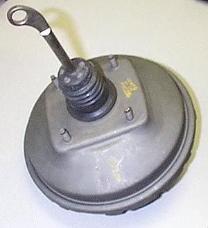

I see you are working on a 2wd. I have a 79 4wd crew and my booster looks like this
I see the rod coming out of your booster is straight. Would this be a problem with the F450 hydroboost booster??

Vacuum boosters bolt onto a firewall bracket which then gets bolted to the firewall. The bracket has it's own rod assembly that attaches to the pedal. The booster pushrod is bolted to the bracket rocker.
Josh
Josh
I might be misunderstanding your statement.
The booster bolts to the bracket and the booster pushrod bolts directly the pedal in my application. No rocker bracket or pivot point.
My 68 bronco has a pivot point behind the booster bracket.
