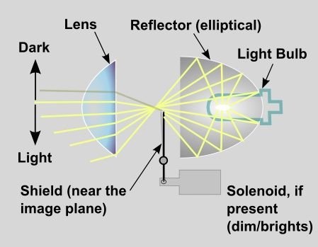

Originally Posted by Firekite
So if there's a single element, how does it switch from low to high and back again?
There is a shield between the reflector and projector that creates the cutoff. In "bi-xenon" retrofits, that shield is moved by a solenoid when high beams are selected.

Or the lamp moves on most case for retrofit headlights.
BTW there is not any filament, Just a arc gap. High voltage
is applied and an arc jumps the gap and ionizes the gas.
That creates a path for the main current ti flow. The color
is created by 2 things. The mix of the gases and by the diplomatic
filter that is part of the outer envelope.
Are you asking about an HID bi-xenon projector? If so, a solenoid controls a shield. The shield is in place giving a clean cutoff line. When you activate high beams the solenoid triggers the shield to move out of the way allowing the full light output.

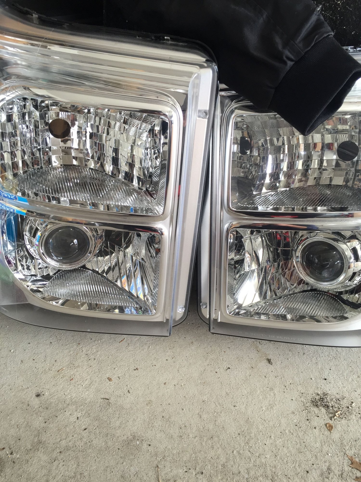

I just installed my HID projector retrofit last night with great results. It took a little time lining things up, but I am pretty happy now.
Black Flame Customs did an awesome job with them.
Wow, the quality of light placed in both lo and hi beam is exceptional. Very nice..
