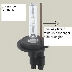

Hey everyone,
I am new to the forums and I had a few questions regarding these new H13 6000k Bi-Xenon lights I just installed in my 2006 Eddie Bauer. I have two questions regarding my install.
1. The Bulb positioning
I was told to have the bulb positioned a certain way in the headlight housing. Is this correct? Please refer to the image below for verification purposes.
2. Hi/Lo Feature
I hooked up everything correctly and have a slight issue when switching into high beams. I noticed that when I have the car off and switch the lights on & then into "High Beams" they work perfectly fine.
The funny things is when I start the car and turn the lights on the low beams are fine. But when I switch on the high beams there is a slight buzzing sound coming from the driver side or Ballast.
Now I called the company and they told me to try and switch the ballast around. I did exactly that and the same thing, nothing changed.
I also noticed that the on-board indicator is trying to find the "Left & Right Lamps" as well as the High & Low Beams. Is this a reason for that sound that I am hearing?
I just don't know what else it could possibly be. Is it the relay or something from the stock setting trying to find the original headlights. Or is this a normal sound when switching the BI-Xenon bulbs from "Low to High"
I am driving myself nuts with this project. It seems the lights are shinning wide instead of ahead and straight. They are also shinning up a bit. Can anyone help me please. Let me know if this is a waste of time or is there something that can be done.
I hope someone could explain what this might be.
Thank you all for your time.

Originally Posted by Fordman2010
Hey everyone,
Well... first, it sounds like you bought a "flex" bulb... and not something I'd recommend, whatsoever for HID in a truck.
But that picture, is not an H13. Nor is it Bi-Xenon, or DUAL Hid. Which is what a proper H13 would be.
Nor... would you have the ability to align the bulb as you wish. It's "Keyed" to the socket in the truck. So right off... I'm a bit perplexed.
(If it is a Flex type bulb)
I've removed a few, but don't have much knowledge of installing them.
I'm surprised the place you bought them from, isn't much of help... or, should that not be a surprise?! haha... anyway...
You do have only ONE ballast per side, right?

Hi Johnny,
I appreciate your response. The bulb I have pictured in my msg was just a general bulb not the exact one I have. They are similar in style but that's about it.
I am mostly having problems adjusting my lights. I was told that there were adjustment screws that I can turn "left to right" and "Up and down"
As of right now my lights pretty much light up more of the sidewalks and they are also shinning pretty high. I haven't adjusted them one bit as I thought they would be perfectly aligned from when I had the halogen bulbs in.
Can you explain what needs to be done and if there is an adjustment screw where the hell is it ...lol

The type bulbs I have are the BI-Xenon retractable bulbs. When you hit the Hi-beams they move. As for the buzzing sound I think it is the relay device. I will have them replace that.
As for the actual adjustment would you happen to know where that might be?
