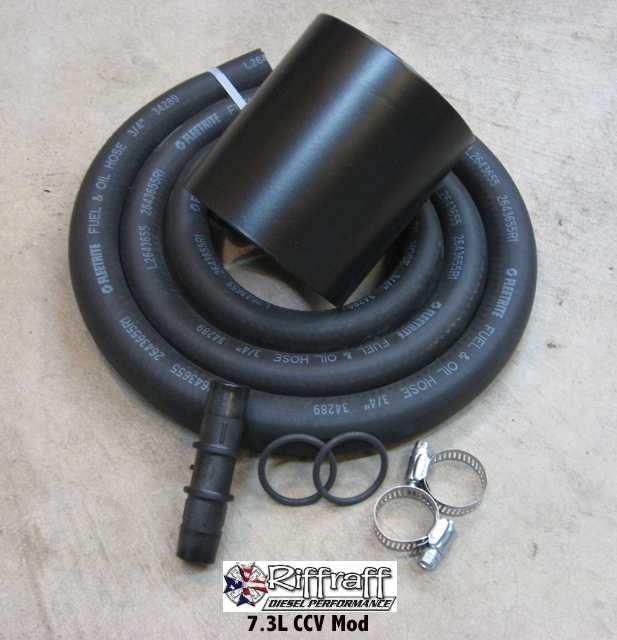

Or just run fuel rated hose like the kind I include in my CCV kit...
Attachment 14258
But that's the easy way. Then you miss out on the fun of driving all over town to get the parts, hoping you wrote the size down right, going to the next store because the one you are at now doesn't have what you need...
