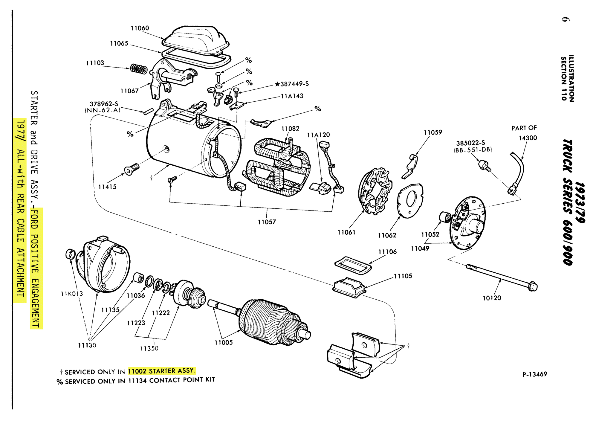

Your second picture in your first post appears to be an accelerator return spring bracket (9741)?

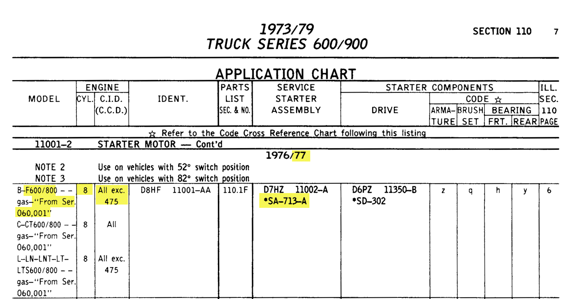

Starters are engineering number 11002:
There are six pages of starters in the MPC! There's a serial number breakpoint for 1977 and yours falls "after" it, but it doesn't really matter, because as Bill said in the previously referenced post, all the FT variant part numbers for all years 73/79 eventually are replaced by Motorcraft SA-713 (SA-713-A). Replacement starters may have a side terminal instead of a rear terminal.
There's no callout for MT vs AT transmissions. But! There were several earlier part numbers for FT starters, so an early starter might not quite look the same as a later one, etc. In 2019, Bill later restated:
D7HZ-11002-A {replaced C4TZ-11002-B (SA-625) & D6TZ-11002-A (SA-713)} .. FT Starter Assy (Motorcraft SA-713-A) / Obsolete
1964/78 B/C/F/L/LN/LNT/LT/LTS500/800 330 2V Medium Duty ~ 330 2V Heavy Duty ~ 361 2V & 4V (1974/78) ~ 391 4V // 1973/78 F350 330 2V
That's a pile of starters that should fit. In that same thread, Ed posted a link that seems to support that 390 FE starter '65+ should also fit. I once looked up some starter differences FE vs FT and found a one-tooth-count different between a couple of models (9 vs 10 IIRC) but they bolt in and work anyway.
If you're experiencing an interference when installing the starter, you may not have a starter issue.
