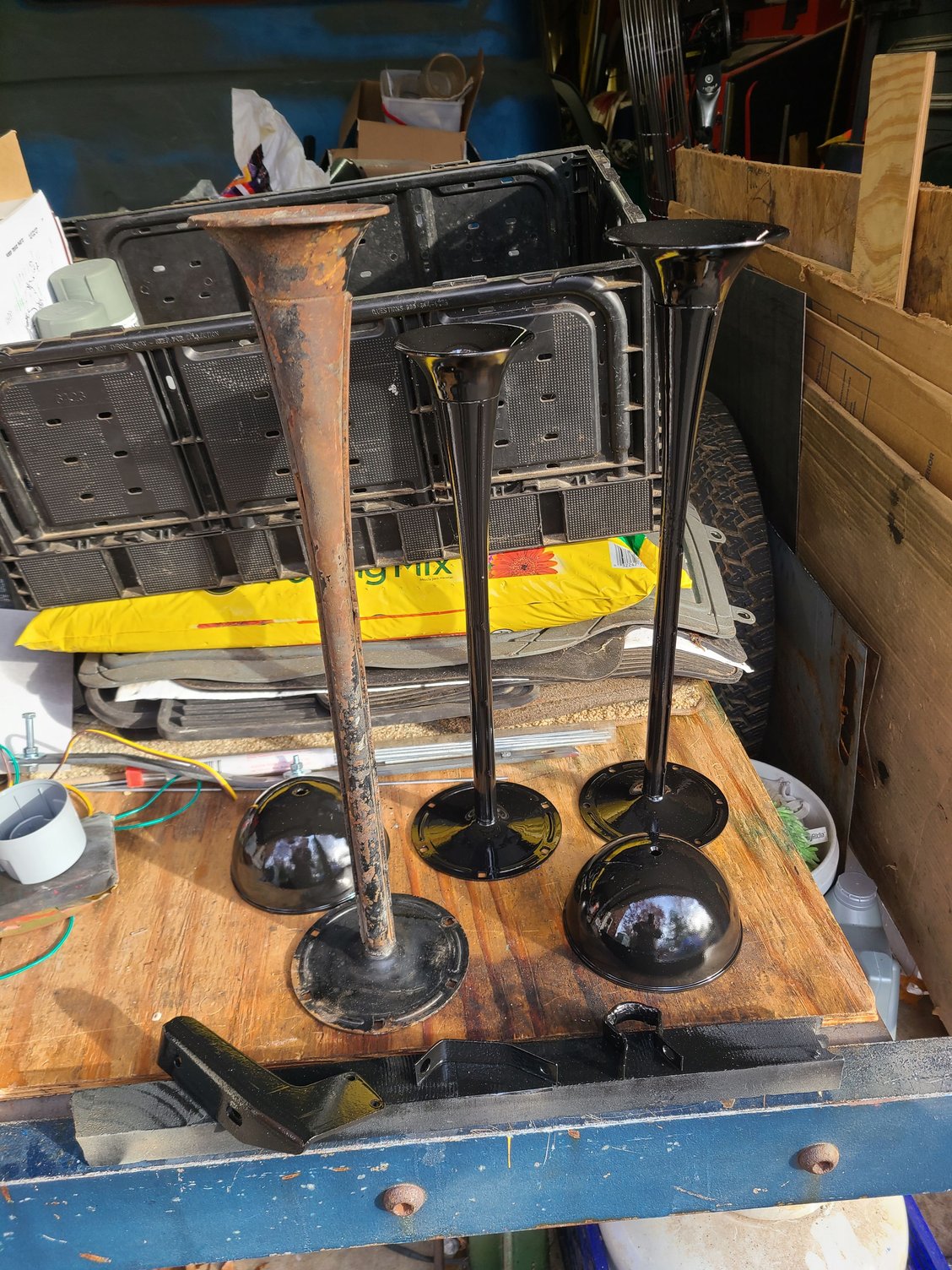

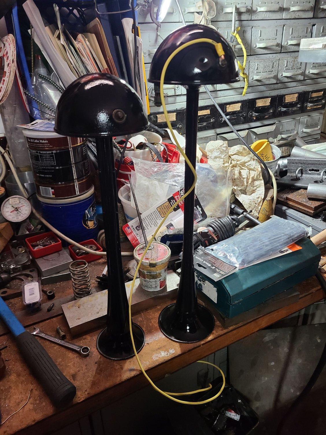

Still working at it.
got my two painted, now to check the armatures. My long black horn now measure correctly for my year, but the shorter one is 16.5 inches.
Ford52F2

Did a few things today. Assembled horns
haven't tested them yet. Also cut out mounting pieces for driver side.
Still need to finish them.

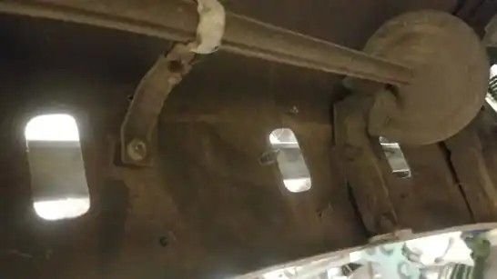

These are not pictured on any truck parts catalog that I can find, but I was able to find them in another application (ignore everything else as they are different):

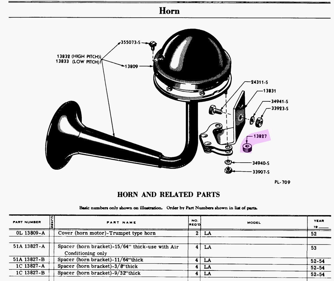

I think these are the 13827 spacers
Hunting for photo of the spacer that goes between bracket and hood side which it probably a square type maybe round.

13827 is a group number denotes a spacer, but not a specific spacer. You need the full part number to get the specifics. Same goes for what I think you meant to be 13830, which is NOT a spacer, but a projector bracket. I've shared a whole outline above: https://www.ford-trucks.com/forums/1...l#post21703082

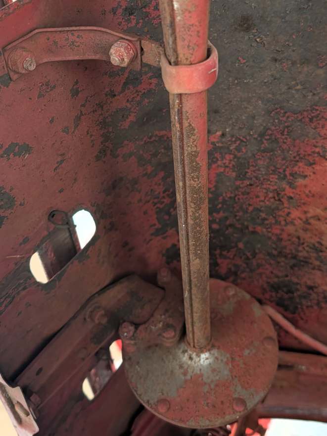

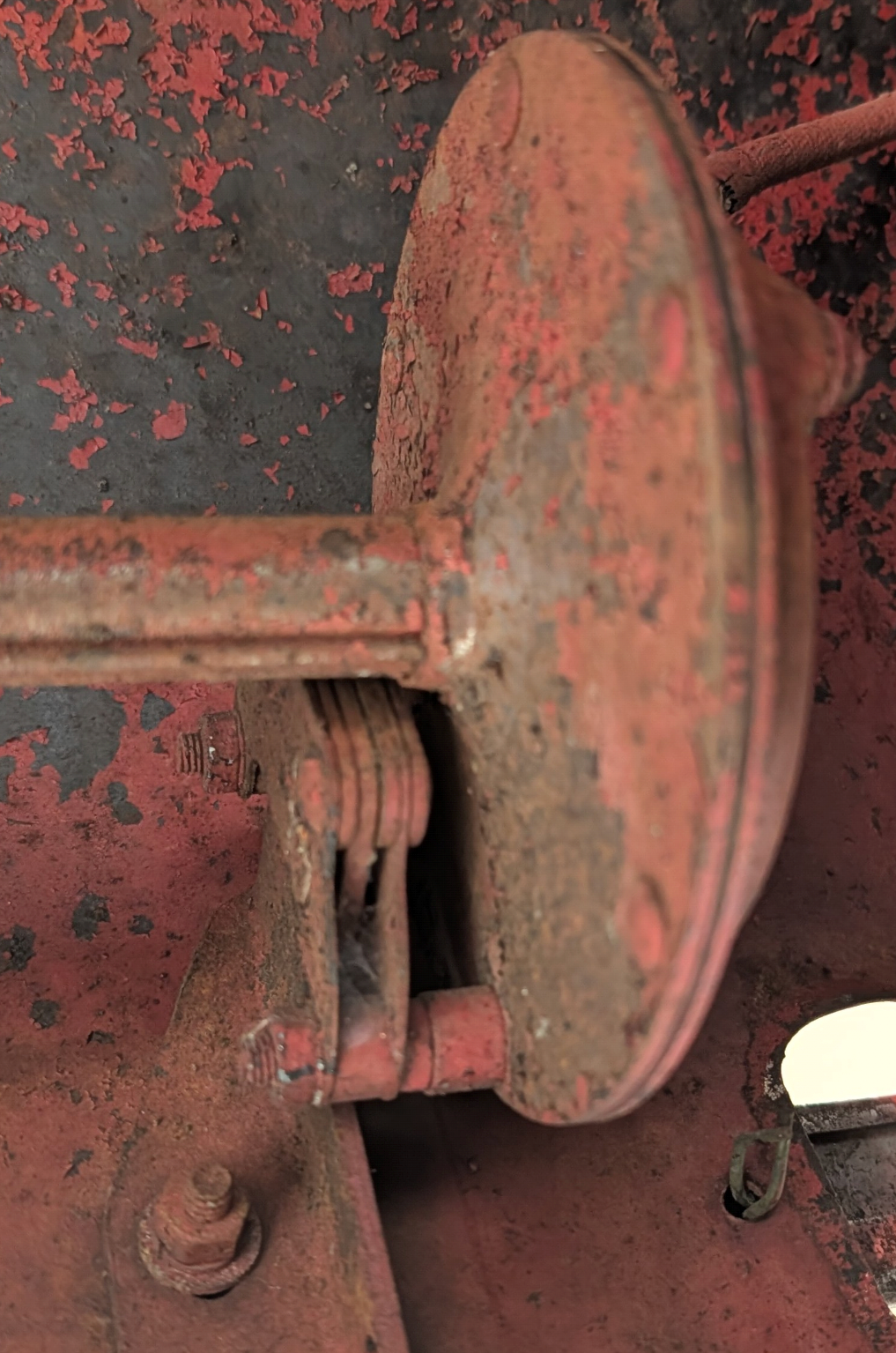

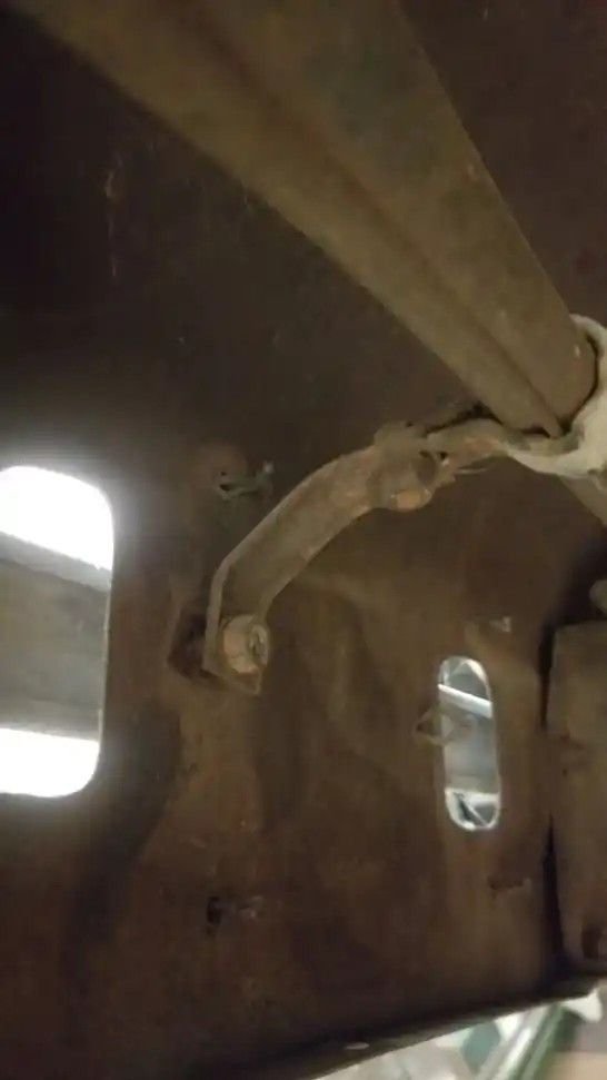

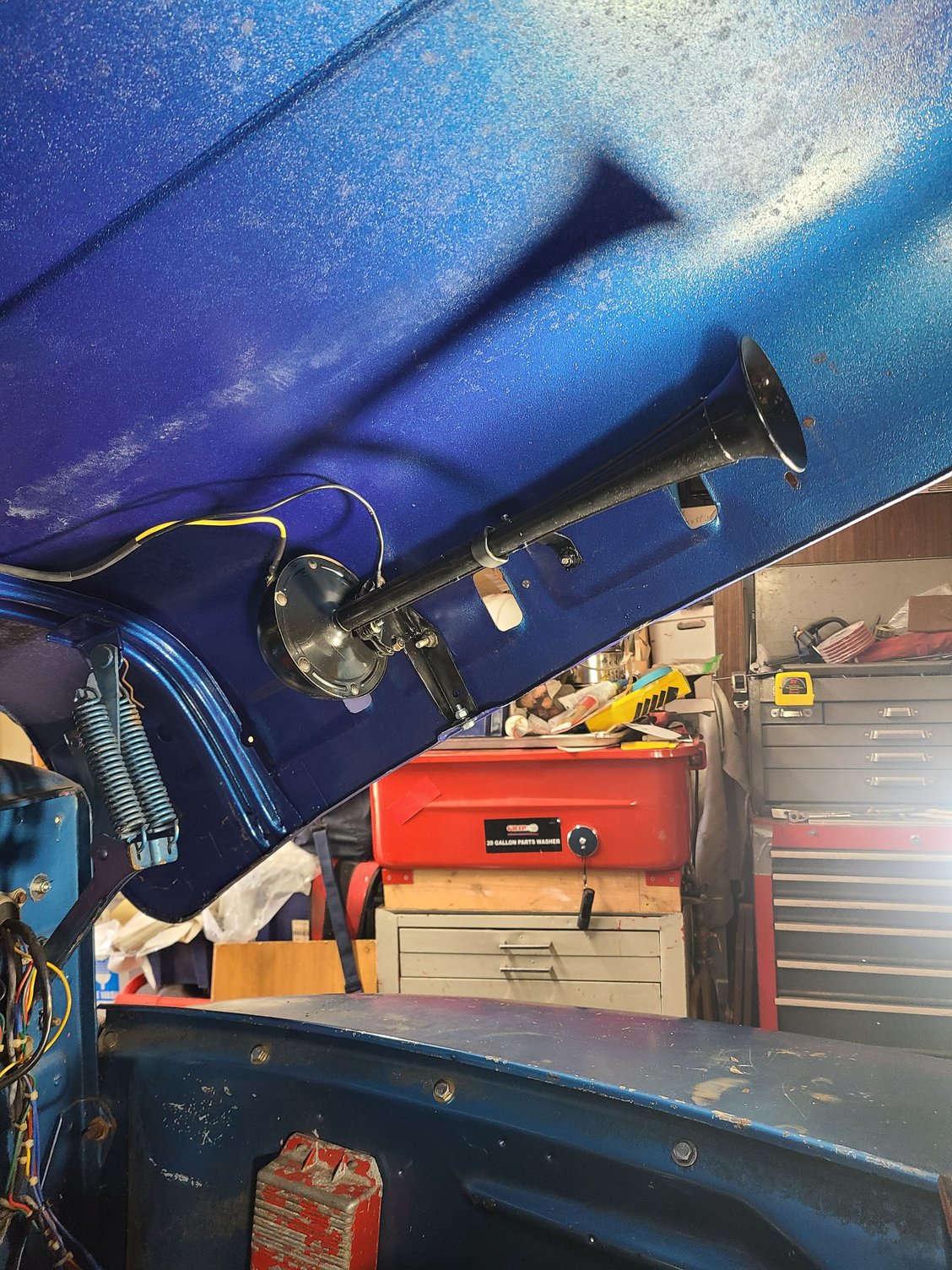

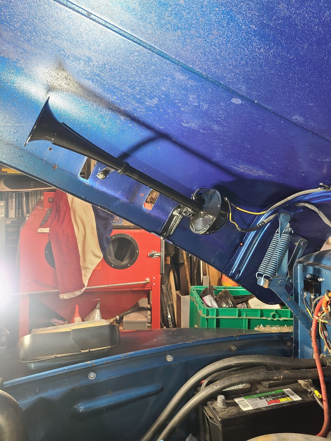

Here are some pictures from my RH (Passenger side) horn installation:

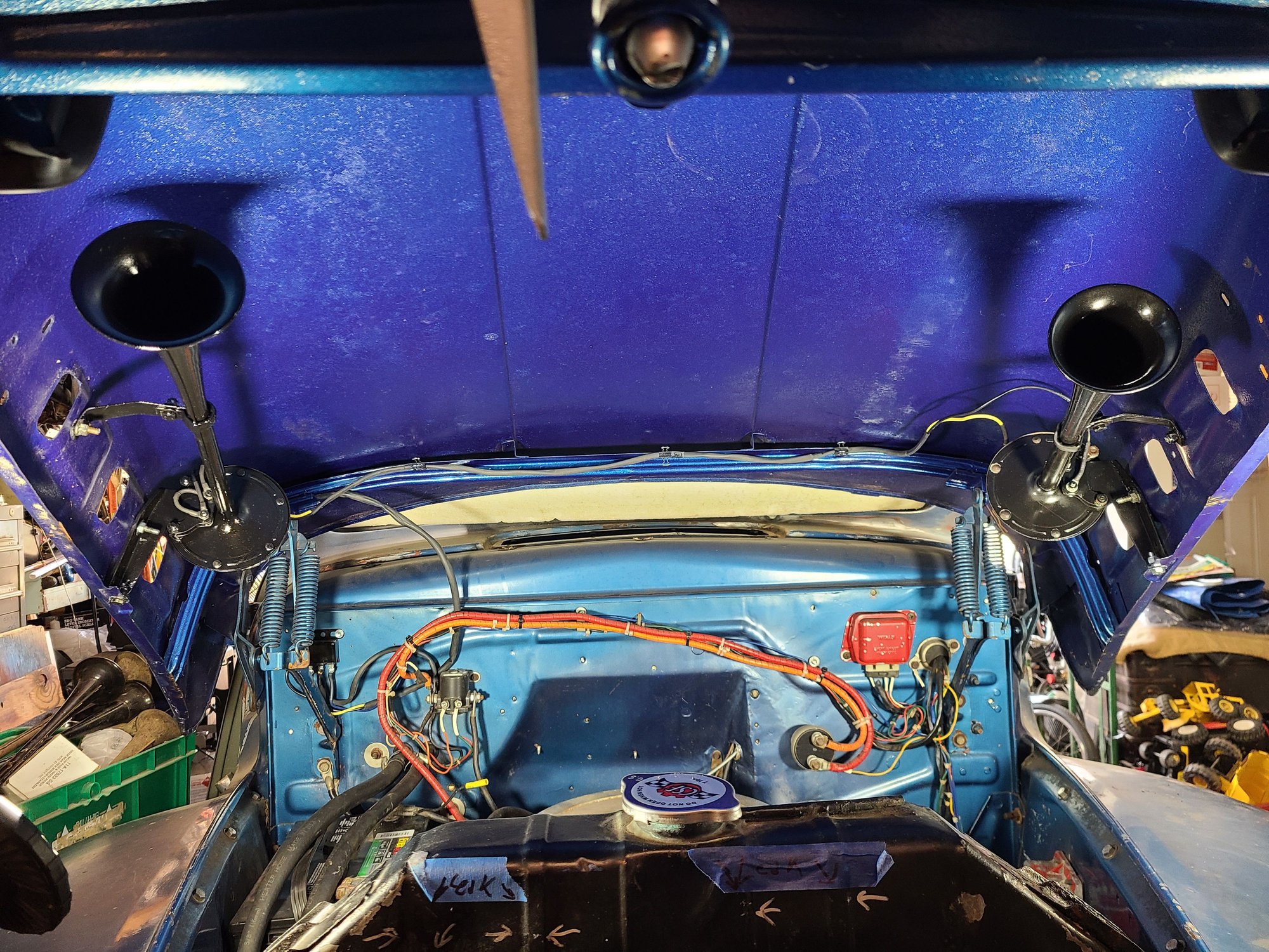

Passenger Side
Driver's Side
Now on to the next project.
Also when I went to the KY Auto Swap meet last week, I found both dual Horns for $20 bucks. Now I have an extra set.
