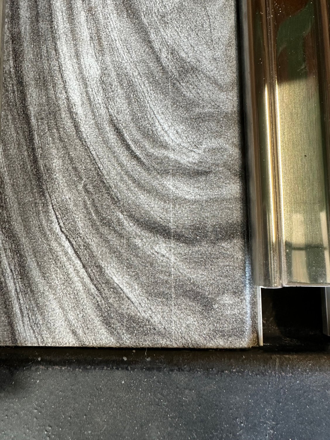

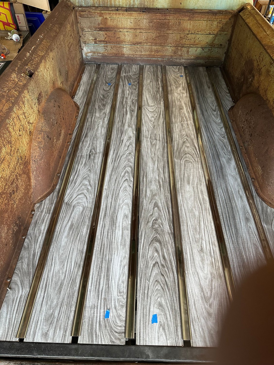

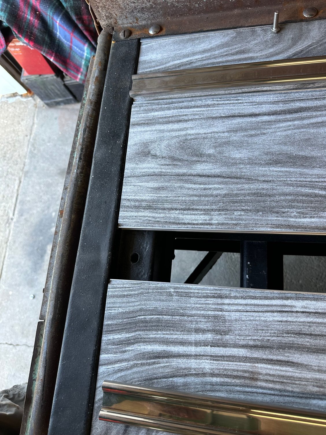

I am having some back and forth on the bed strips with the vendor I bought them from. The bed strips I got appear to be too short. There are multiple versions of the story I am getting and trying to get some clarity.
Version 1
The bed strips are slightly shorter than the full length of the bed and a filler panel was used in the end to make up the difference. I believe this is accurate for the F100.
Version 2
The F250 having the longer bed did not use a filler strip at the end of the strips and they extended the full length of the bed. This is what I expected to get.
I am being told my bed was modified and that is why there is no filler panel but I don't think it was. They said they spoke to one of the ladies from Mid Fifty who said mine was modified and I should have had a filler panel.
Here are pics with comments. Any help getting a definitive answer would be appreciated. If you need more pictures let me know.
Here is where the bed boards fit into the end of the bed support.
Close up of how it fits.
Full view including showing the bed strips being too short.

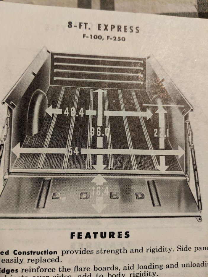

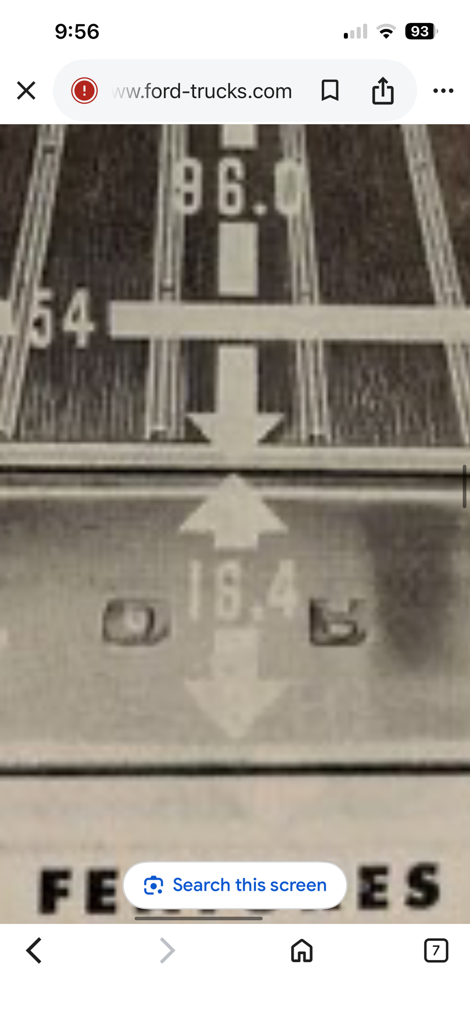

does this help you?
Old Mar 29, 2026 | 06:37 PM
8pack's Avatar
8pack
Joined: Sep 2018
Posts: 1,427
Likes: 486
Definitely!
Lets see what Kevin turns up and if anyone else weigh@Harrier do you have any information or pics?

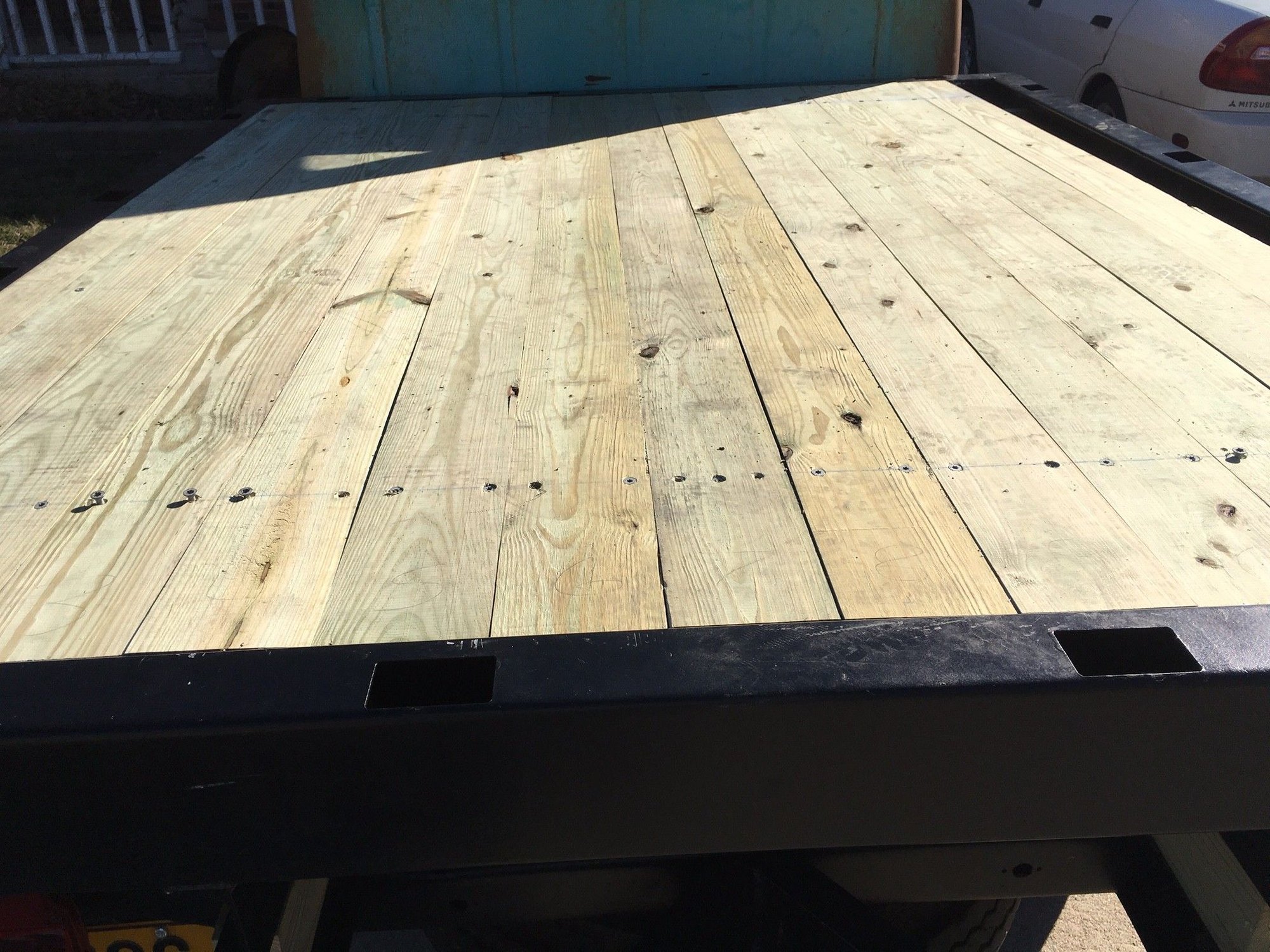

Well I can't help too much. I have a flatbed and I used tongue and groove boards.
That is what was on my original Knapheide bed.
Here is the original bed. I was dumb for not keeping it, but now I have a bed my son built so it's all good.
The boards were repurposed for a workbench.
