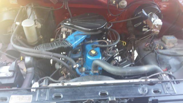

You can just make out that plastic filer under the air filter snorkel on my truck.

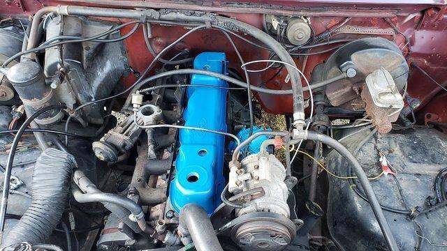

Not my truck but you can see the filer on the end of the fuel line that screws into the carb

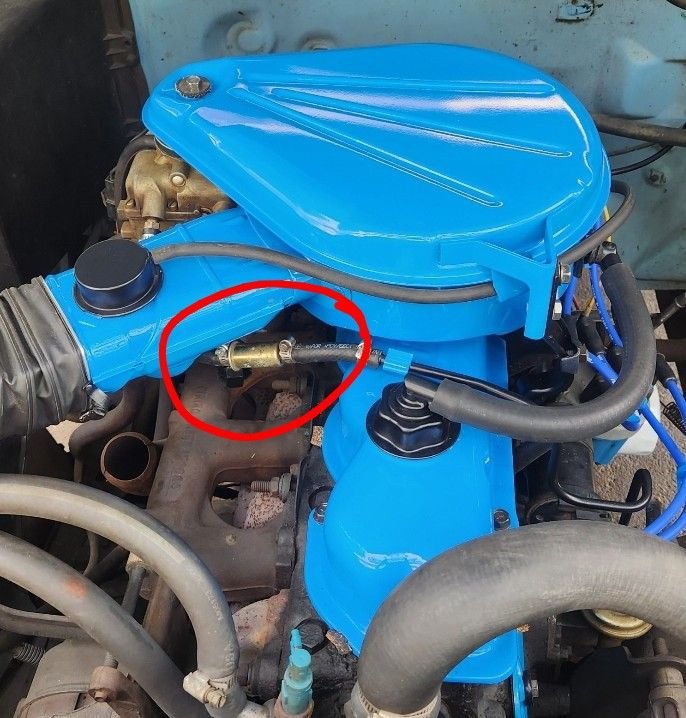

Fuzzface2,
Here's where my filter is, I don't have one threaded into my carburetor. Looking closely at the picture you posted, it looks like you have one in the same place, but it's too blurry to be sure.

Originally Posted by Doubleclutch
Here's where my filter is, I don't have one threaded into my carburetor…
No experience with the straight 6, but that certainly looks like a non-stock configuration. The part that concerns me is the filter (with potential leak points at each end) mounted directly above the exhaust manifold.
Take a look at this thread. The first post shows a metal filter that threads directly into the carb body. The other end of the filter has reverse flare threads (like a brake line) connected to a rigid metal line. I think the general idea is any potential leak points are well clear of the exhaust:
https://www.ford-trucks.com/forums/1...placement.html
Fuzzface2,
Yes I have the plastic fuel filter there and then I have the factory screw in filter at the carb.
It was just the way my truck came to me as so I kept it that way as it cant hurt anything.
I am pretty sure the plastic or metal filters the links show are less money than the one you have.
Dave ----
