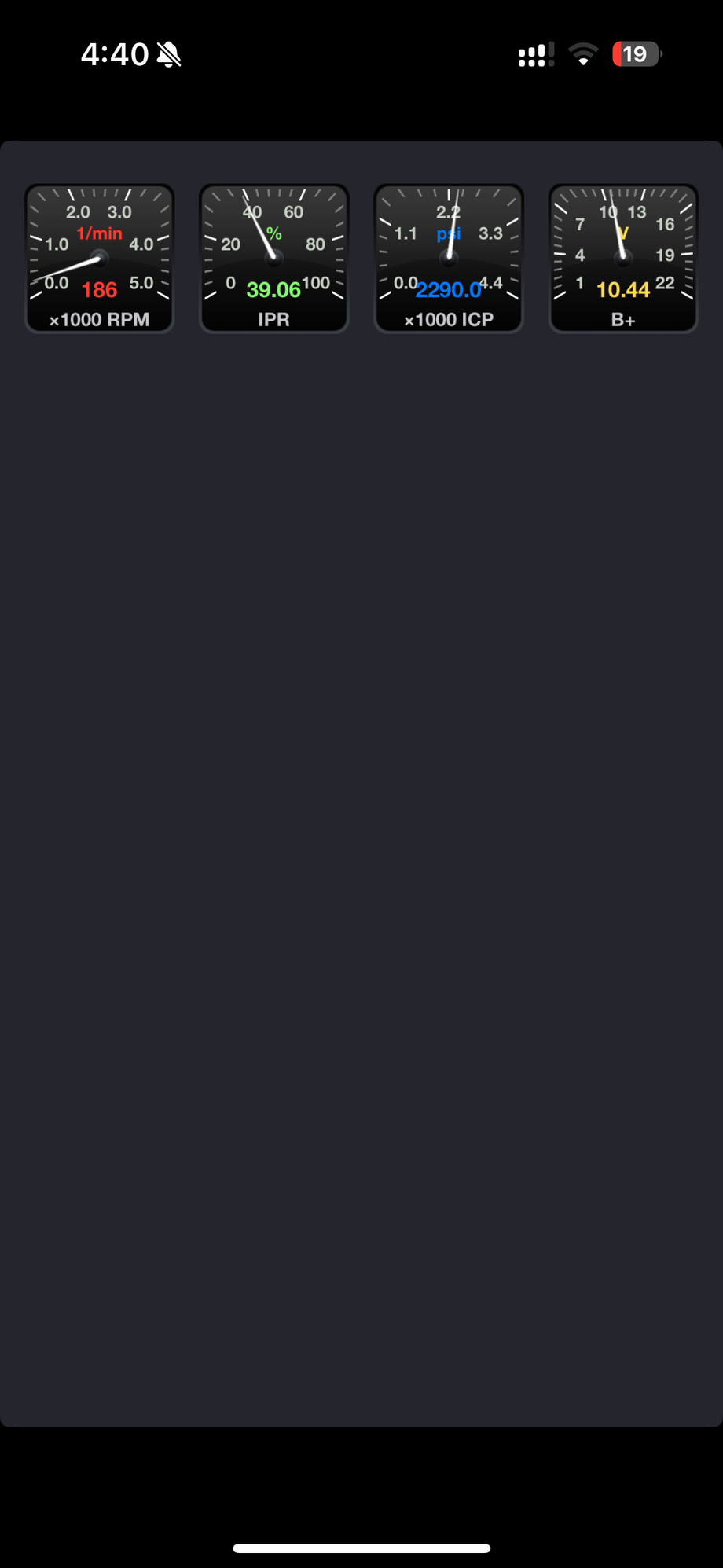

Hi I have a 2000 f550, it turns over but no start. I have no codes and I have FORScan monitor on while I crank and nothing out of the ordinary. The fuel bowl fills up. It’s full on oil I unplugged the icp check the ipr nut and no luck. I did a buzz test and it came back with no errors. I’m pretty stumped any advise would be appreciated.

It’s been about mid 50s, I have not tried the block heater, I’ll try plugging it, I’ve recently changed the glow plugs and relay a couple months ago. And I’m getting a signal at the uvch and the relay with a test light. It does puff out grey smoke while it turns over

Cranking speed may be low? Your pic has it at 186 or thereabouts. 7.3 troubleshooting flowchart says 200 rpm min for start. Could be batteries or failing starter exacerbated by the cold weather.
