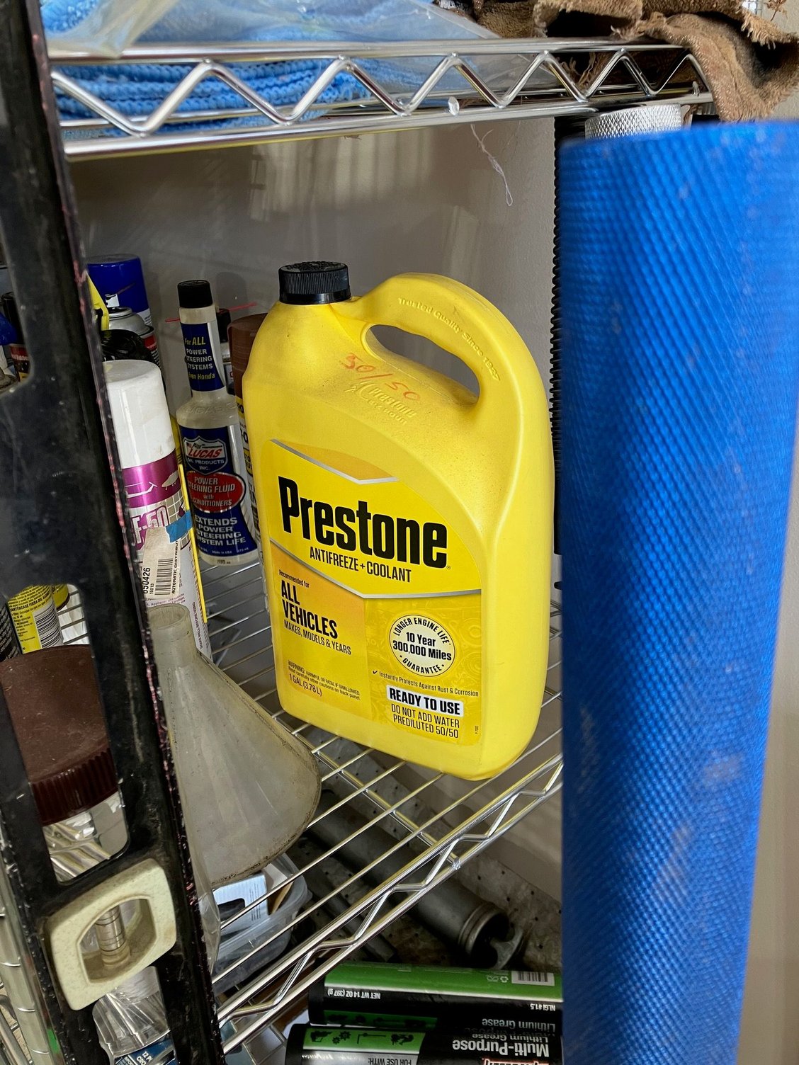

I use Prestone in everything. My 24 and 25 Subaru's and the 86 F150,

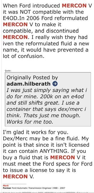

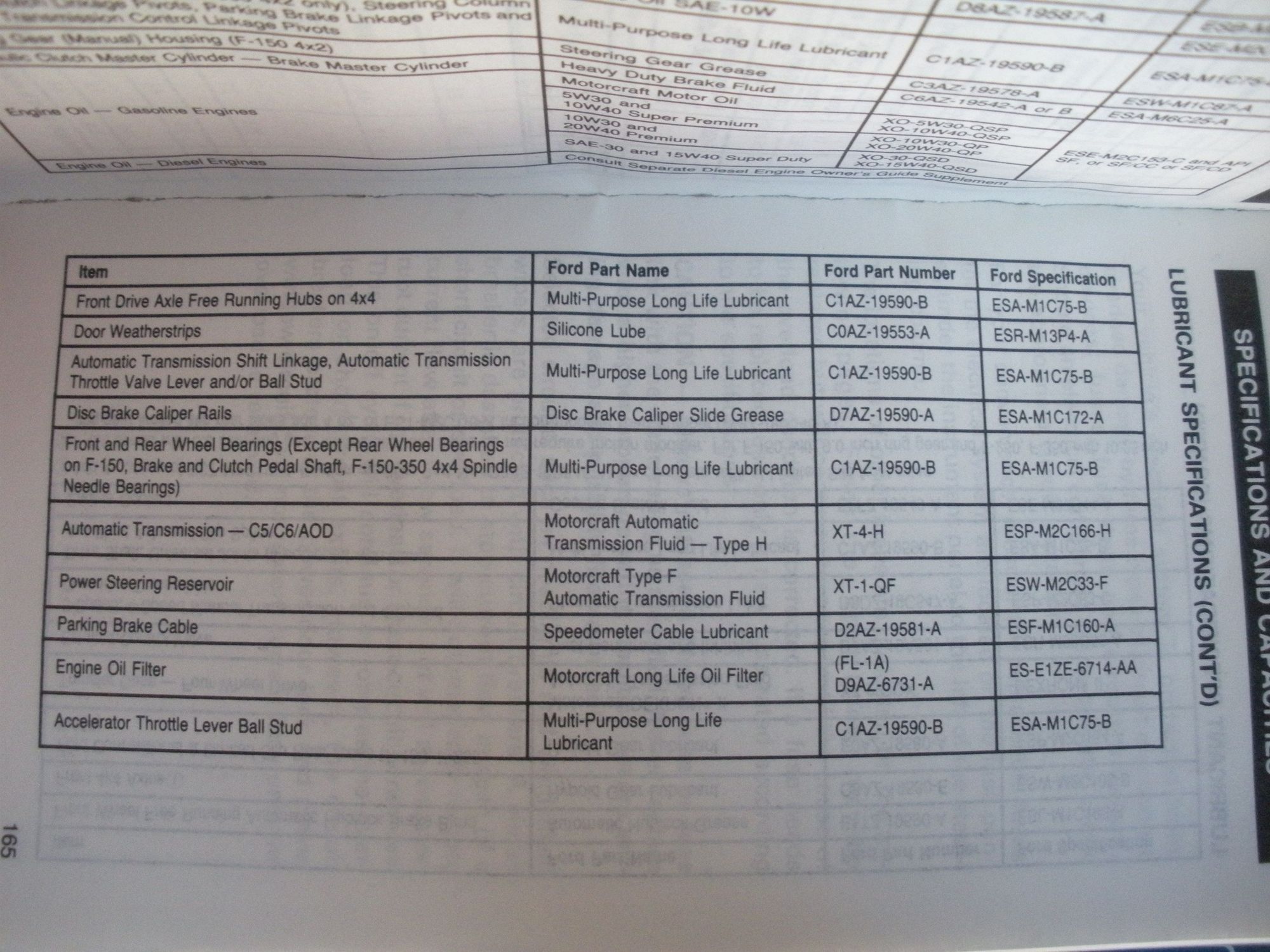

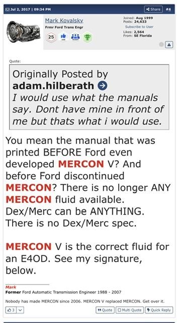

Because I said Dexron III, you said Mercon. Well, which one is it? Come to find out, they are the same thing. Most of the oil bottles say "DEX/MERC" on the bottle. I guess I should have included Mercon in my post, but I just never considered it, I have always used Dexron III or Dexron VI.
My ‘87 owner’s manual shows Dexron II as the fluid for an AOD and Motorcraft Type H (replaced by MERCON) as the recommended fluid for the C6. It’s true that you will find multi purpose ATF labeled Dexron III/ MERCON but Ford has not made MERCON in many years.
and from the same thread
Go to the Ford dealership and ask for Dexron VI as an example. I’d be willing to bet that won’t have it but will have MERCON products. Are they really the same or is that what some formulation another manufacturer has mixed together and says is ok to use? If you’re ok with using whatever that Dexron III/ MERCON formula is on the shelf that’s fine and the “confusion” is solved. Use the multipurpose stuff and move on to something else.

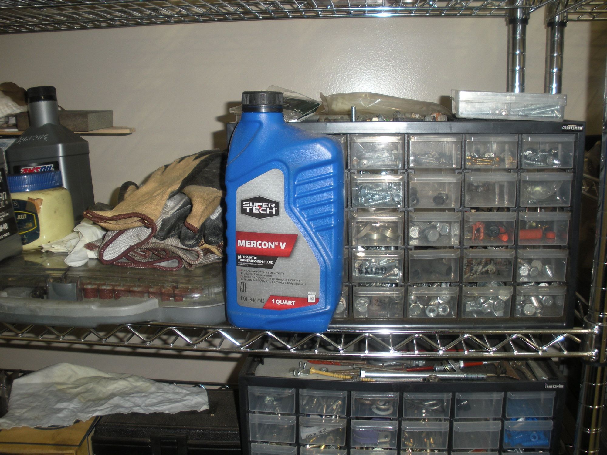

FWIW, here's the page from my 1986. I use Mercon V I get at Walmart.

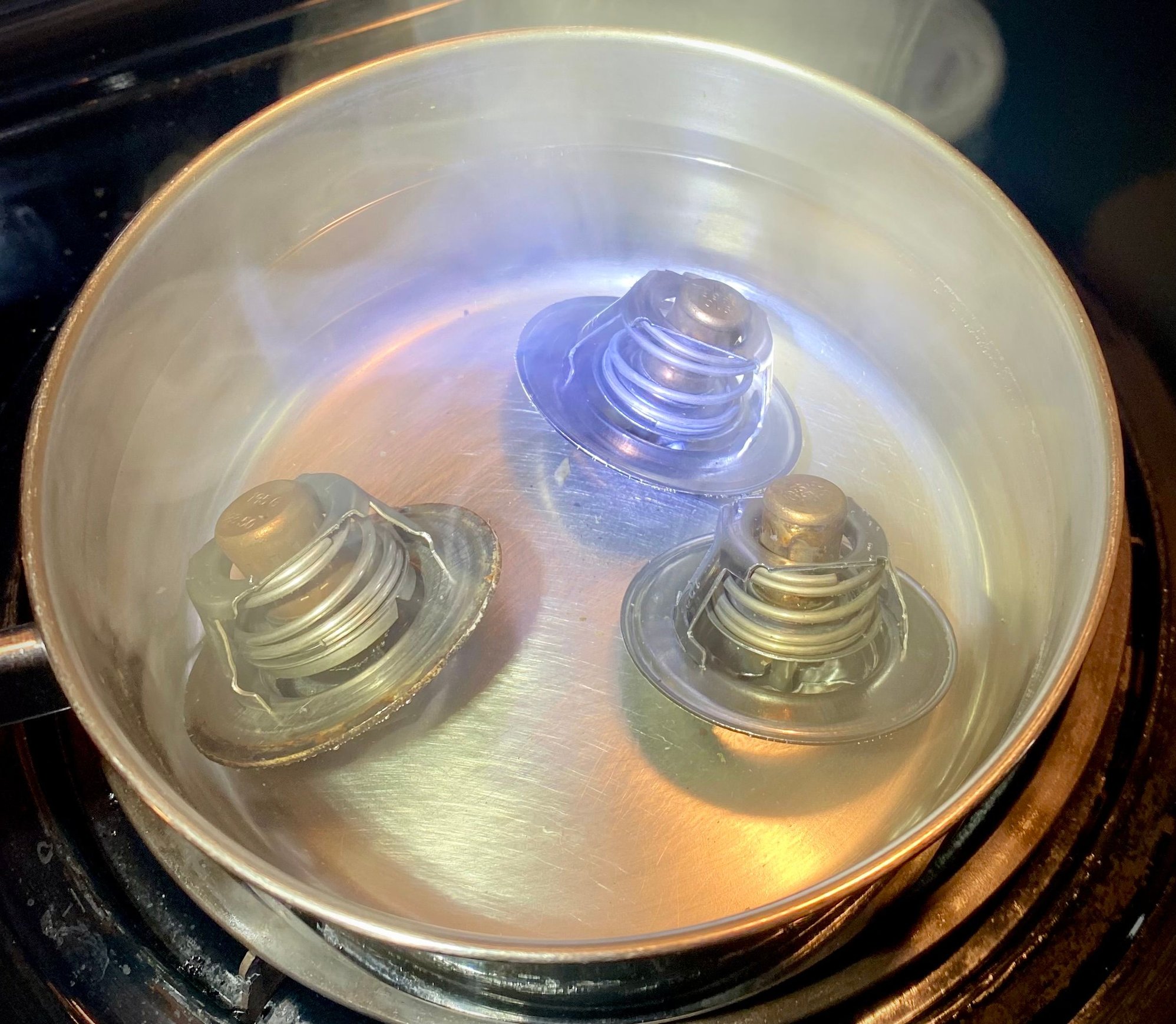

Meanwhile, not all t-stats are equal. in a race between two new ones and the old one, there was one clear winner. One of the new ones opened quickly and fully. The other one, very slow to open and only opened about half way.

Thermostats are definitely not all made the same. The first and last time I used a Stant “fail-safe” thermostat it failed within two weeks.
