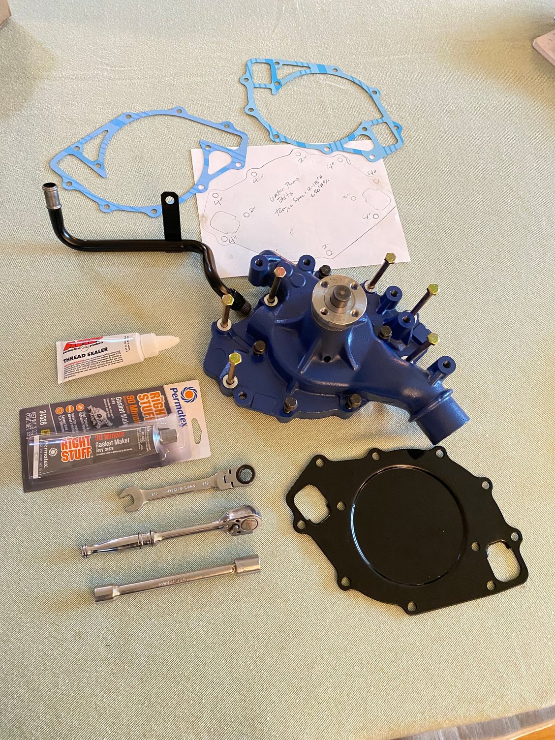

Meanwhile, it’s almost time to install the water pump. I’ve got a new Gates pump, powder coated backing plate, Felpro gasket set, new grade 8 bolts, permatex right stuff sealer for the timing cover / backing plate / water pump sandwich, and ARP thread sealer for the bolts that go through into water. I plan to trial fit the water pump and trim the intake / water pump bypass nipples just enough so that the hose between the two can be replaced in the field without disassembly.
Any other advice, tips or tricks for 460 water pump installation success?

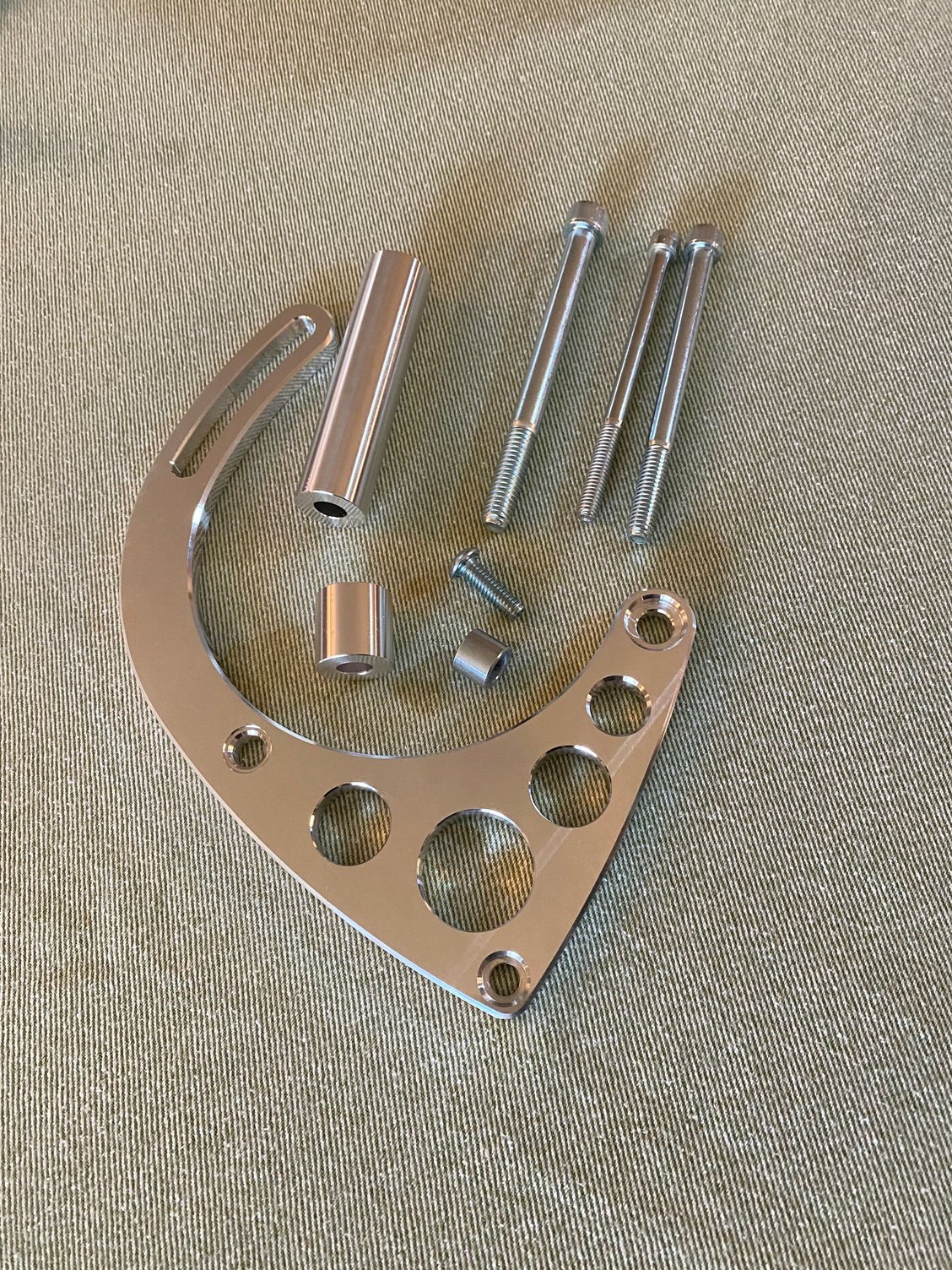

Here’s the alternator bracket. Since one of the alternator bolts attaches to the water pump, while the motor is still on the stand I’ll need to trial fit the alternator bracket, alternator, pulleys and alternator belt at the same time as the water pump to make sure everything lines up. Need to check if it’s a wet bolt since It appears the alternator bracket bolt in question may be long enough. Not real wild about the three different sized allen head bolts. I’d be tempted to replace them with regular hex heads but the allen head bolts fit into a countersink in the bracket for centering. 12 point bolts might fit the countersink, but I can’t find any to try.

Use anti-seize on all threads and the long Alt bolt

Yes, anti-seize, thank you. I should retake the photo with a can of anti-seize and a torque wrench..
However, question about the wet bolts (that go into the water jackets) —> is it okay to mix anti-seize and ARP thread sealer together, or do you need to choose one or the other?
I can't remember what I did. maybe one of the experts can answer... But, I don't think you can mix the stuff together.

Correct. Only use thread sealer for the bolts that go into coolant passages.
