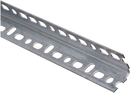

Just go to the hardware store and buy some of this to make what you need. You could make another vertical piece and then two cross pieces to make a mount for it. Paint them black and you won't see it through the grille.

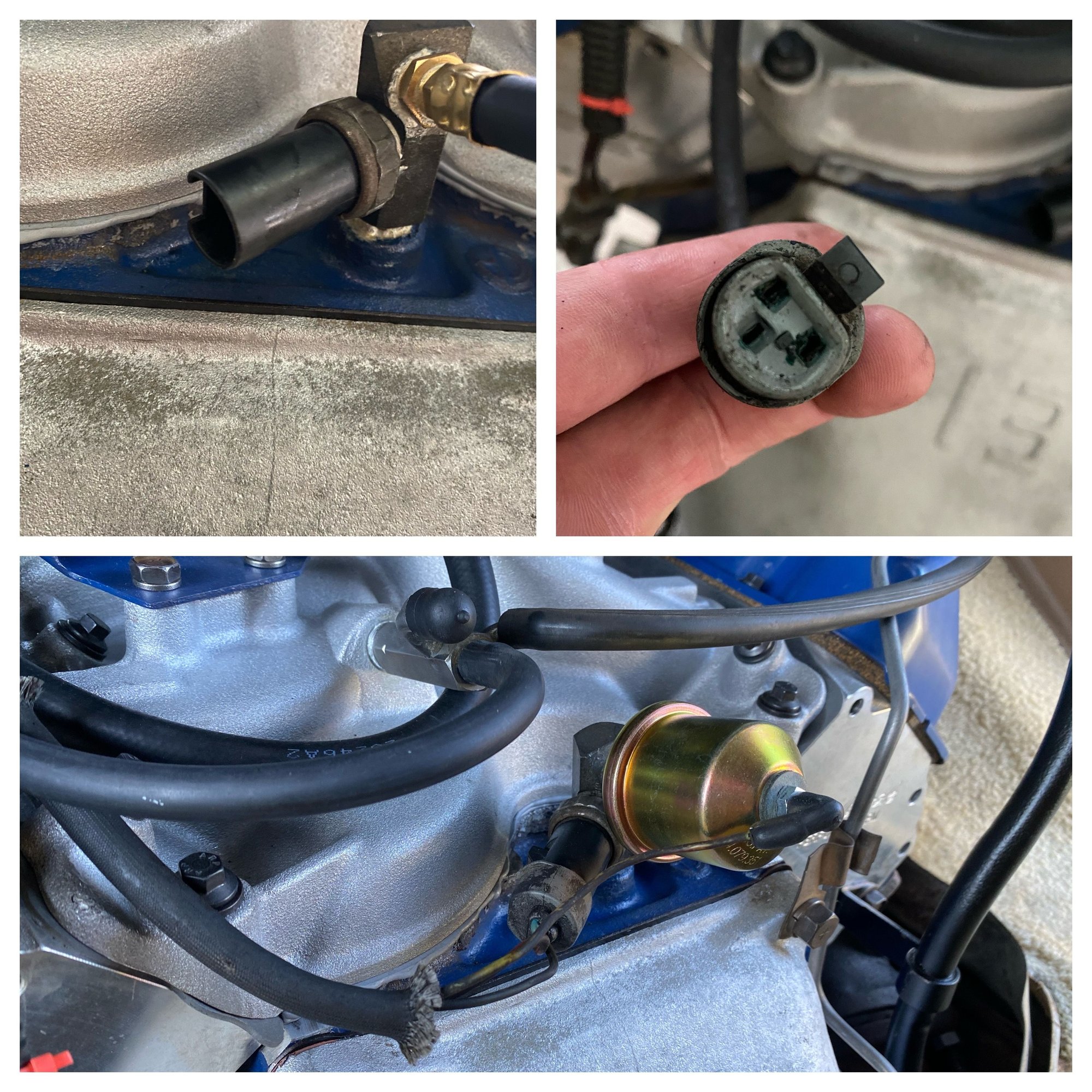

I believe the fuel pump quit because of a bad connection with the oil pressure cut off switch. I cleaned the thick old factory grease out of the connection and it’s working now, but I’d like to find a replacement oil pressure cut off switch for the parts bin. However, both NAPA and O’Rilley’s tell me my ‘86 460 doesn’t have an oil pressure cut off switch so I’m not having much luck finding a replacement. Maybe it’s called something else? In the photos you can see the switch lives just under the oil pressure sender. If anyone knows what it’s called or has an old part number I can cross reference please share

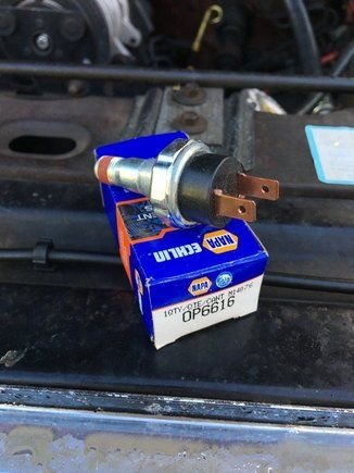

When I converted my ‘84 351W to an electric fuel pump, I used a NAPA OP6616. Would that work?:
https://www.ford-trucks.com/forums/1...tallation.html
It has 1/8” pipe threads and two 1/4” spade terminals.

Thank you all so much for the oil pressure switch ideas. I don’t know why the old stock plug and switch have three pins, but there are only two wires going to it. so it should be simple enough to cut off the old plug and crimp on spade connectors if i want to run a new two terminal switch.

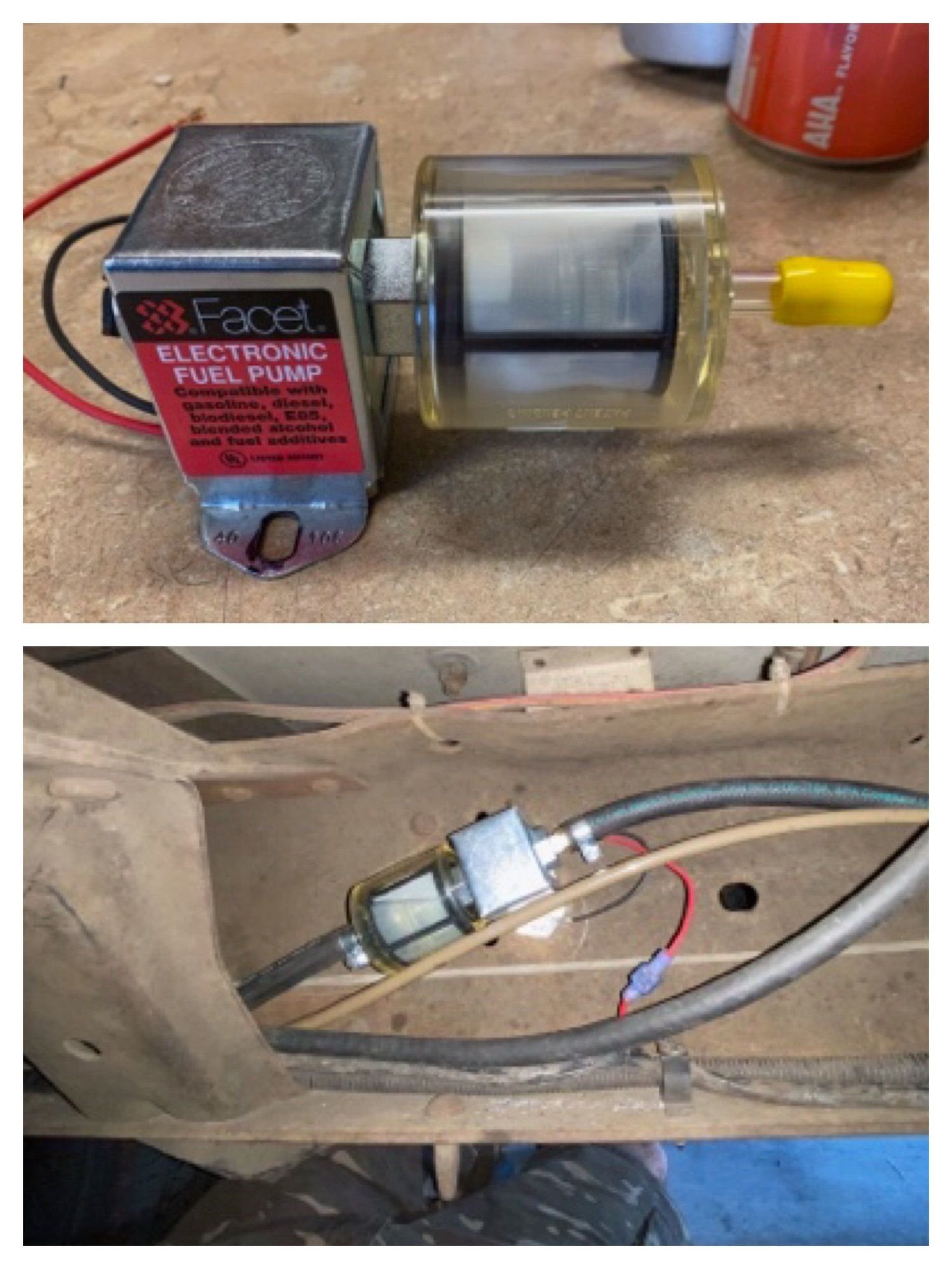

Meanwhile, new problem. I’m running out of gas trying to pull past 3k rpms. Feels like it’s running out of gas just as the secondaries open. The secondary float level is good and the linkage isn’t binding so I’ve come to suspect the 32 GPH rated external electric Facet 40106 cube style fuel pump that I’m running isn’t keeping up with the 750 cfm carb and 460 motor. It seemed small for the job when I installed it about 4 years ago, but it was good enough. until now.
I’ve been running the old stock fuel return, but thinking now I’ll need to step up to a higher capacity fuel pump and proper fuel pressure regulator. Open to any suggestions you might have.

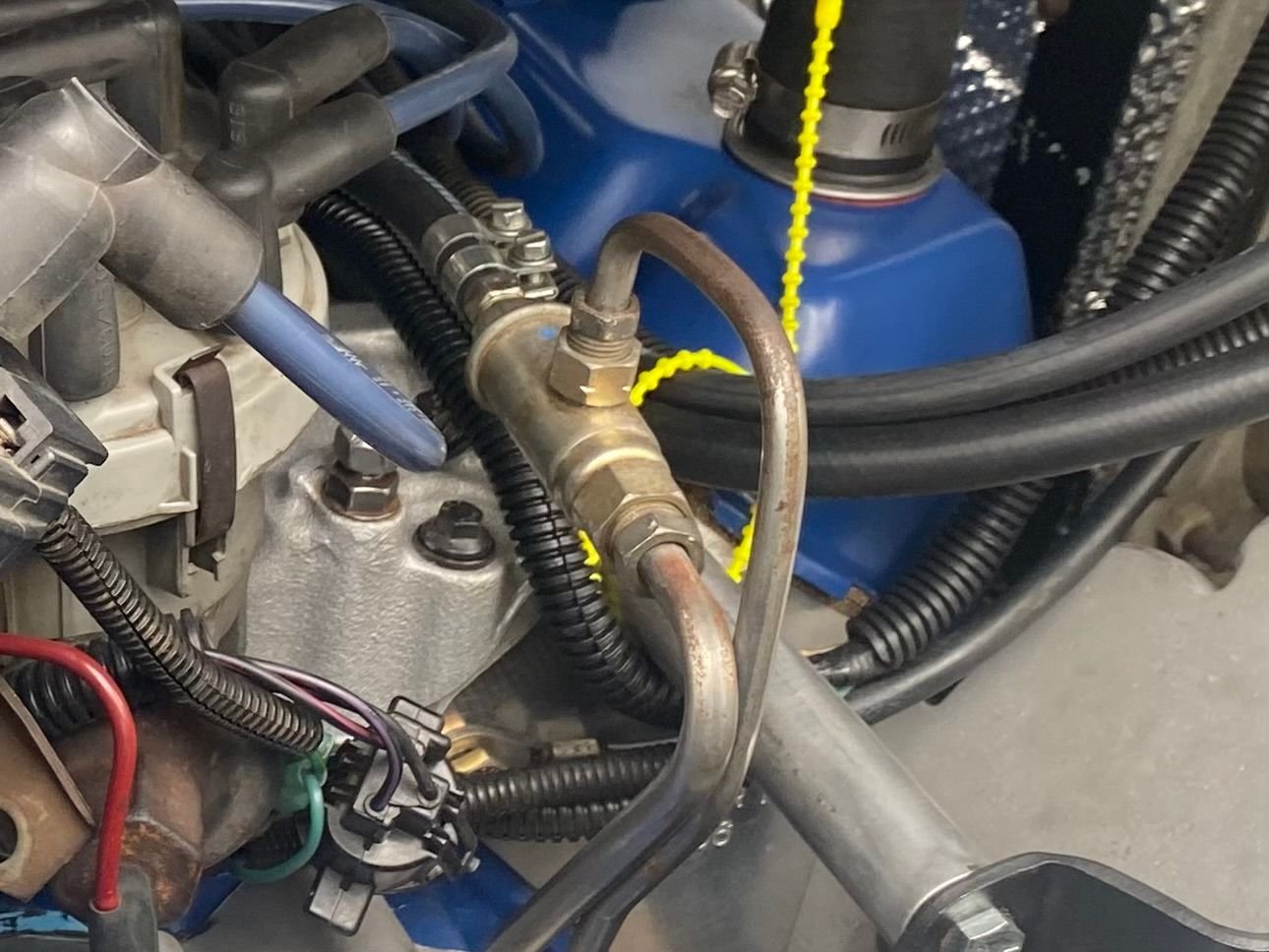

Thank you. I’ve got the old stock hot “fuel vapor separator valve” fuel return unit on there now. here’s a pic. As i recall they came in different orifice sizes. It’s been a long time ago, but I bought the one you see in the pic direct from Ford. It has a blue dot which means small return orifice.

Update, I replaced the little Facet cube fuel pump with a Quick Fuel 30-105QFT. I think that will take care of any fuel starvation issues. Next up get the AC running again. I think I’ll start a new thread for that.
