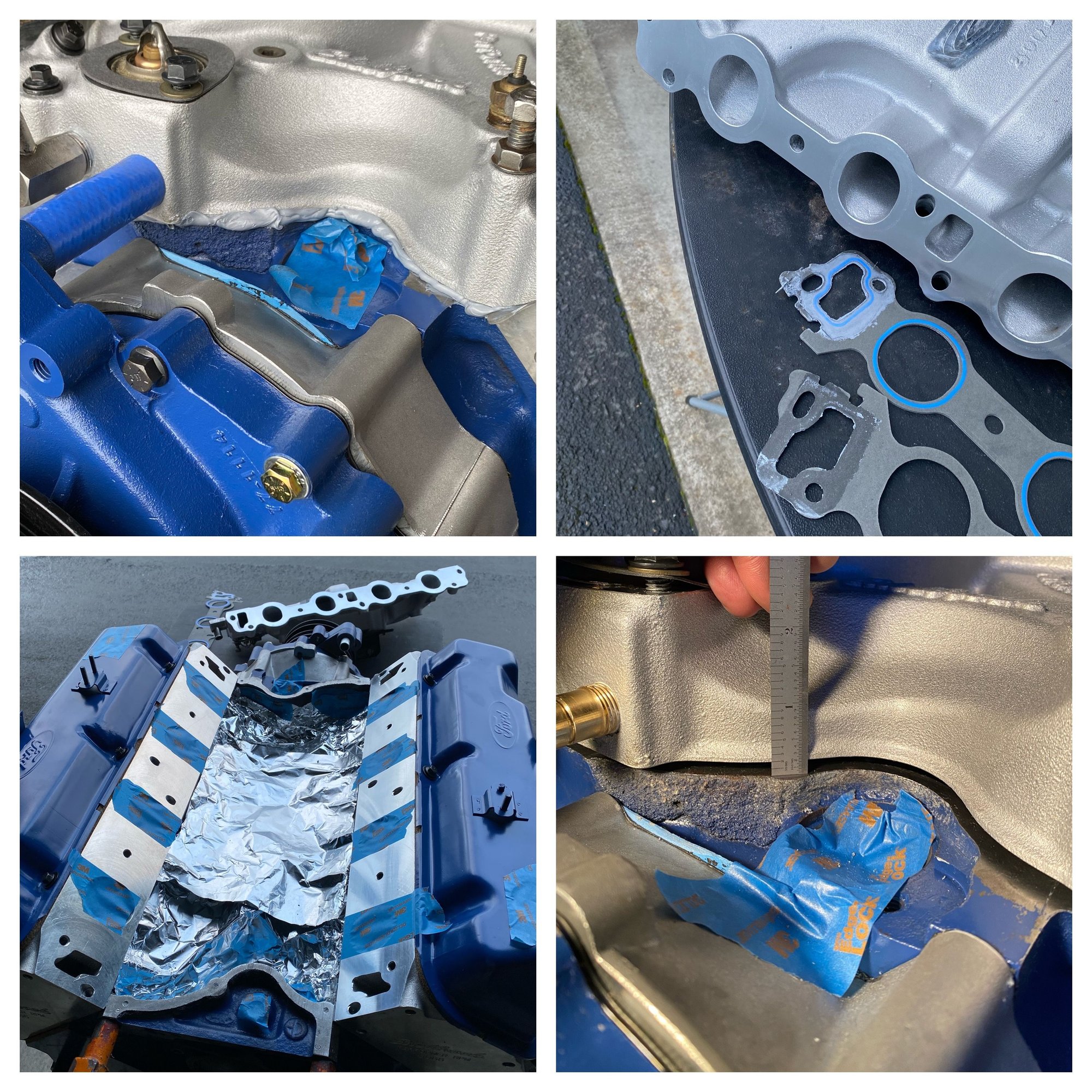

At the risk of getting kicked off this forum for shoddy workmanship, here’s some shots of my end seal fiasco. On the top left you can see the ugly, and I must apologize to my 3 yr old grandson because in hindsight I think he would have done a better of it job than me. As mentioned earlier, my bead was too small to begin with so I added more. So much more that the grey 90 min right stuff was still very gooey and uncured in the center after 24 hours, making me question if this grey 90 min right stuff is truly the right hack for this application.
Looking at the gaskets, The black side goes against the heads and the side with the blue circles goes against the intake. I skimmed the heads with right stuff and then I skimmed the intake side of the gasket before putting the gaskets in place. Now when I took it apart the right stuff was stuck to the head, with very little stuck to the head side of the gasket. Meanwhile, all the right stuff stayed on the intake side of the gasket and none of it stuck to the intake itself. Maybe my “skim” was too thin, or it dried out too much while I was busy adding excessive amounts of RTV to the end seals.
Anyway, spent Sunday cleaning up the mess I made and running down new gaskets and more RTV for a second attempt. One thing I’ve tried to pass on to my kids is to never argue for your limitations, and telling yourself “I can’t do it ” or “I’m not good at” something is defeatist and self limiting and should be avoided. That said, I will quietly admit that I’m not afraid to take on most anything, but when it comes to to caulking doors, windows, or bath I pretty much call in my son in laws or just about anyone else.. because I’m terrible when it comes to laying down beads of sticky gooey stuff and making it look good. So trying to fill this .2” gap using RTV is playing to my weakness.

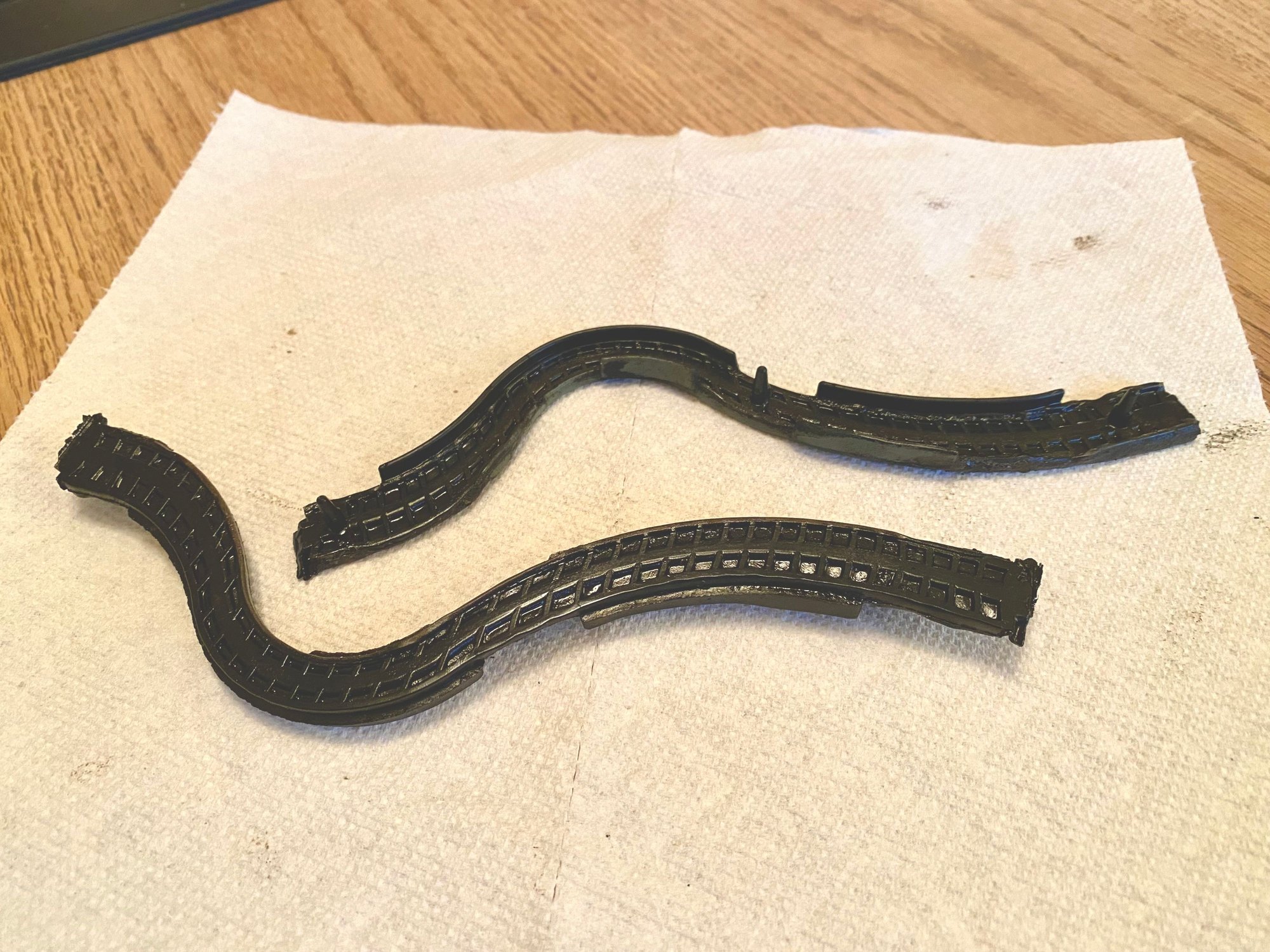

I’ve included a shot of the stock 40 year old Ford end gaskets that were in place and working fine when I tore it down. They straddle the china walls like a saddle and have locating pins to fit the holes provided in the china walls. If these come in that $100 Mahle intake gasket set it may be worth the price just to get the end seals and throw the rest of the kit way in favor of the Fel-Pro 1230 side gaskets.

RTV has a shelf life. If it is old, it will not cure completely or take a long time. If I am to use it, I always go buy it new. I've been burn before trying to cheap out and gamble with some old stuff, never again.

Well you know the gap is .25 and that is good so you know how much to use for the end seals.
I think the other problem was you used right stuff on the intake gaskets and if anything use spray tack on the non-blue side of the gasket but I would not use anything on it.
Do use a little RTV in the corners of the heads / block, just run the end gasket RTV a little farther.
Let the RVT skim over but dont worry about it being gooey in the middle.
Now before you ran the beads of RVT you must clean the block and intake with carb or brake cleaner.
Done that way and the way I would do it I dont think you will have any problems.

I’ve always eyeballed how much to use.
I also do not put anything on the gaskets except for the valley pan on the AMC 304 because it said to put some around the water ports in the instructions. That bead around the ports is supposed to crush when the bolts are torqued to seal.
Yes If using RTV or the china wall gaskets, RTV should be placed at the corner where the block and heads meet. Cleanliness is the key.

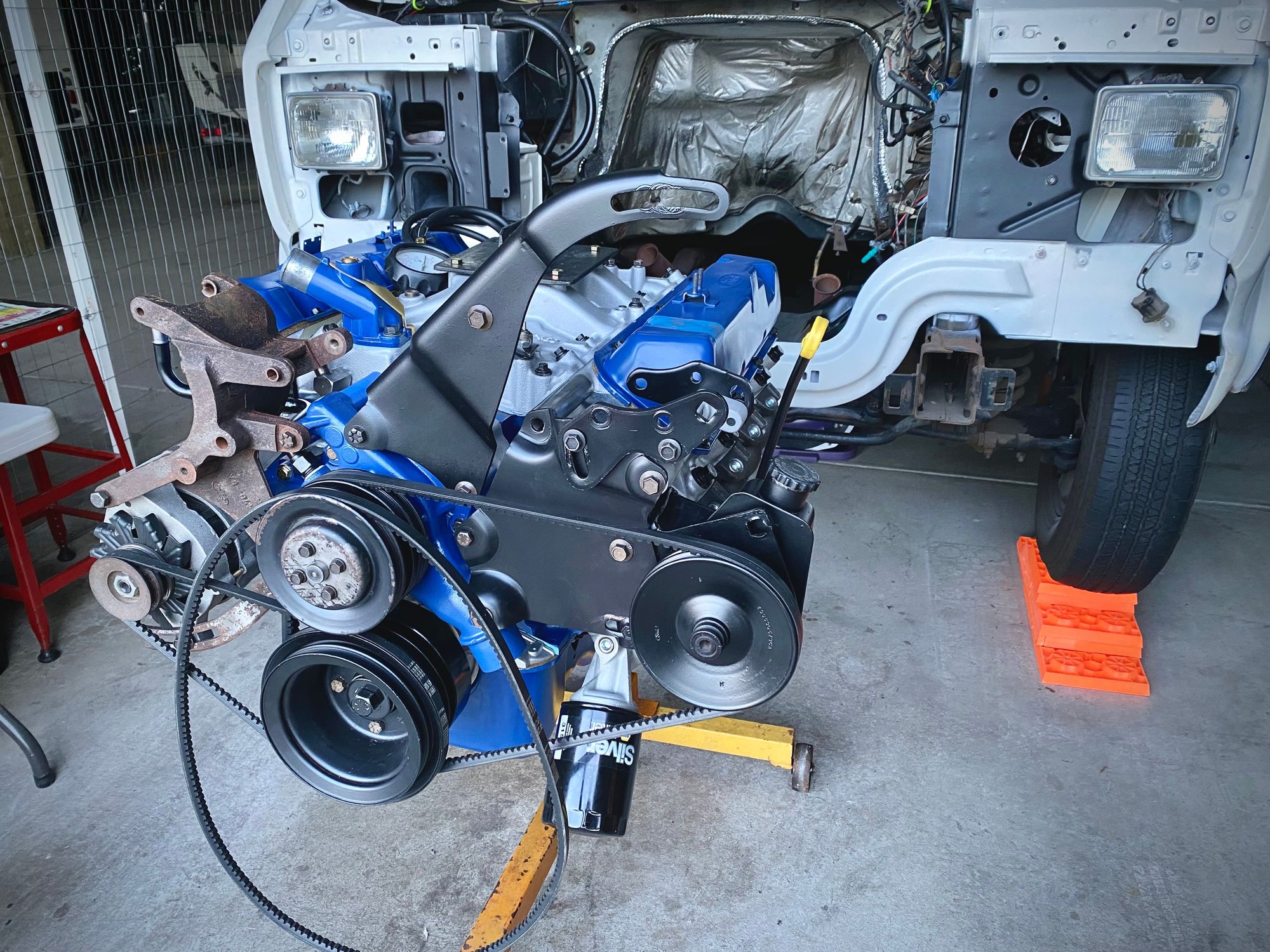

Update time: Dress rehearsal
Got the brackets and hardware sorted out and checked the pulley alignment on the stand. One of the 6” long bolts that goes through the brackets into the head is too big so i need to get a smaller diameter one, I need to grind a little bit of clearance out of that tall adjustment bracket for the new AC compressor, and the alternator bracket needs to be cleaned and painted too since i’ll be running it after all.
Next steps, remove brackets, prime oil system, install dizzy, install motor, and mate it to the transmission.
