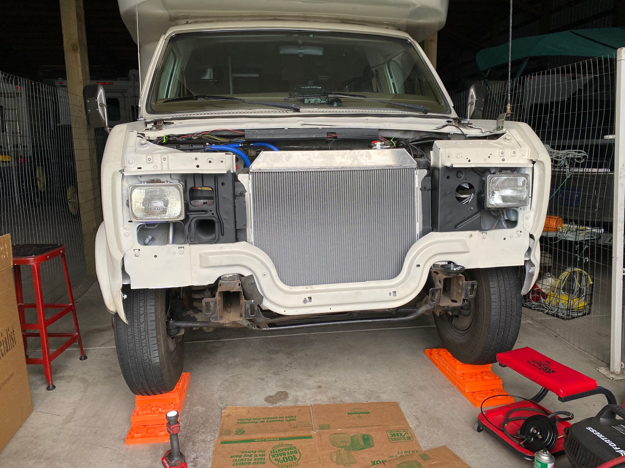

It’s pretty much down to carb linkage and mounting the trans cooler. And for the record, I don’t care what all the books say, a 23” throttle cable doesn’t fit a ‘86 E350 with 460. The bend is too tight. You need a 31” cable which is harder to find. And don’t waste money on the Ford downshift kit that Holley sells, the new 4160 won’t work with the stock C6 downshift linkage anyway. Save your money for a cable style downshift retrofit kit.
Fortunately I can live without the downshift hooked up and the 31” throttle cable is on order. However i need advice on mounting the trans cooler. I’ve seen solutions where you stick zip ties though the fins of the condenser but not sure if that’s really such a good idea?
In the photo you can see a black vertical brace for the grille and the stock transmission cooler was mounted to it. Since the holes to install a second one on the driver side are there, I’d like to find another one so I can mount the cooler on brackets between them, but I don’t know what to call it for a successful search.
Appreciate any advice on the subject you can share.
