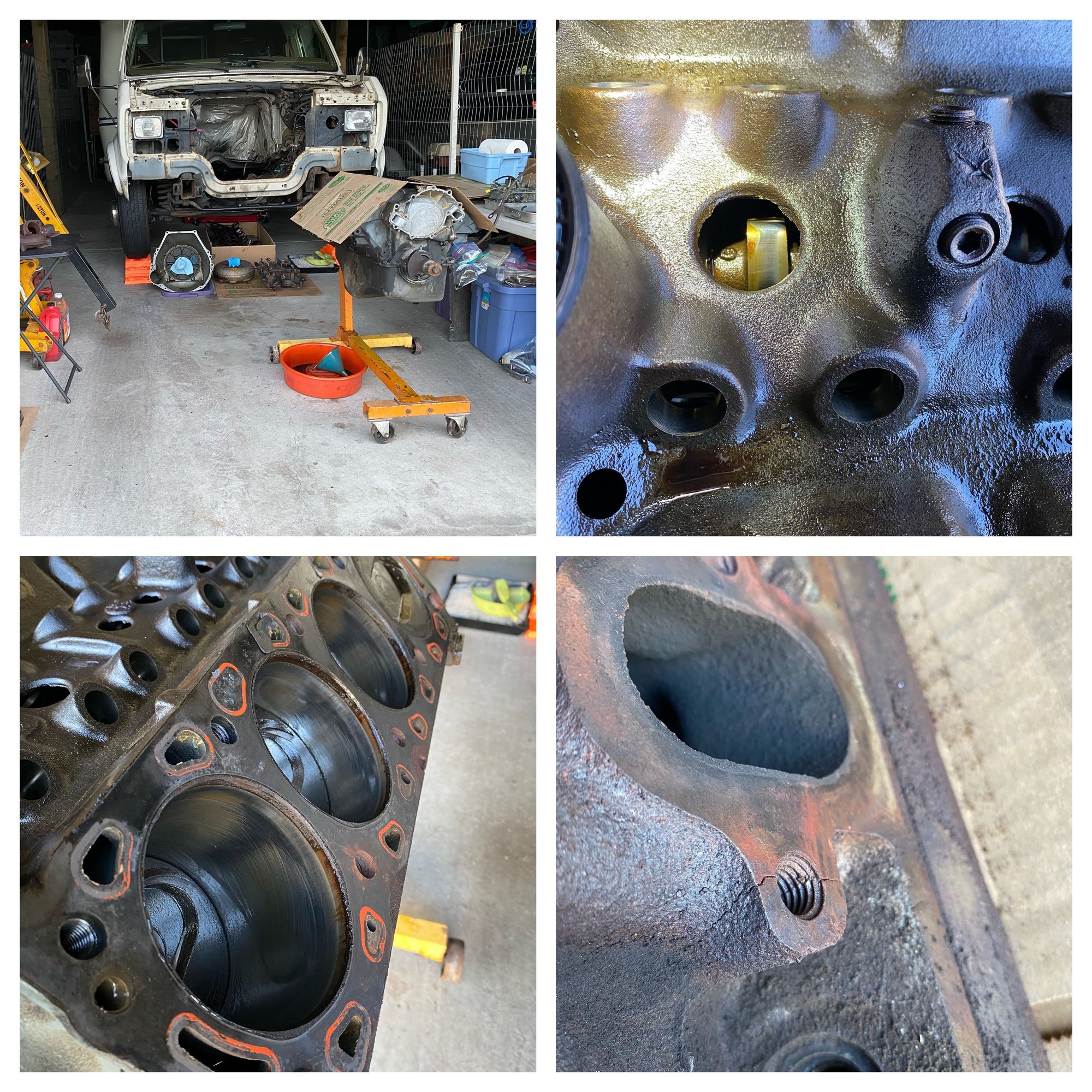

Update time.
I didn’t try it, but no way the motor and transmission could come out as a unit. Fortunately I was able to use a fancy transmission jack with an adjustable table that made pulling the transmission a relative breeze. Line up the table to just the right tilt angle, ratchet strap the trans to the jack, and wiggle wiggle, no binding and it’s off.. Sweet.
Not so sweet is the tole of broken bolts. Both of the steel bolts that hold the rear transmission mount to the aluminum tail shaft housing were seized, and no amount of soaking in liquid wrench, acetone and ATF, and as much heat as I could apply to it laying under the vehicle made any difference. Eventually it came down to make it or break it, so break it it was. Both have enough of a nub sticking out to weld on a nut, hopefully the heat from the welding with break them loose.
As for the heads, 4 exhaust manifold bolts were already broken off before I touched it, 2 more snapped off like rotten twigs with virtually zero torque applied, and two more felt like they were wiggling… before breaking off. So 8 of 16 exhaust bolts are broken off in the heads (6 are recessed and 2 are sticking out), and one of the heads is cracked at the exhaust manifold bolt hole. So all of this is leaning me toward the $300 pair of DOVE heads the machinist has for sale, or just maybe a set of fancy Eidelbrock performer aluminum heads!
As for the head bolts, I’m guessing Ford installed them dry back in the day since a couple of them came out very rusty. One was especially gnarly and I feel fortunate to have worked it out without breaking it, and that the threads in the block look okay.
Otherwise the lifter faces look great, but there is some wear on the cam. Overall the cylinder bores still show excellent crosshatching with no significant vertical scratching. However, both sides of each cylinder shows wear as you can see in the photo… so I’m wondering if the thrust bearing has excessive play? which can’t be good for the rod bearings. Curious to know your thoughts.
Next step is to remove the oil pan, flip the motor over, and inspect the bottom end.

Easy enough to check the crank end play. Go to harbor freight and get a dial indicator, and take a screwdriver and pry the crank back and forth while reading the indicator. Then look up the spec in the book. If this engine was hooked to a automatic, having too much end play would be a rare problem.
Nah, a little JB Weld and you'll be good to go!
Nice work! That's gettin' it done!
