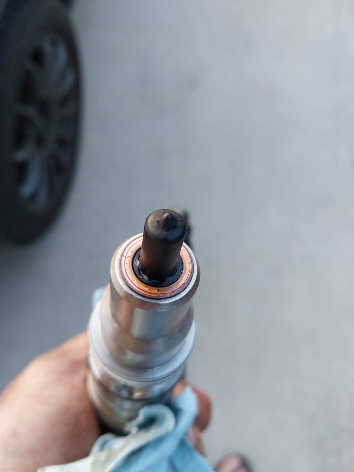

I have been gifted a p0269. Symptoms are slight haze at idle, I wouldn't call it a rough idle but it's not smooth, pretty much a cylinder miss, the more fuel applied the more smoke exhausted, power loss but not even noticeable.
I didn't realize i had a problem until I got off the interstate after a hour and fifteen minute run. I noticed black smoke pulling out from a stop light. My wife who was following me, informed me that it was smoking the whole trip. Note it wasn't enough smoke for me to notice it in the side view mirror while driving.
So far I've tried to clear the code. It comes back of course. I listened to the compression using the starter wire and it sounds perfectly fine. I unplugged the vacuum pump and listened to the injector clatter on start up, nice even sound. I checked for blow by from the oil filler neck, it looks fine too.
About to swap injectors around.

Pulled the suspect injector yesterday. Number 3 cylinder. Plan to swap it with Number 1 after work today

Finished swapping injectors 1 and 3. The code moved to cylinder #1.

Injector replaced. No more codes as of now. No miss fire or black smoke. Have an extended crank at the moment. VGT was at 85% because I forgot to connect the map sensor hose.
I wonder why an injector would fail within 25k miles. Injector buzz always sounds perfect. Ficm have never been below 46.5v, FLP 13.5, and FVP 14. Fuel pressure has never seen below 55 psi. Hpop around 600 to 700 at idle, over 3k wot. I do oil changes at 10k and the lab says it would be fine to run more than that. I use T6. I drive 1.5 miles to work and back everyday. Weekly 1.25 hr drive at interstate speeds. Fuel filters were done last oil change. I do 2oz of hot shots diesel treatment with about 75% of my refuels. Zero oil additives.
