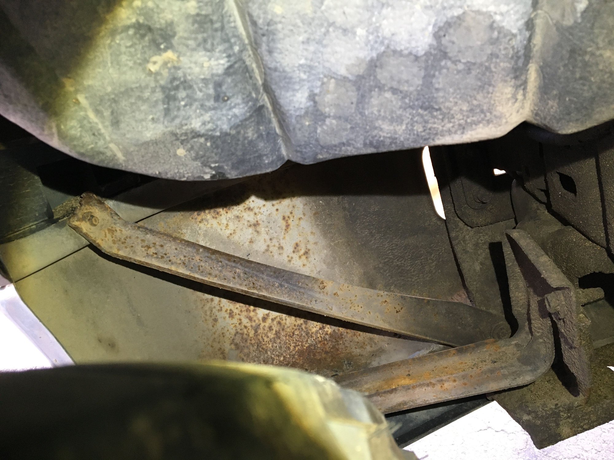

Originally Posted by JJF20
Not many left on the forums anymore.
This is my ‘06.
Thanks Jeff!! Really appreciate the help and pictures. Is there some sort of spacer between the bracket and the truck frame itself? I have looked and looked at the FORD diagrams to see what I'm missing but cannot see a spacer.....
Old Aug 19, 2025 | 12:13 PM
Brotherbillstruck's Avatar
Brotherbillstruck
Joined: Dec 2012
Posts: 538
Likes: 151
From: Warsaw KY
This is my 2006. No spacers.
Thanks again Jeff!! It looks like there is a secondary bracket on yours. It looks like it may be welded to the frame too. THIS is the piece I'm lacking and guessing that if it is indeed welded to the frame it wouldn't be included in the bumper brackets & hardware I'm looking at through Ford.

It appears from those pictures , the 2 brackets do not bolt to the frame ?
Whatever the kind of Z shaped thing is that holds the J nut that the bolt goes into is what I'm missing/don't have-I can't quite see how this Z shaped piece is attached.
Is the bottom of that Z shaped bracket (in your picture) not welded to the frame? (Thats what it looks like to me...)

My frame has been oil sprayed, and now covered in a layer of dirt as well, but I’ll see if I can get some pics of it from different angles.

Here, these might help.

That's the lower "Bull Bar" to prevent animals (people) from getting dragged under in a pedestrian strike. How effective it is can be questionable.
Bolt in.
