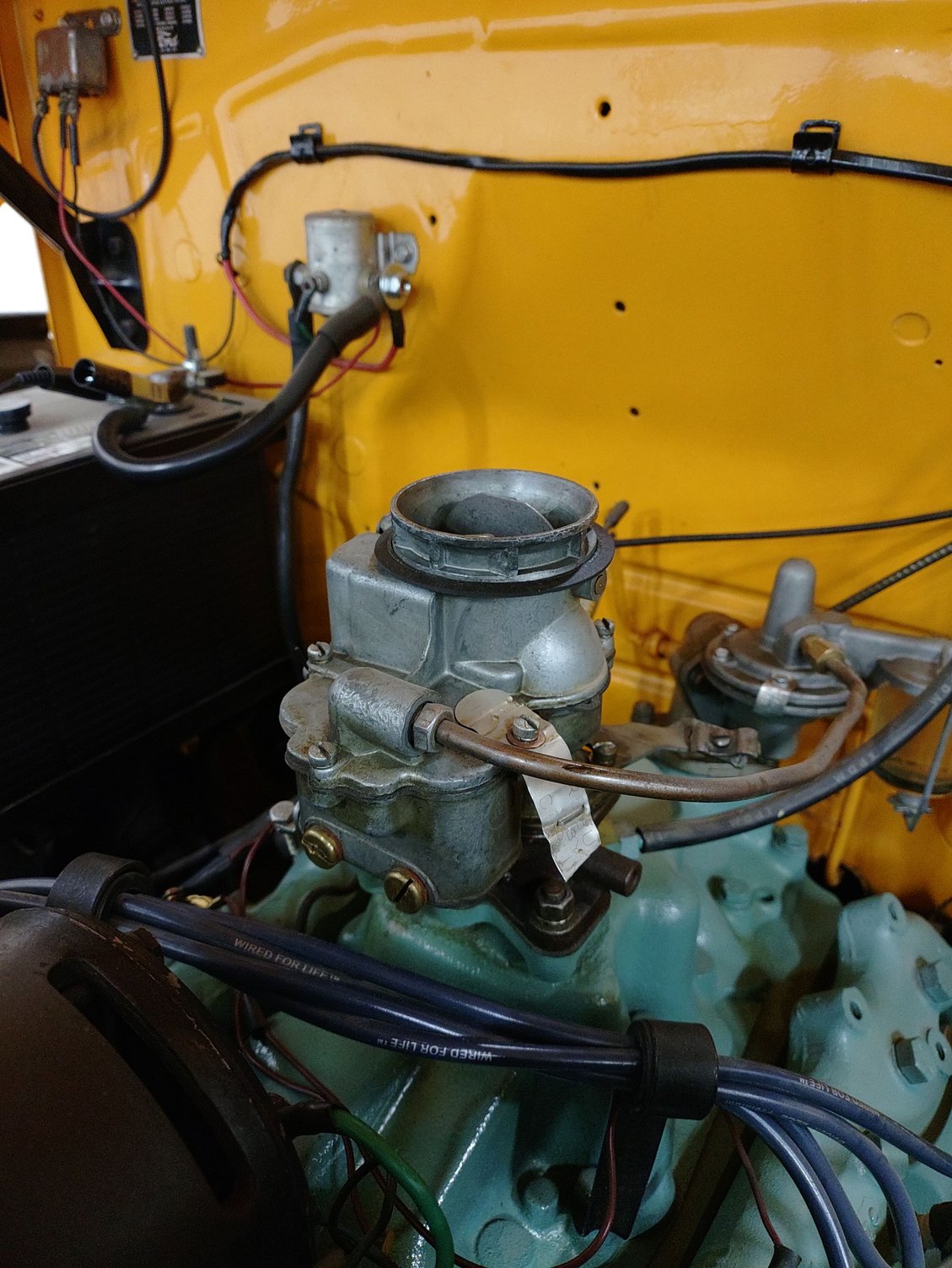

Could I get some help identifying this carburetor and a good place to purchase a gasket kit from for it? It is a 52 F2 Marmon Harrington

Looks like a hodgepodge EBV, EBA, or similar carburetor. You should have a 7RT or 8RT carburetor for the flathead V8.
Cowboy John is a forum favorite. The Carburetor Shop in Eldon, Missouri is another that was recently well reviewed https://www.thecarburetorshop.com/

I've had very good experience with the Car King in MO. He knows carburetors and will talk to you about what you have and give some really good advice. If you want to rebuild it yourself this is the place to go. I've bought kits from Rock Auto and other well know places and all they sell are glorified gasket kits. I just rebuilt the carb in my '49 F-2 and the kit included everything except the float, which I didn't need but I'm sure he could set you up with a new one.
If you want to find someone to rebuild it for you everyone suggest Cowboy John, they say he's the best.
https://cowboyjohnsautoparts.com/

Does the dash have a throttle ****? You have the brocket for the hand throttle cable, but not the extended shaft for the hand throttle linkage.
I am a fellow MH owner. I have a 52 R32-4, that is currently in pieces for a total restoration.

8RT Ford truck carburetor with hand throttle

Just noticed in the picture of the original post the carb had a air horn that looked like a car, it didn't have the <=> like the truck shown in the above picture.

There are more many differences aside from the air cleaner mount, some external, others internal.

I missed that, but did see in a previous post about this express, it has a car air cleaner.

It has a choke **** on the dash, foot pedal for the throttle.

As stated before, the 7RT or 8RT is the correct carburetor. The big difference between the two is if you need ball or cable controls.
I am not excited about a hodgepodge EBV or EBA carburetor as it shows indications of being an undocumented Frankenstein that could be a world of frustrations. Getting back to the proper carburetor with a good foundation would be my suggestion instead of possibly pulling your hair out over this enigma.
