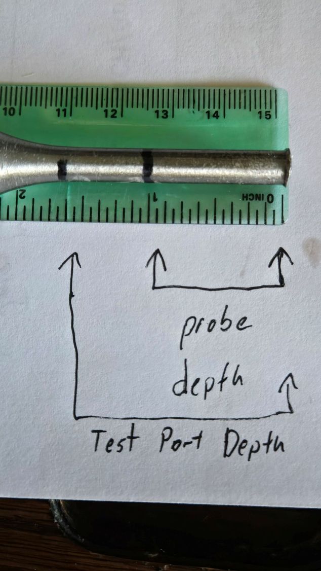

Received and installed the correct kit. For me, the Autometer "long" sending unit: 2252 (in the 8457 kit), worked with no issues. I used a straight punch of the same diameter as the probe on the sending unit to check the clearance depth of the test port. Even when bottomed out, the sending unit still has 1/2" of clearance. I have no idea if there's moving parts in that area, but just parked, I had plenty of clearance. I've read several posts that say you need the short sending unit, and everyone has heard that some guy somewhere broke the long one, but I wasn't able to find any first hand accounts of failures but did find several that said that the 2252 worked for them. Mine could self-destruct tomorrow, but for now it works. If it does fail, I'll definitely come back on here and update this post.

There are no parts in that port, moving or stationary.

Thanks! From the few diagrams I found, it looked like there was nothing behind the test port, thanks for verifying! Below are the depths of the probe and where the punch bottomed out in the test port.

Oh, there's lots of room in there.
