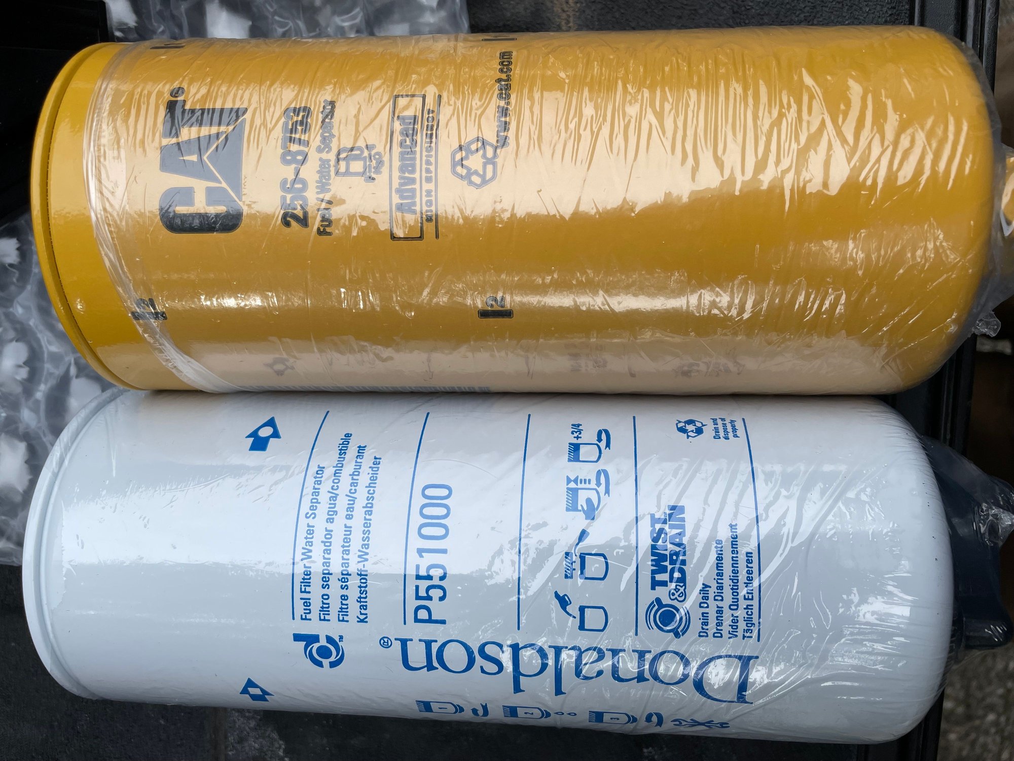

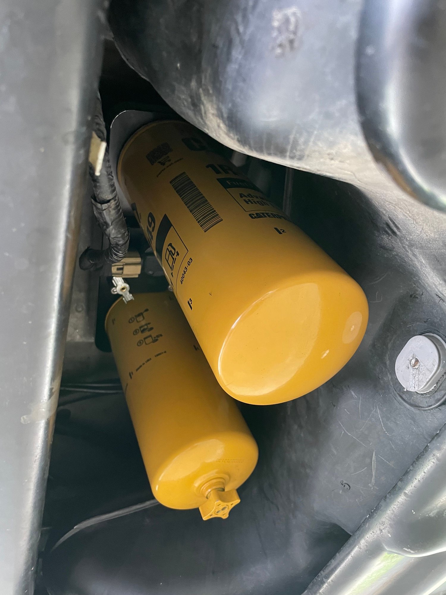

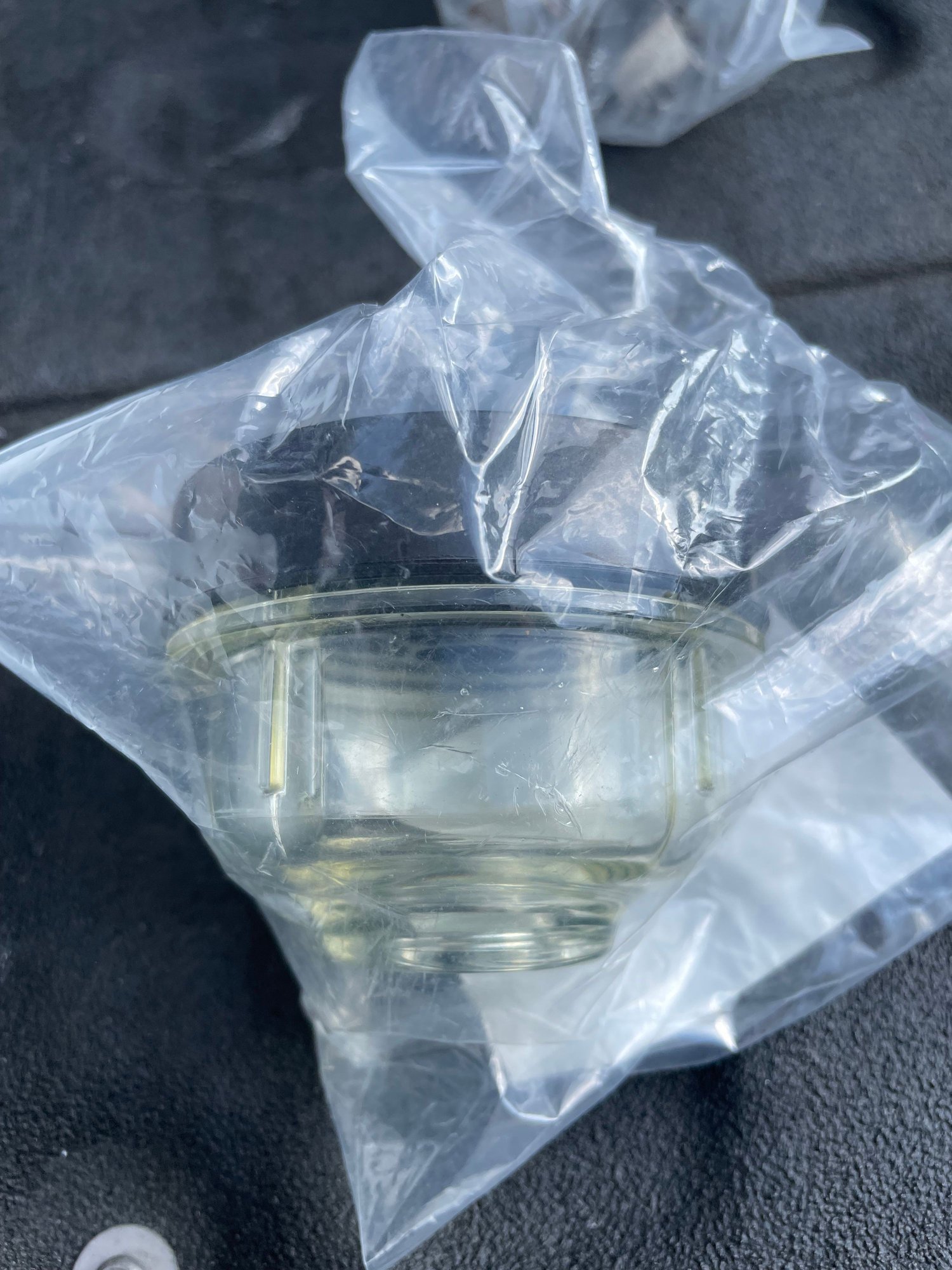

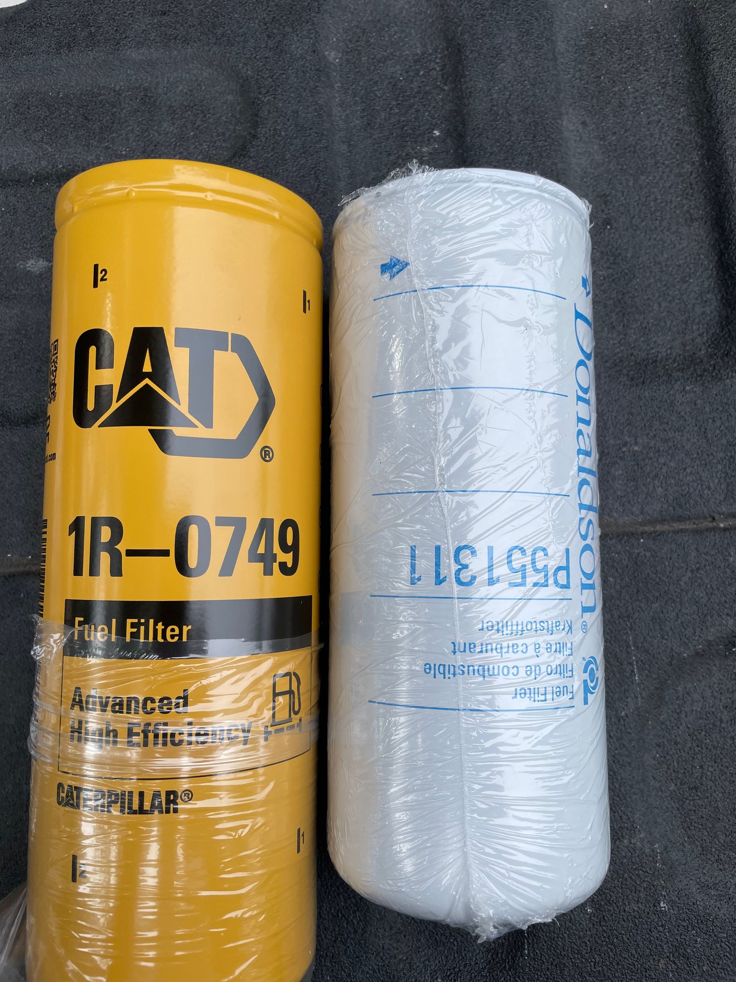

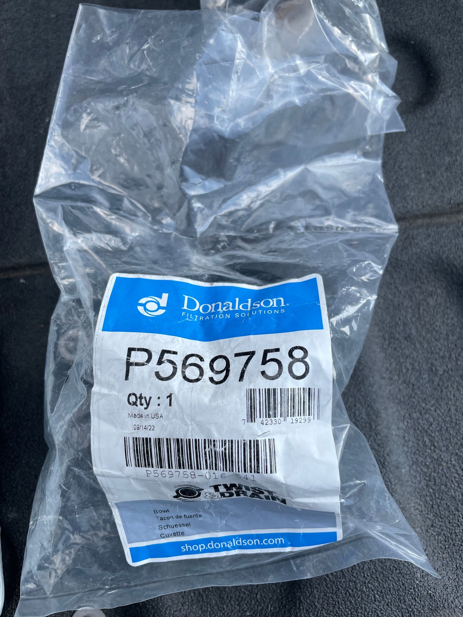

I ran the CAT filters ( Fuel: 1R-0749 and WS: 256-8753 ) that came with the kit for the first 10K. Opened the filters no rust or contaminates found. Then changed over to the Donaldson Filters ( Fuel: P551311 and WS: P551000 ). If I remember correctly the Donaldson's filter better or equal to the Cat Filters. The Donaldson filter you can place a clear fuel bowl ( P569758 ) on the bottom and see any water in the filter. Easy to do a visual before driving. I run this system on my 450. Filters are wrapped by my fuel tank and frame rail.
Jared if you want a shorter Fuel Filter here you go:
  • The 1R-0749 is 10.75" tall and has an outside diameter of 3.75".
  • The 1R-0750 is 7.50" tall and has an outside diameter of 3.38".
