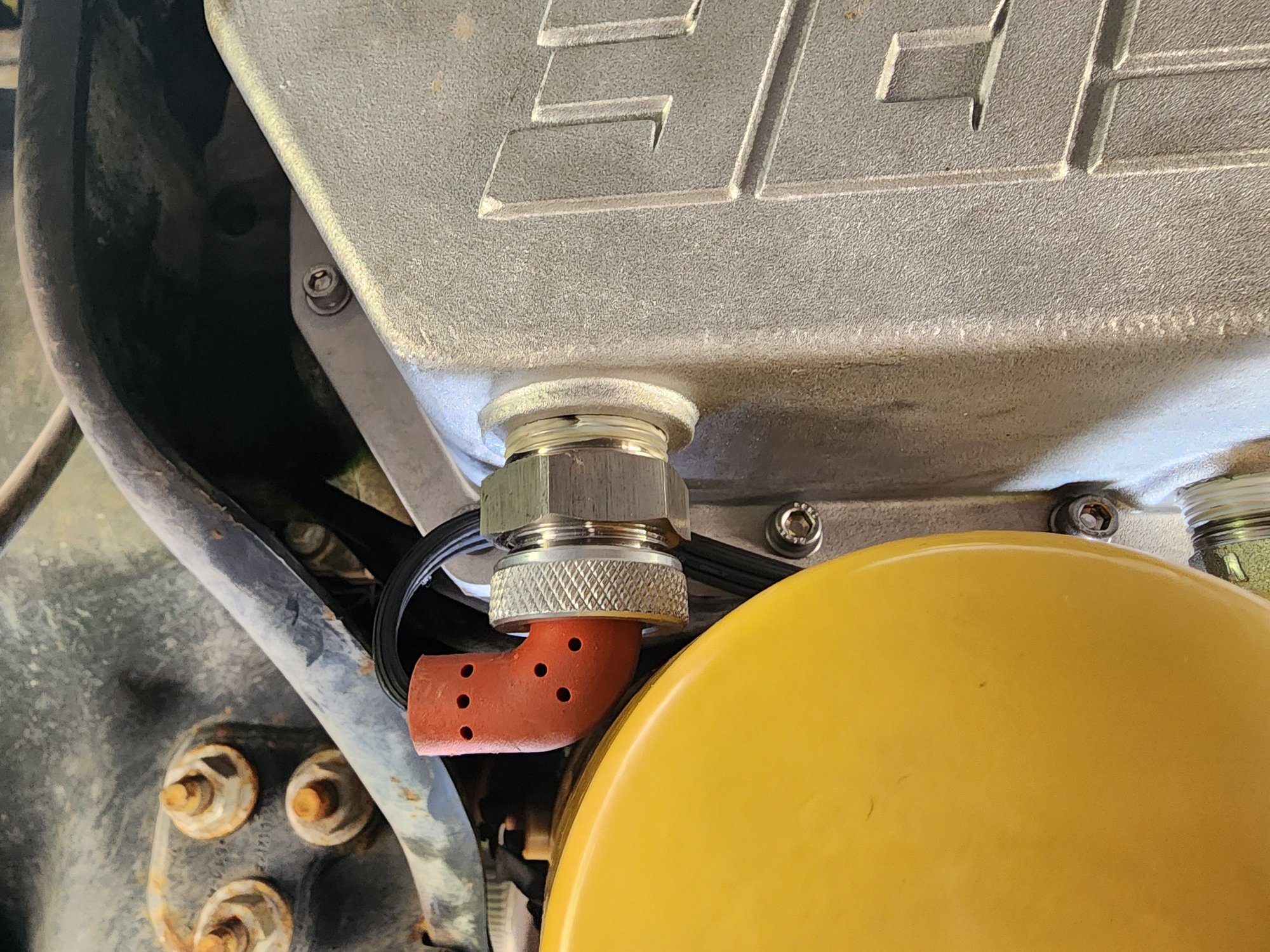

The new oil pan offered multiple advantages. Inceased capacity, more oil equals less work it has to do, therefore longer life. The pan came with two threaded ports, one for the heater, and I used the other as the return port for the bypass filter. And last but not least, the drain design allows for total evacuation of the used oil. When I removed the factory pan more oil was left that I would have ever thought, ~10-12 ounces.

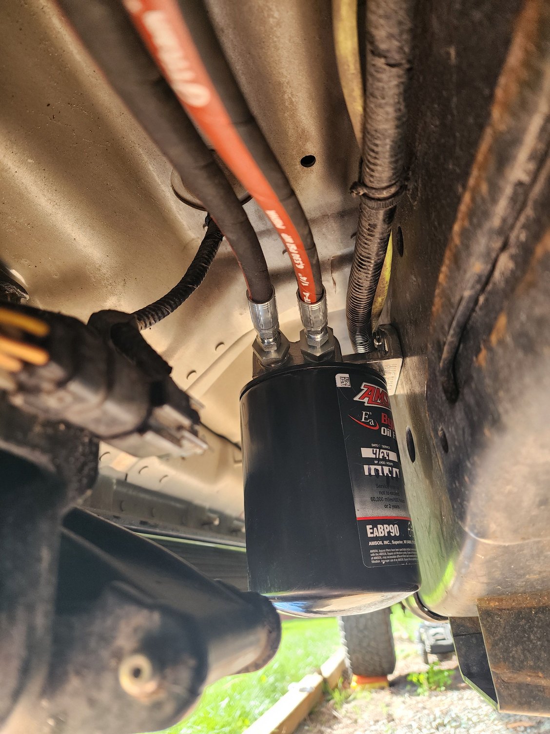

Marketed bypass filter setups are way over-priced, IMO. Liked the thought of maximum filtration but the entry price....way to high. I ended up spending ~$100 on parts and $45 on the filter, this I can live with. Used the amsoil bypass filter, as other sellers do not offer anything close to their receipe. Your basic choice is a toilet paper filter can or the amsoil. As I run amsoil oil anyway, the 2 micron spin on filter fit the bill. Couple of hydraulic hoses, fittings, and a filter base and we're in business. At ~$150 the ROI argument really goes away.

The new engine block oil filter adaptor has extra ports, used the 1/4" NPT one for the supply to bypass filter. The oil pan has a 1/2" threaded port that I used for the return. Mounted the filter base on outside passenger frame rail.

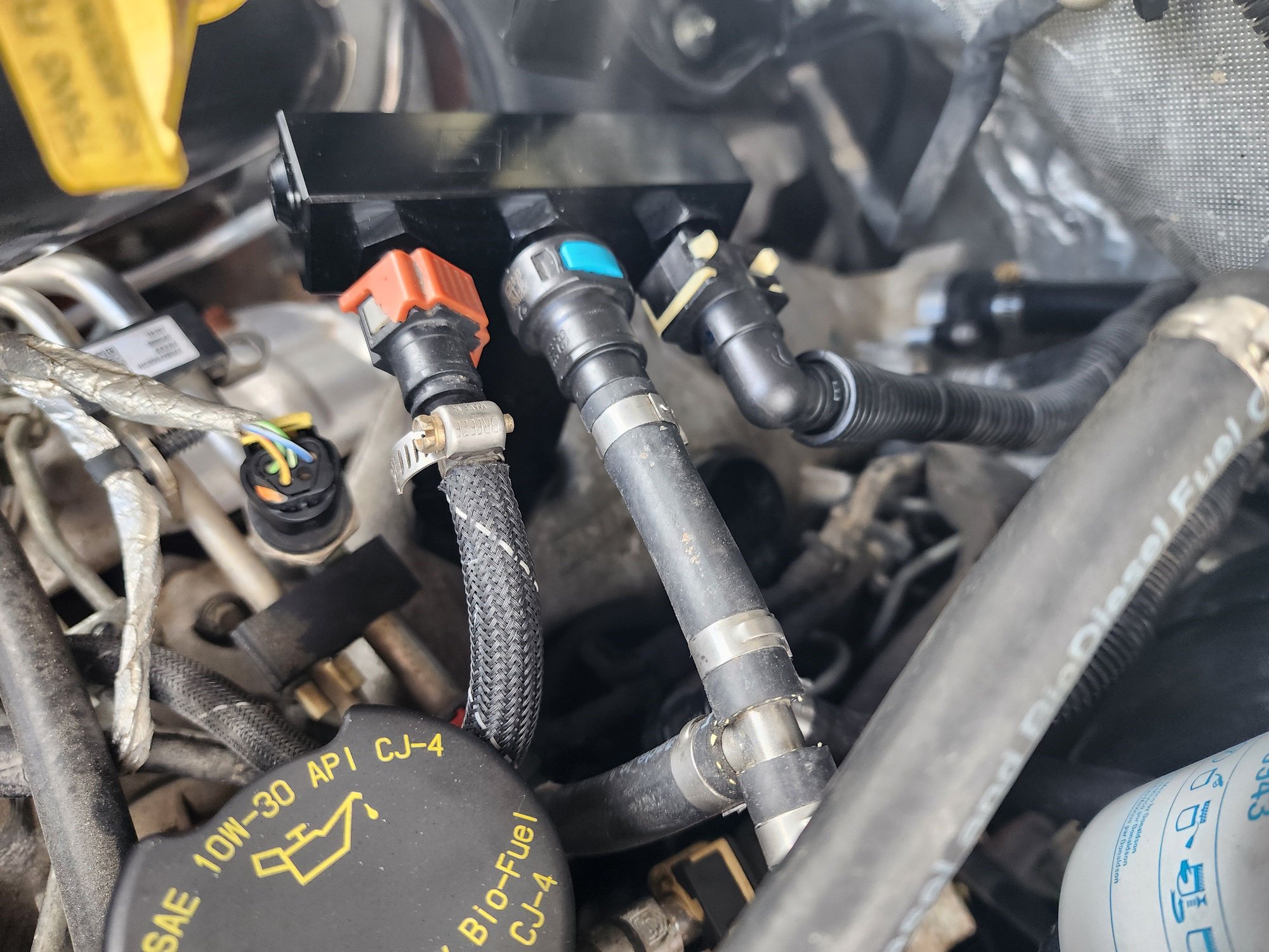

Pic of new main tank water seperator and fuel filter setup. The filter on top of engine is replaced with a manifold.
The oil heater fitment is tight, the connector has to be pointed toward front of truck, but it does fit. About 1/8" clearance.
