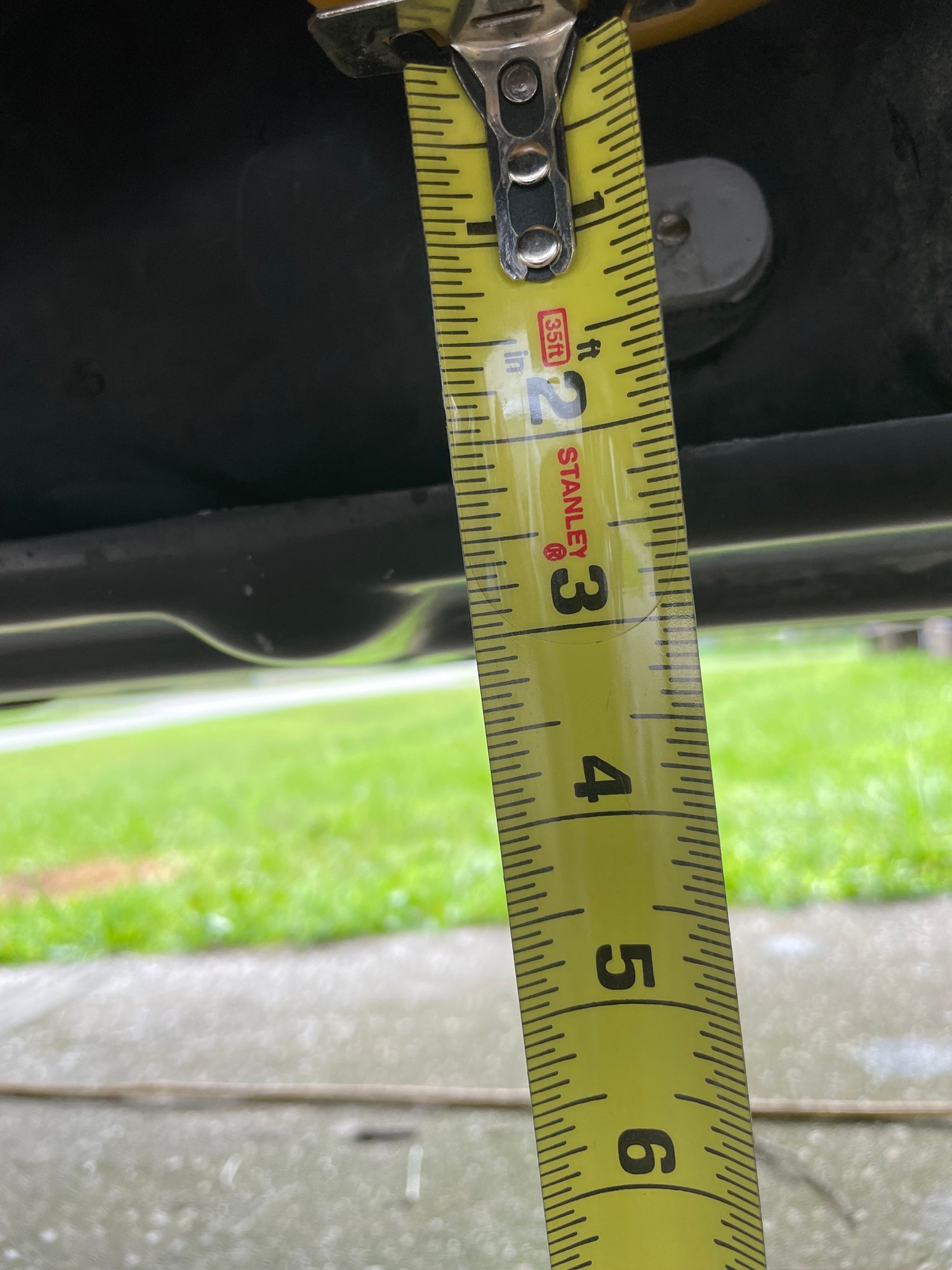

I have a 2017 F450. With the CAT Filters I was about three inches from the bottom of my skid plate. This was with the Big Cat Filters. Even with the Donaldson filters and fuel bowl I'm three inches.
Those pictures you posted seem a bit odd. I didn't think that the CAT 1R-0749 sat that low. This is the lowest I ever seen that filter sit. Normally about three inches short of the skid plate.
