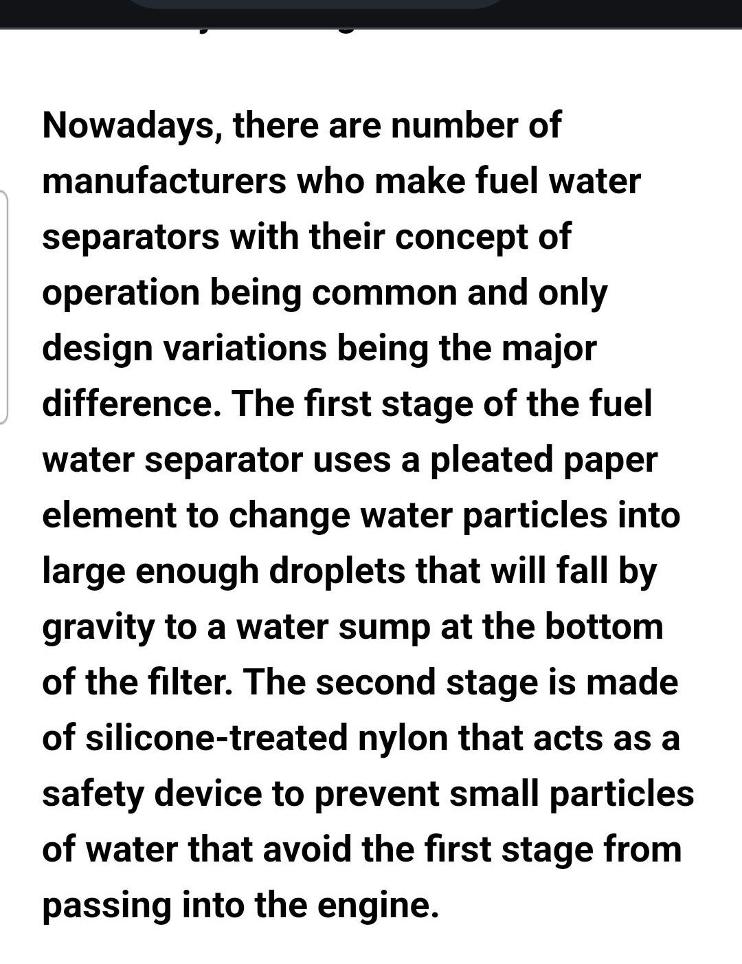

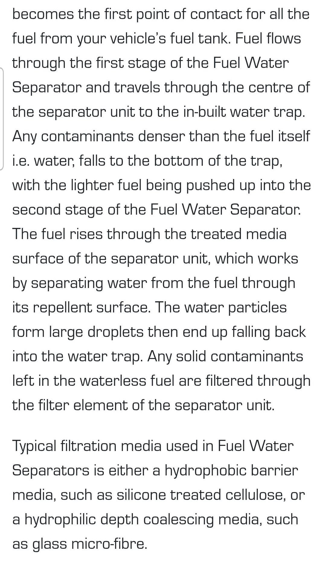

Originally Posted by speakerfritz
I was going to post a pro about aftermarket systems but held off…but since you brought up a water concern….since the oem systems have inferior water removal…as evident by the failed fuel pumps that are attributed to water damage…your concern is valid.
I left my stock filters in place and instead added a 1-14 filter manifold and have a Baldwin filter installed between the stock filters..on more than one occasion I drained water out of the add in filter and no water was in the ford stock filters….so proof to me that the stock filter doesn’t remove water very well. I think part of the reason why is becuase the stock ford filter is a pleaded element that is chemically treated to trap water….i think fuel additives break down the chemical treatment. Aftermarket filters are spun fiber media not relying on chemical treatments.
I would think fuel water separators have a layer of material, like my Motorcraft factory primary filter insert does... so i looked into it and it seems they do.
One article stated that diesel fuel water separators are coarse filters and are part of a filter system.
From this article:
https://www.auroragenerators.com/pos...separator-work
I'll continue to look into this.
https://rycofilters.com.au/articles/fuel-water-separators
