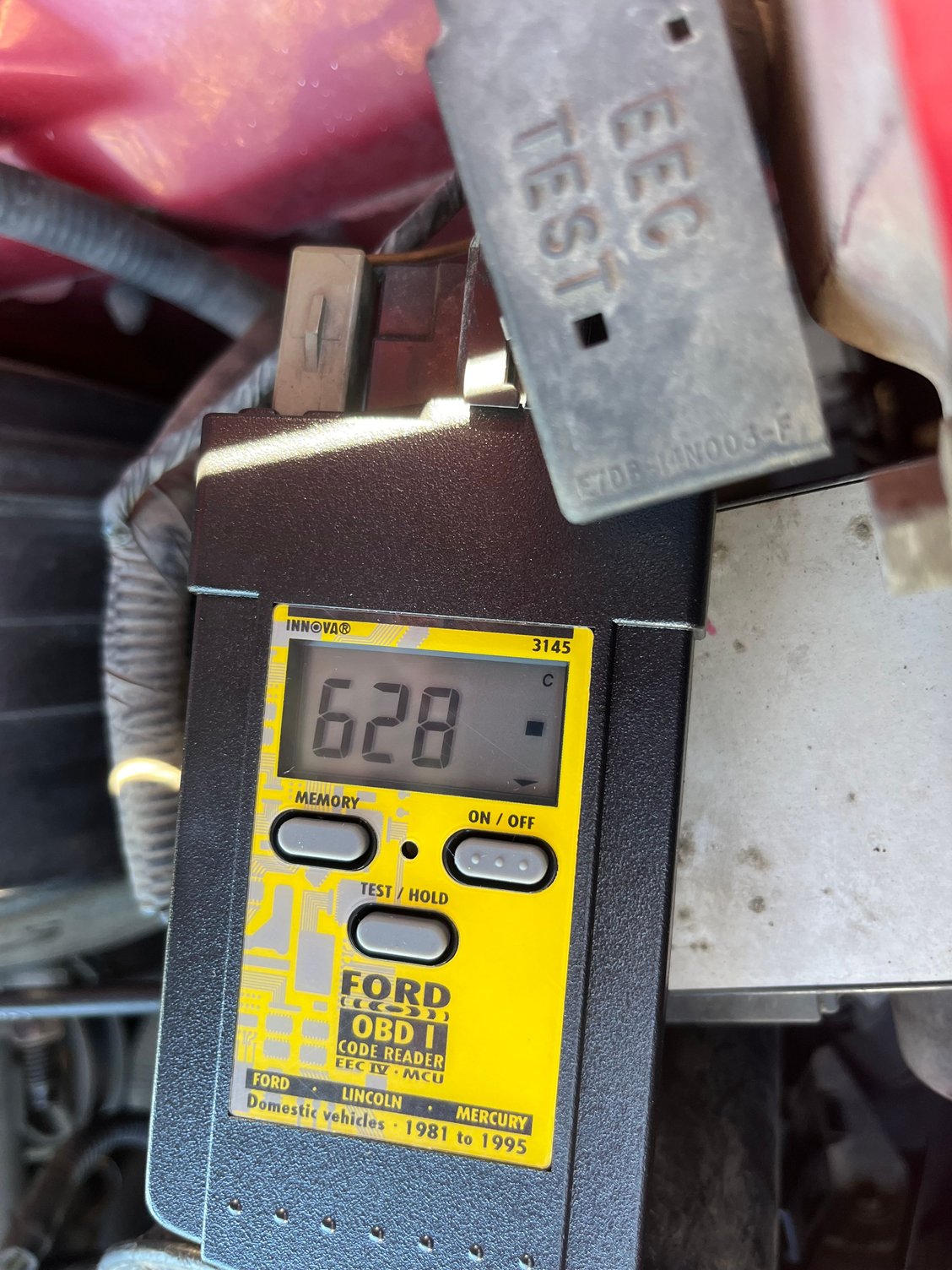

Recently bought a 1994 Ford F250 XLT RWD 7.5 L 460
83,000 Miles Original
Recently has started to randomly shift Chunky between 1st and 2nd
and Chunks from P to D and P to R
If i unplug the battery and reset the memory, it shifts good for a couple days then goes back to the random chunks
bought a code reader and it spit out Code 628
Torque Slippage
does not look like Transmission Pan has ever come off this thing. Fluid smells slightly burnt, but not overly
Should i start with a full transmission fluid flush?
Or think its Torque Convertor?
Or simply a sensor?
if anyone has had this happen to their Truck…
looking for suggestions before i start with the Flush!
thank you so much

That code is pretty reliable. When the trans is in fourth gear, and the converter is commanded to be locked, it calculates from vehicle speed back to engine speed. If the engine speed is more than 50 RPM higher than the calculated value, code 628 i set.
Those years E4OD had a torque converter problem. The converter clutch apply piston often developed a crack. This allows apply pressure to bleed off, and the clutch slips, and code 628 sets. I thihn you need a new torque converter.
